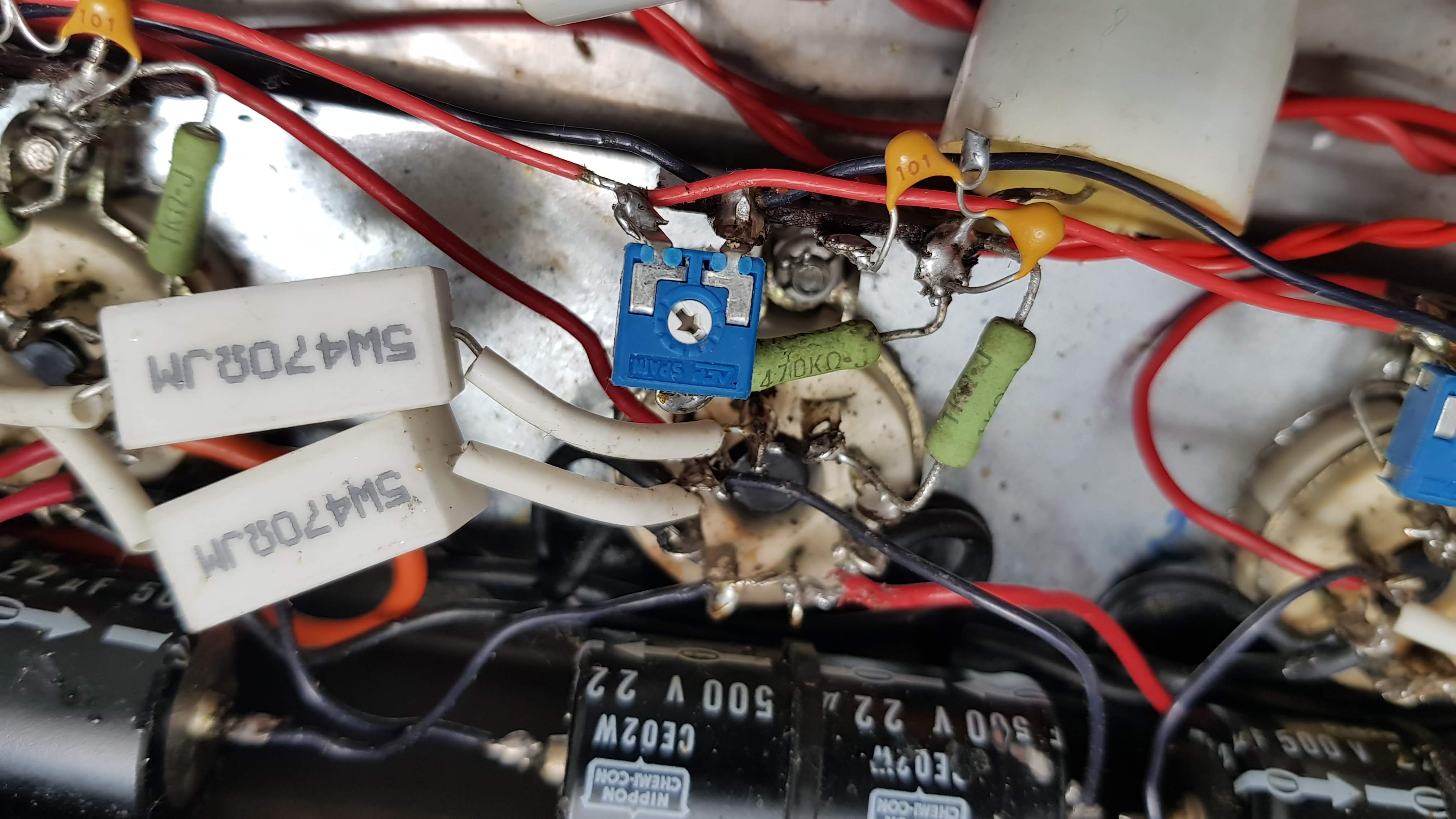

Hi Easyrider82, I was about to ask the same question. Mine is working fine after a recap, and I left the bias unchanged. It is currently 39v. However I'd like to measure the current through the tubes, and add a current sense resistor somewhere. Presumably a 10ohm resistor would not hurt between the cathode and cathode winding in the OPT? Or is there a better approach?
What are the hazards that are brought by that arrangement? I was a bit concerned to be adding 20ohms resistance on the cathode winding, so am gravitating towards 1ohm resistors.

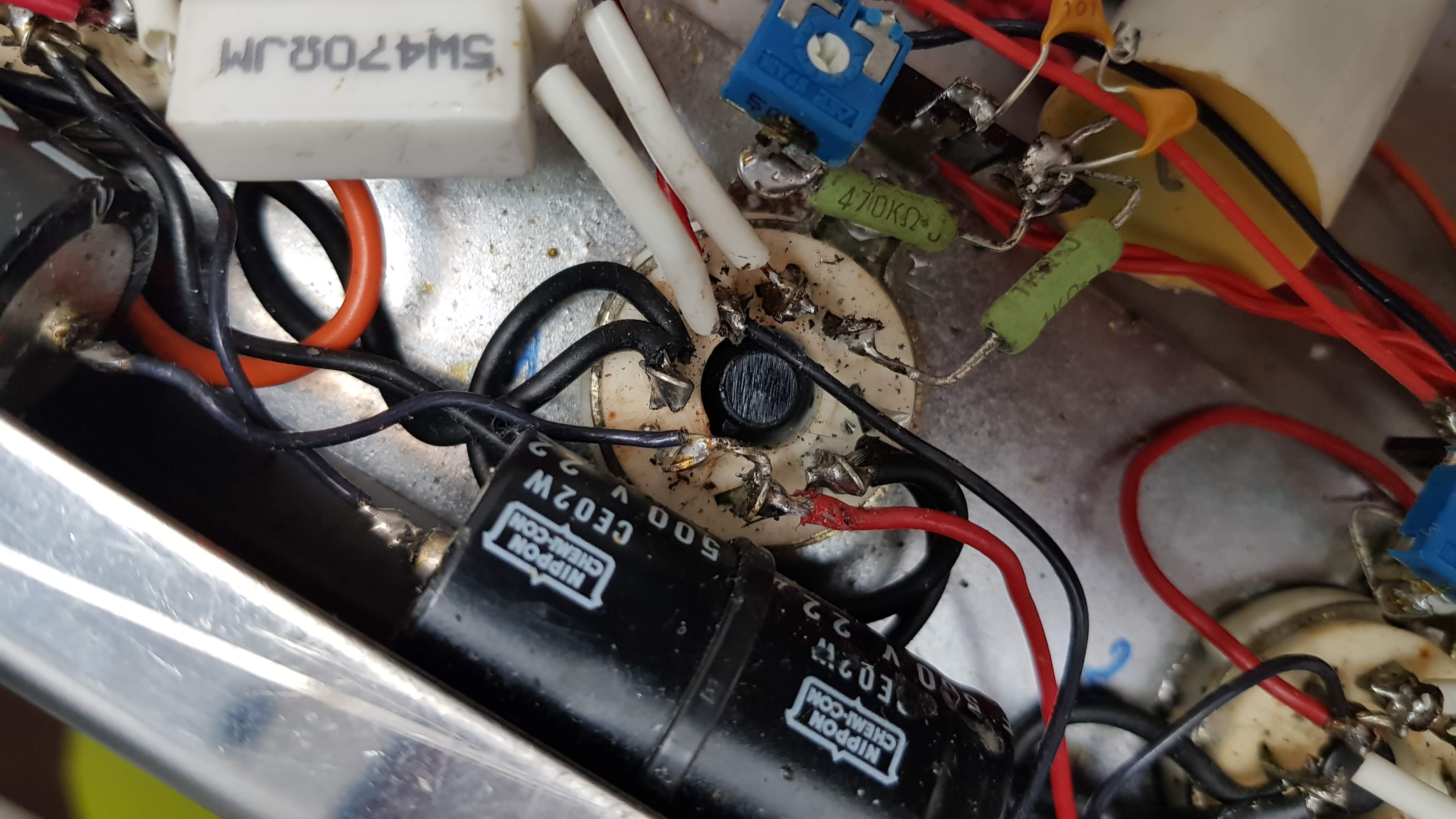

HI OldHector,
i'm sorry but i have no idea where to measure the bias voltage/current. my amp has been modified from the previous owner (replaced rotten pcb with air cabling and added single potentiometers for every EL34 to regulate bias, other than some recap).
The circuit should be identical to the old one (can't verify by myslef).
Would you kindly please help checking the correct bias value here?
Despite of the mess you can see, it sunds really good!
I'll post a few pics of the actual situation.
Thank you in advance.
