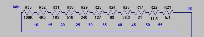

Just for the record: here are the values needed for a 12-positions rotary gain switch, with 5db steps. A 100k or so in parallel might be a good idea to avoid random behavior in between steps if using a non-shorting switch. Resistors values were calculated with r2 as 10r.
attachment.php
