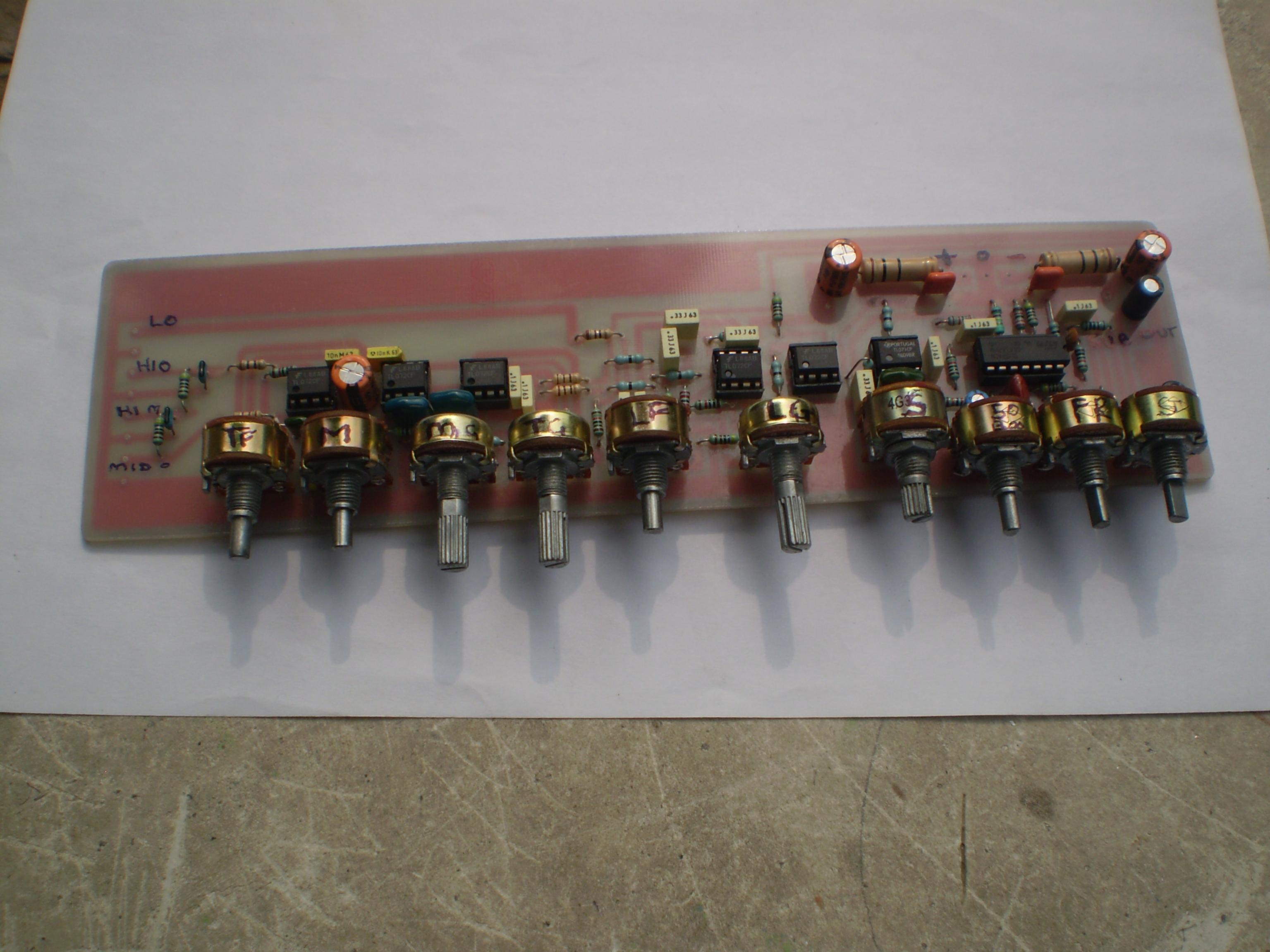

APEX do you have a 2 band tone control made with transistors instead of opamps?
you posted a tone control circuit a long time ago with a tl074 quad operational amplifier).its working good.i attach a photo of it. do you have the same circuit with pcb but with 2 opamps? i have 2 opa2134 (dual operational amplifiers) and i want to use them.
I must check in my old projects, and I will share if I find some interesting schematics.

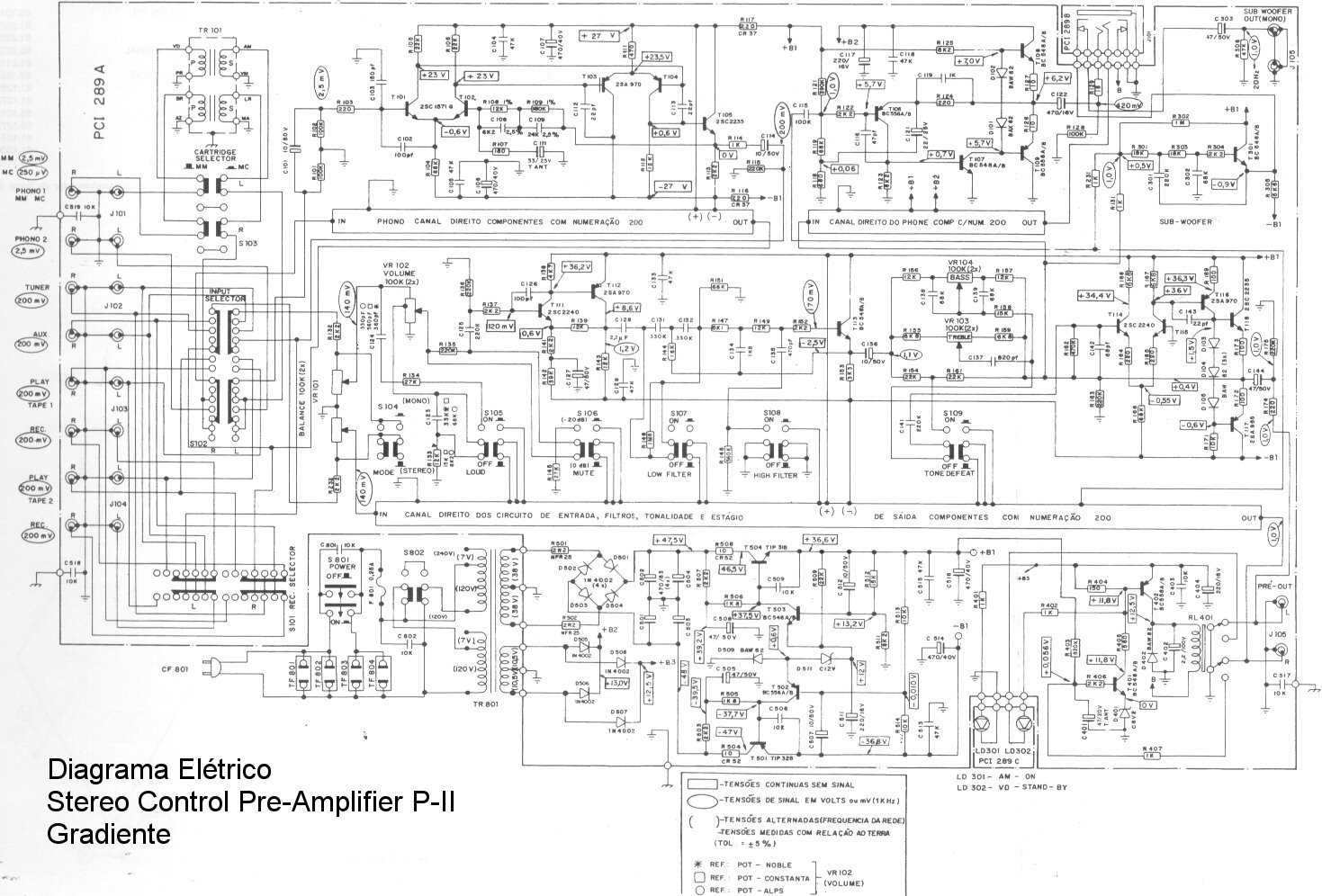

Gradiente P-II
Excuse me, let me share schematics for the one I have at home.
Max.

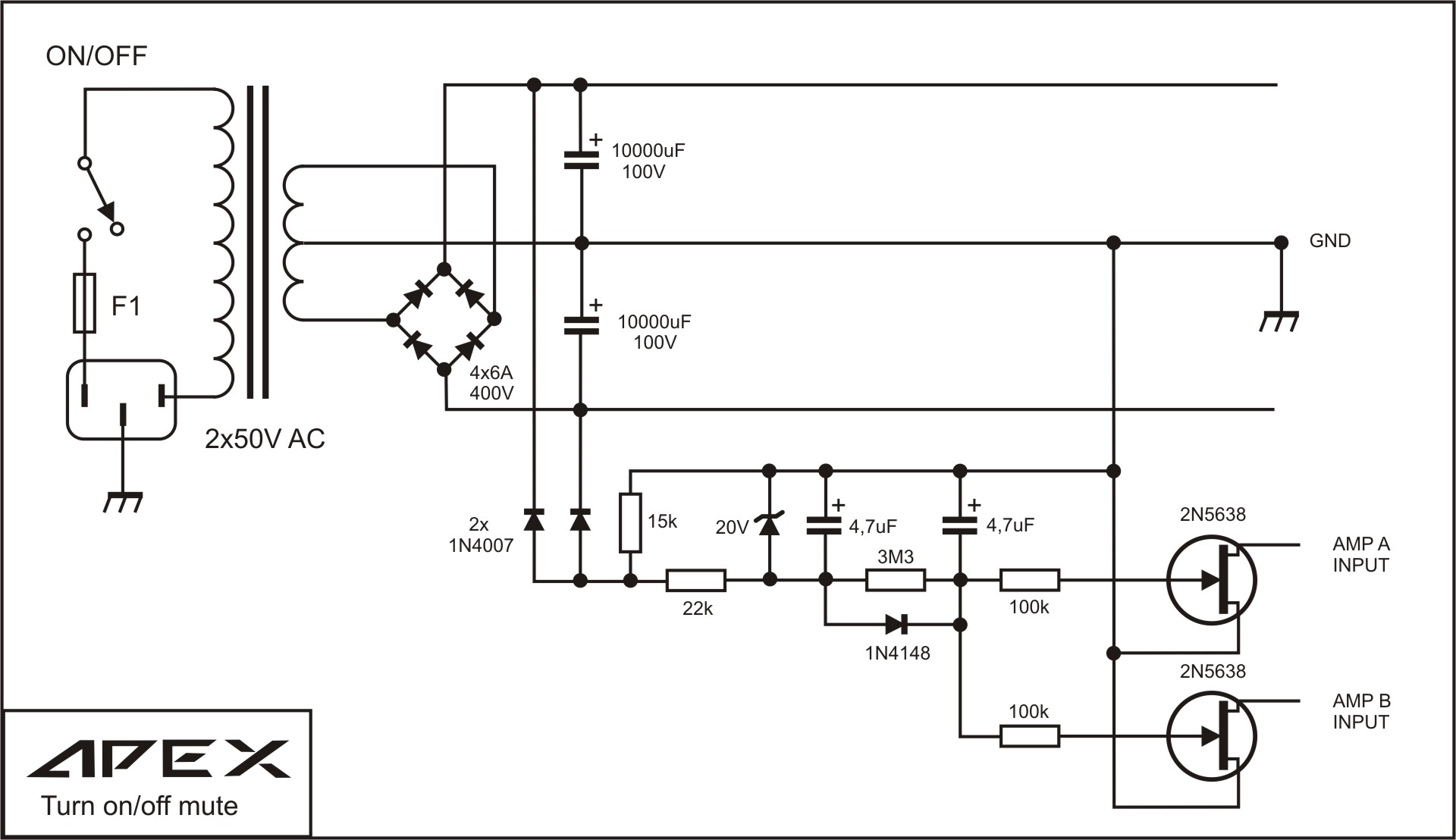

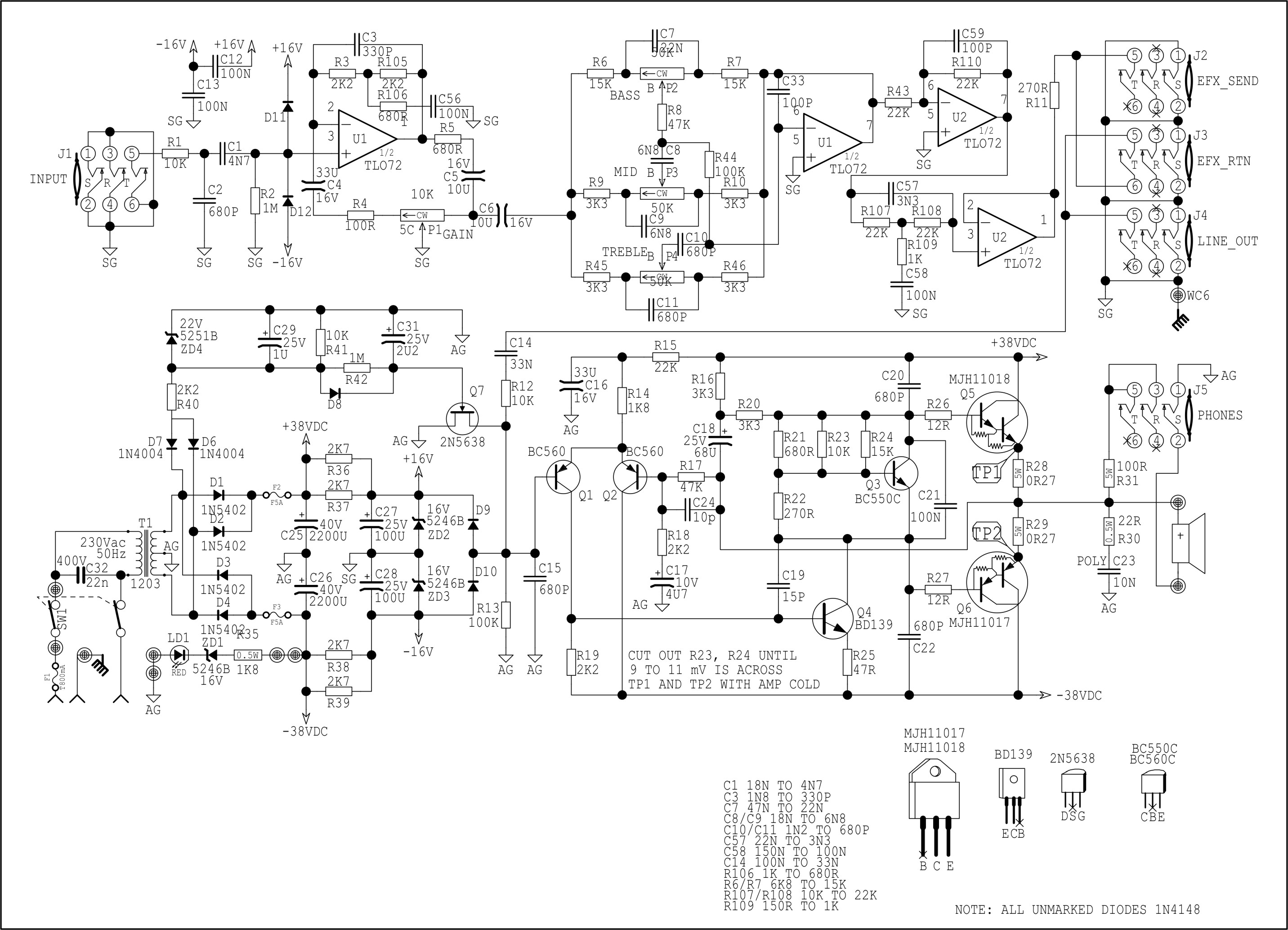

Are you sure those 1N4007 are connected to the right place?
Shouldn't they be attached BEFORE the bridge?
Sorry, I didn't test this circuit, but I am trying to understand its behavior.
Thanks.
Max.
You have right 1N4007 must be connect to AC before bridge.
