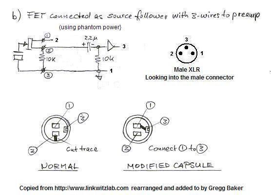

So I've built a binaural dummy-head mic featuring the Panasonic WM61a capsules. The problem is that the mic capsules seem to be distorting, apparently caused by upper-mid frequencies. Here's a very short demo showing what I mean.
I performed the linkwitz mod on the capsules as the idea is to use the head at gigs, and built a pair of phantom-powered, phase inverting circuits, one for each mic. I used this circuit:
The only difference is that Terminal 3 on the capsule goes to ground as per the advice of Bill Wall.
However, as I said the capsules are distorting easily, at low input settings, with human voices seeming to break up very easily. Both are doing it the same way. So I was wondering if anyone might have any idea what might be going on here? I have another head with the same capsules, unmodified, and that can handle much higher levels than these, even though the Linkwitz mod is meant to raise the SPL.
If anyone's got ANY ideas I'll be incredibly grateful, I'm really not sure what to do here now.
Nate

So I put the multimeter to the thing and:
- With the mic connected, I put the probes across 2 and 3 and it reads 6v.
- I don't know if this is of note, and I'm probably betraying my lack of electronic knowledge, but with the microphone disconnected, it reads 46v across 2 and 3.
Scott, my understanding was that the Linkwitz mod makes 2 hot, so I thought I'd connected this properly. Bill's advice was to connect it in this way, I'll try reversing them and see what happens.

The 46 volts with the mic disconnected sounds OK as that will be the phantom PSU voltage. With the mic in circuit and drawing its rated current the voltage settles to around the 6v you measure. That to me sounds OK.
Scott is a real expert around here on these kind of FET related problems so well worth trying his suggestions.
Looks like in copying things often there was a switch. In drawing below I see your same images of the cut but if you look closely they went with a simple direct connection to an XLR. The numbers in the little circle are the capsule pins (1 is hot) and the 2 here refered to XLR pin 2.
Note: pin 3 must go to an AC ground. In the original pin 1 was connected to the battery so it did not matter but you must ground pin 3.

Hmm I swapped the connections around on one of the capsules and it seems to have sorted it.. going to solder it up properly this morning and see how it goes. Looking at all the wiring diagrams for the mod I can see what you mean, it does look like I did it back to front!
Is there any chance I'll have damaged the capsule by having it wired back to front?
That seems to have done the trick. I've shouted as loud as I dare, and turned my monitors as loud as they physically go, and can't get it to distort. I'm heading into Trafalgar Square on Saturday, so I'll set it up in the middle of the crowd and do some recording with the H4N.
But I don't think it's premature to say thankyou guys, particuarly Scott obviously. I don't think I'd have found that fault, and may well have ended up rebuilding the entire circuit incorrectly again to try and solve it. So thanks very much.
Very unlikely.
So that has definitely made an enormous difference. It no longer breaks up at speaking levels as it was before. So thanks Scott for helping me fix the capsule issue. However, it seems there was another issue involved which has only now become apparent.

Sorry to bump this but I'm still having some troubles :/
I tested the mics in front of a PA the other day and they held out well, but they still broke up at high volume, and I'm certain we didn't reach the 130db limit these capsules are meant to be able to handle post-Linkwitz.
I've measured the voltage across the capsule while powered, ie. between terminals 1 and 2, and it reads consistently at around 14v. This definitely seems wrong, though I worry I am taking the measurement incorrectly.
If that is the correct way to measure the voltage, what would that reading indicate? That the capsules are receiving too much power? What could be the cause for that in the circuit?

The voltage across the capsule must be within the recommended limits for the particular device.
Refering to your original diagram in post #1 the voltage across the capsule is determined by the 33K and the two 5K6 resistors. If you have used a different capsule to the one the circuit was designed for then the voltages will be different as the capsule will probably have a different current draw.
Altering the 33K will alter the voltage across the capsule. Higher t'ohmage and the lower the volts on the capsule.
