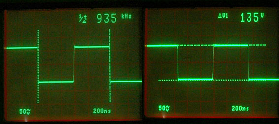

"Maybe you were just unable to implement the proper feedback scheme and you had to resort to a brute force approach like increasing switching frequency?"
i post a mcd-500 squear pwm signal.
working at 135v , 935k , 4ohm load,
"some body cant do it " not meaning "no one can do it "
best rg
fumac
best rg

about 1mhz , we had slow down the frequency to 600k at same board, but after we do hearing test,
we click out the 600k design.
