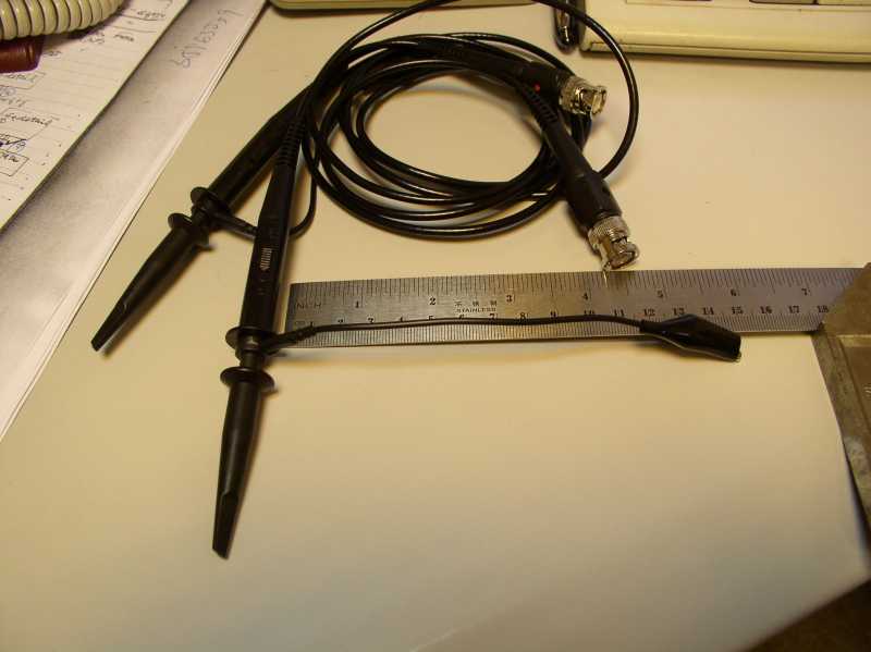

and can you tell me the length of your gan pin
The input voltage for the MCD is bit under voltage. I've ordered a pair of transformer and should be get delivered in a couple of days. I'll do some A/B test with UCD then.
Attached is the probe I'm using. The ground pin is 15cm long.
There is no excuse. Ringing is supposed to be damped in any commercial product.
On the other hand, since your probes look like 1x/10x switchable, and the RF bandwidth in 1x mode is severely compromised, you may want to repeat the measurement at 10x if it wasn't that way the first time.
