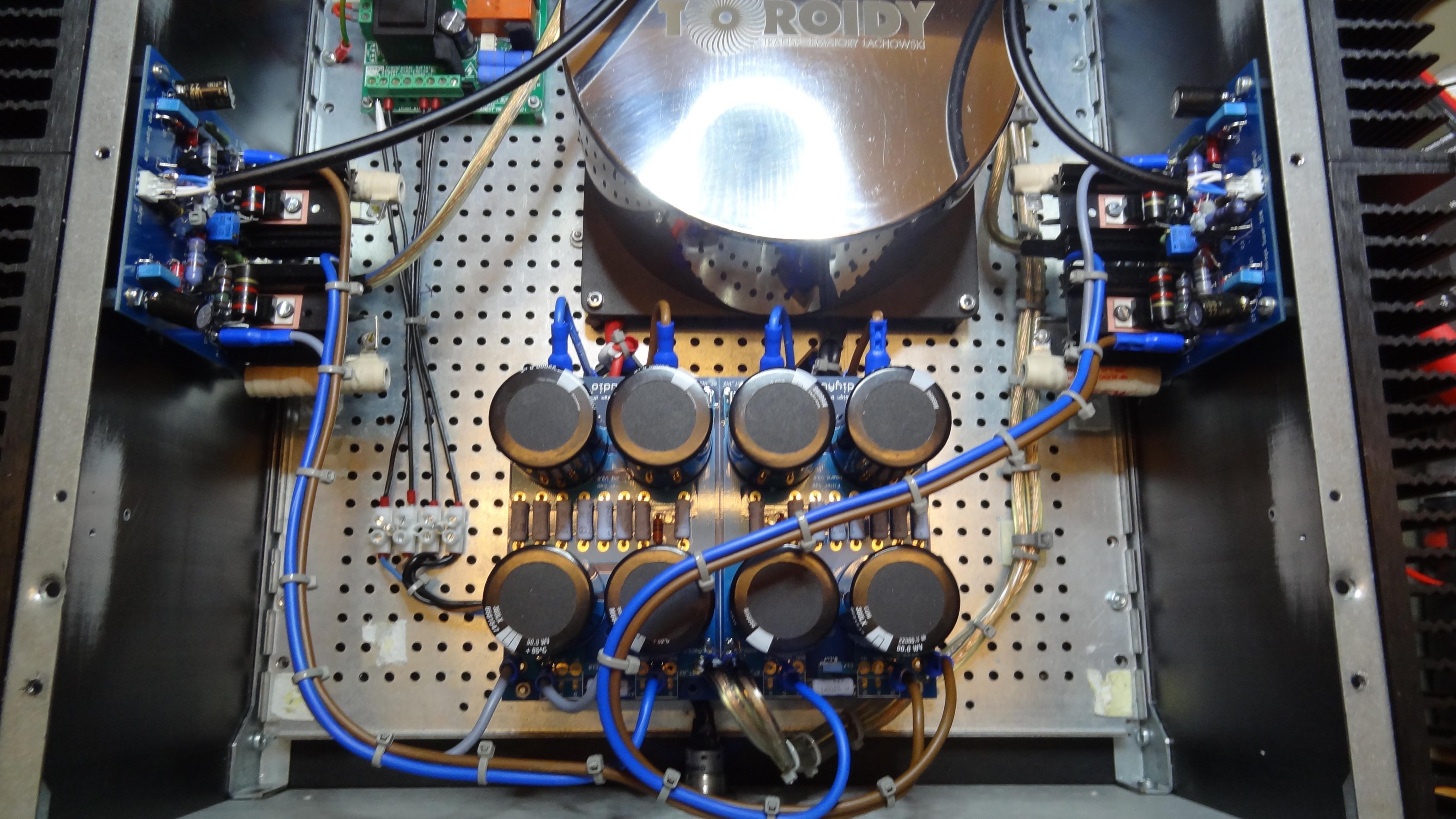

Hi people, I hope someone can help me get on track. It seems the Mezmerize creates a ground loop with my Hiraga amplifier. As soon as I connect the pre to the Hiraga, a hum is present.
There is no offset present on the DCB1, I checked and double checked. So now I'm bald and still hum
Please help? I am thinking about isolating the output of the DCB1 or the input of the Hiraga. But that will probably result in poor sound quality. So any help on the matter is greatly appreciated!

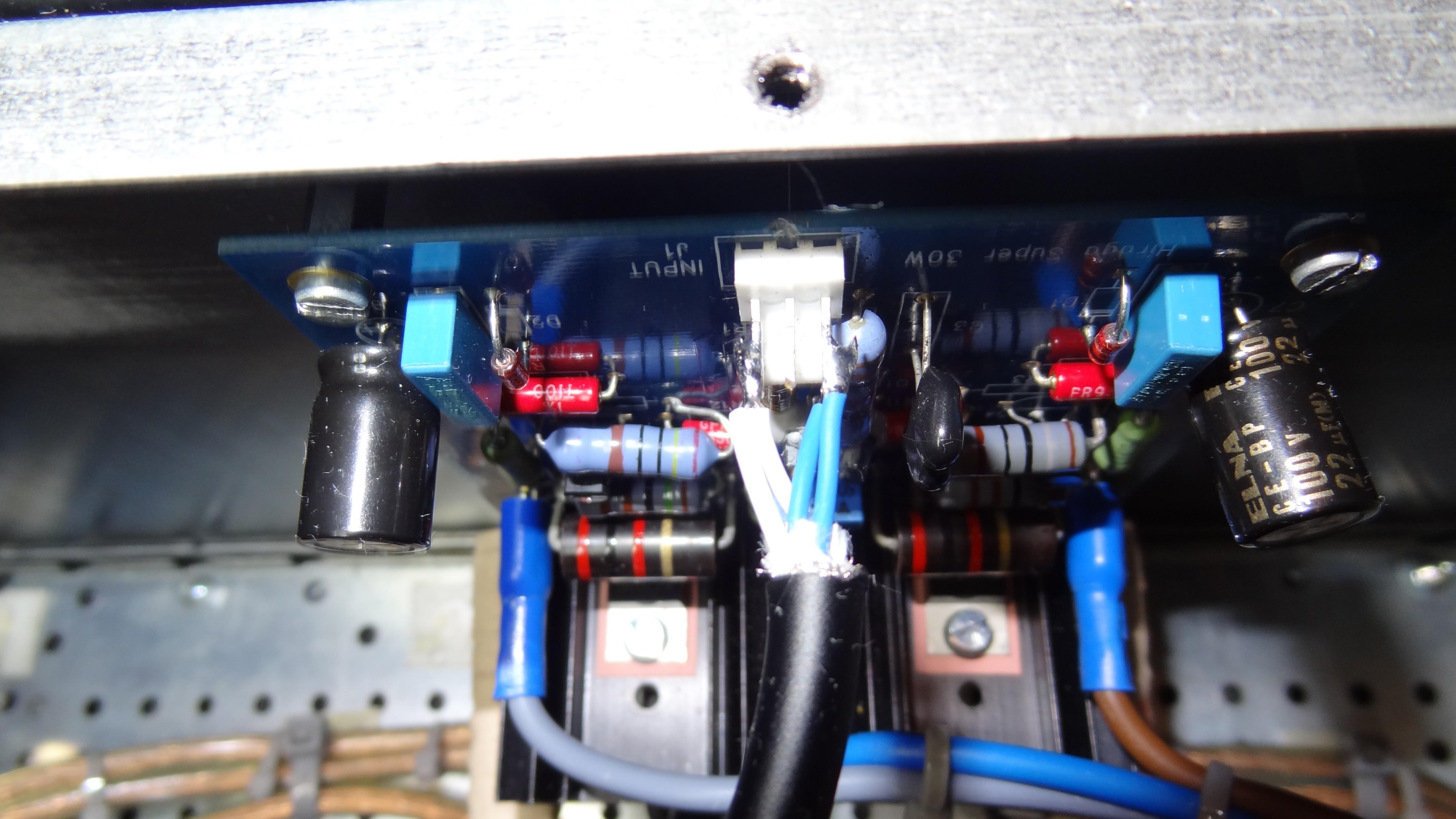

To theoretically inspect a ground loop it takes we first have a detailed drawing of the grounding scheme for both the pre & power builds.
For a quick practical inspection first see if the Hiraga build has chassis grounding that shows continuity to its PCB signal ground also. If when disconnecting its IEC ground the hum loop stops then it needs a safe ground lift with a bridge rectifier.
That's a loop breaker resistor measure many times effective. Its probable that the answer is in the amp's grounding scheme reformation because there are so many Mez builds around mated with so many different amps and its not a buffer that has been reported as hum prone in general. Given that its not malfunctioning of course.

They do not touch the trafo. Just looks like it in the picture.
No hum when no pre is connected.

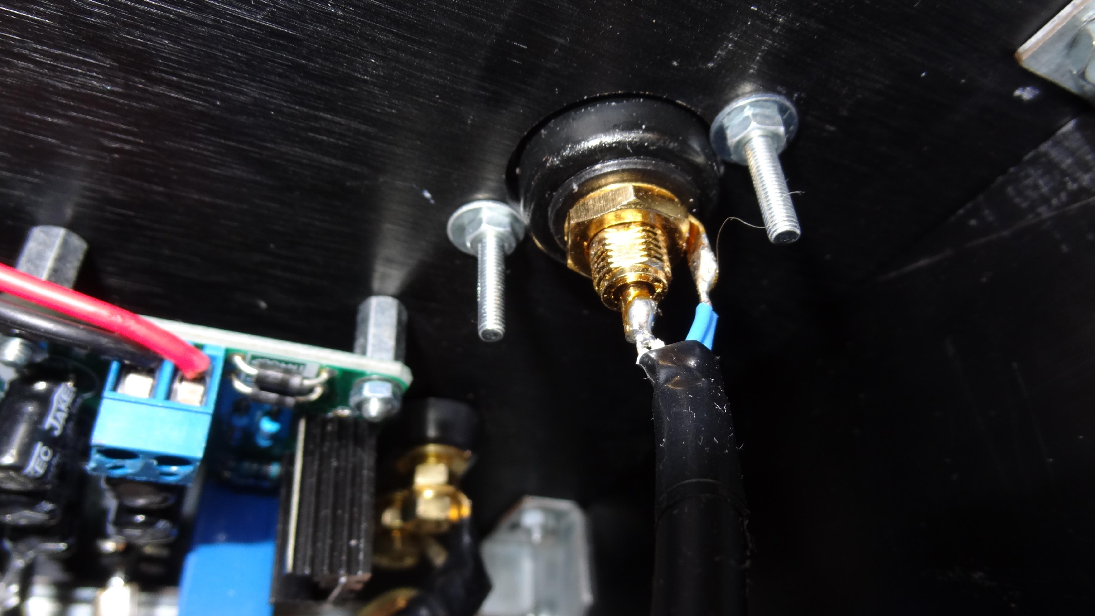

What I I did wrong is not connecting the shield of the signal wiring anywhere.... So the shield has no function now. Thanks for pointing that out.
Things I will do:
-Connect the shield to ground on chassis RCA
-Put 15R resistor on ground in place of the amp boards
-Fix a 1nf ceramic from ground on chassis RCA to chassis, right next to chassis RCA
Let's see what that will do....
