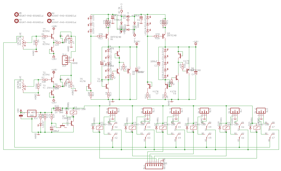

but is there a complete circuit of the Mez somewhere with part designations which relate to the PCB?
The boards have no designations like R1, R2 etc but they have the actual component values and semiconductor types printed. So its tell tale what goes where.

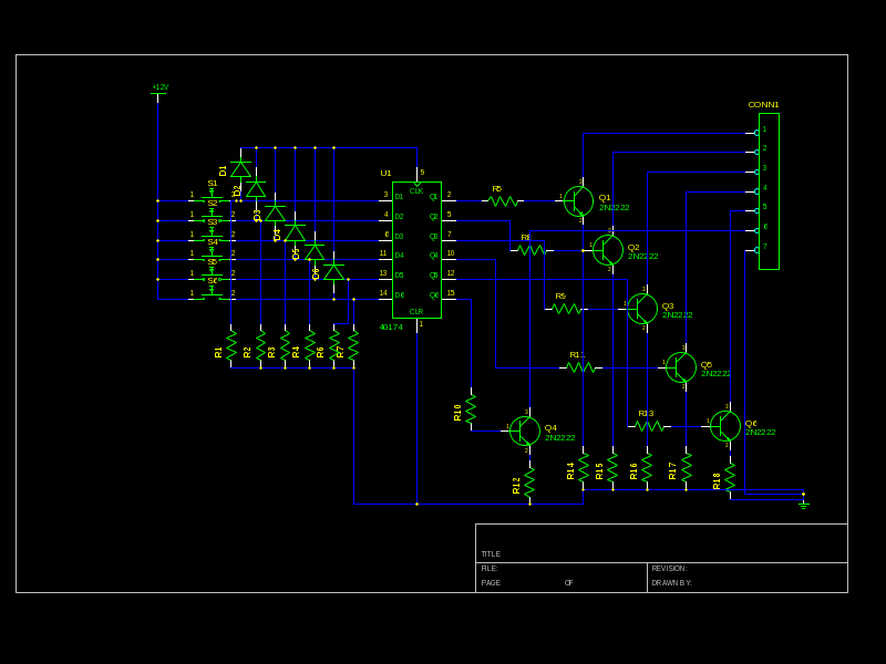

Hi:
Sorry if this is in the wrong place for this post, I can't find a thread dedicated to building the Mesmerize. I am getting ready to build one, but I have an itch to use something other than a rotary switch to activate the input relays. I have always liked momentary-contact pushbuttons a la Quad 34/44 preamps. So, without really knowing what I'm doing I came up with the following circuit. I would appreciate some feed-back, like for example "that won't work" or "that might work" or even "there's a much better way to do that".
First let me apologize for the graphic, I just downloaded the geda schematic editor and this is my first time using it.
The circuit uses a 40174 hex D-type flip-flop. Each switch is connected on one end to a voltage source. (The 4000-series chips can use up to +15V supplies so I am thinking I will just steal some +12V from the regulator on the pre-amp board; alternatively I could add a 5-volt regulator.) When, for example, SW1 is closed it applies a high voltage to input D1, and also to the CLOCK input (through a diode to insulate it from the other inputs). The low->high transition on the CLOCK line causes output Q1 to go high, which drives transistor Q1 through a base resistor. The transistor switches on, and completes the circuit from input 1 on CONN1 (coming from relay coil) to ground through pin7 on CONN1. (Yeah, I know I have an extra ground symbol there.) When another switch is closed, output Q1 will go low and the other output will go high.
One concern I have i that, at least on paper, the chip needs a few nanoseconds of set-up time between a change on the inputs and the transition on the clock line. I figure a small RC circuit on the clock line could introduce a small delay, with maybe a series small-signal diode that wouldn't conduct until the voltage reached Vf. I think it would just need a few pF and a small resistor for the delay (10 or 20 nS should do it).
Does this look like it would work? If so, I also want to include indicator LED's; should they be in series with the relay coils or parallel? I think this could easily be built on a piece of veroboard, perhaps with the switches and LED's on the back to mount to a front panel.
Any and all feedback appreciated.
The power feed to the selector relay comes from the same resistors that feed the mute relay.
If the regulator voltage is selected to match the relay voltage then these resistors are linked across (0r0). It will work fine.
If you use a higher voltage regulator than the relay is rated for, the resistors are used to drop the excess voltage.
If a second relay is brought "ON" it will drop the voltage applied to the "newly" selected relay even further and the newly selected relay might not trigger. The existing mute relay will not drop out due this voltage sag. There is a PCB mod that can overcome this (no details just yet)
This effectively means use 12V reg + 12V relays
or
use 5V reg + 5V relays.
I would stay with the 12V option for everything.
I love the idea of "press the selector button" and the LED confirms the selection. It would be even better if the selected button lit up, (a push to make button with a LED inside).
The LED could replace the emitter resistors R12 to R18, but then the supply voltage would need to be raised by ~2V to either 7V or 14V. This series LED would pass the same current as the relay coil. It will be very bright. Adding a resistor bypass across the LED will adjust the brightness.
If instead the LED is placed in parallel, then it must be in parallel with the relay. That involves 6 extra wires tapping into the PCB.
Neither way is brilliant, but both can be done.
Is there a third way?
Those emitter resistors are not required.
