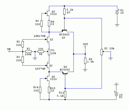

I have in mind to investigate on such a versatile pre. Say having a DCB1 plus a good simple circuit cell with gain on same pcb. A relay to choose which one is employed etc. But a cell with gain that will still resemble the DCB1 when in action is a difficult find. Will see.
Thinking of it (+12dB gain, great sounding and neutral in character, using +/-10V PSU, no coupling caps and designed in compliance with B1/Pass concepts) I came to this idea (in attachment) based on Mr. Pass' proposal from BAF2013. Having LSK/LSJ JFETs available makes this possible.
J310 CCS provides about 20mA each, LSK/LSJ JFETs work at Vds of 7.5V and with Id at about 80% of Idss. P1 enables dynamic matching/distortion profile optimizing and P2 sets the DC offset.
Preamp's max. output is about 7V_peak of clean swing.
Zout is determined by value of R9 and it's not critical (R9/R6 ratio determines the gain of the circuit) since we have a Mesmerize buffer stage next to it.
I think they will work great together. AFAIC, it would be very difficult to find a better sounding gain stage...
