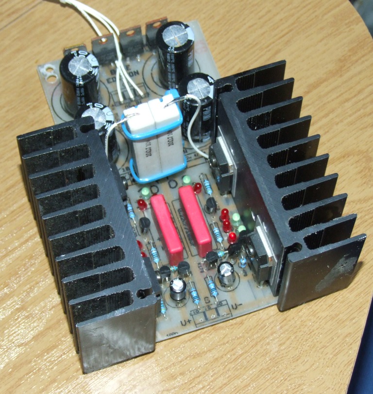

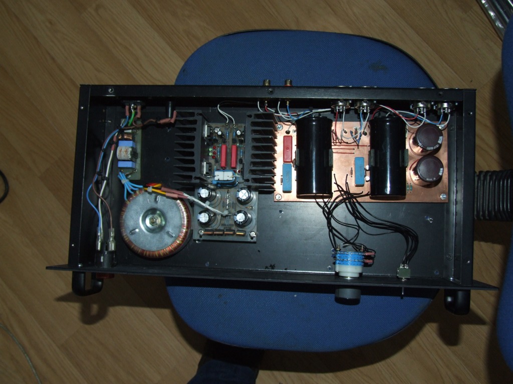

Hi Salas,
I am building the Mesmerize and reading on the thread I decide to make some hotrod. 2 27R 5W as Rset resistor and MUR820.
I just received the trafo from Antek 12-0-12 100W. You think that I can use it or is necessary to change as 15-0-15? I am located in Korea and cost me more in shipment than the trafo himself.
Thanks, Enrico
Enrico: I would just use the 12v transformer that you already have - I don't see any problems at all. My DCB1 is biased with three parallel 20R 5W resistors (total of 6R66) and the same diodes. Total power draw is less than 15w, so I don't see any problems at all with your transformer. Even the smaller 50VA transformer still provides more than enough power for this setup.
