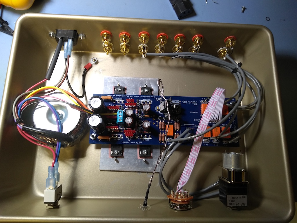

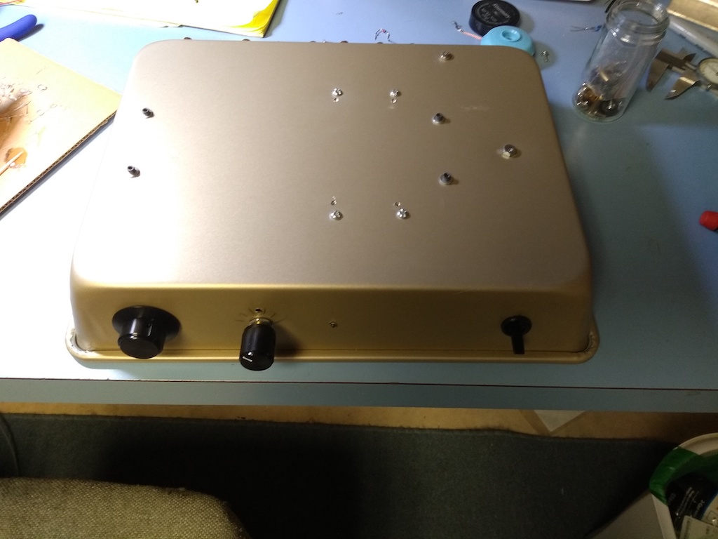

I couldn't wait for a proper enclosure and I thought a cardboard box was probably a bad idea on this one, too many connectors/knobs/heatsinks. I got a cake pan and went at it with a step-bit for all the holes.
I listened to some vinyl last night (w/UFSP as the source) and it seems like a definite improvement over my old Hafler pre.
I appreciate the encouragement - My wife said "is that what you've been working on... is that a cake pan?" good thing is she is use to crazy creations showing up in the livingroom.
I used the matched quad from punkydawg that was ~9ma idss in the audio section and ended up with -1.1mV and -1.0mV DC offset on the output. Overall seems like a great upgrade in my system. Now I just need to get the 6-24 crossover and a pair of F6 built.
