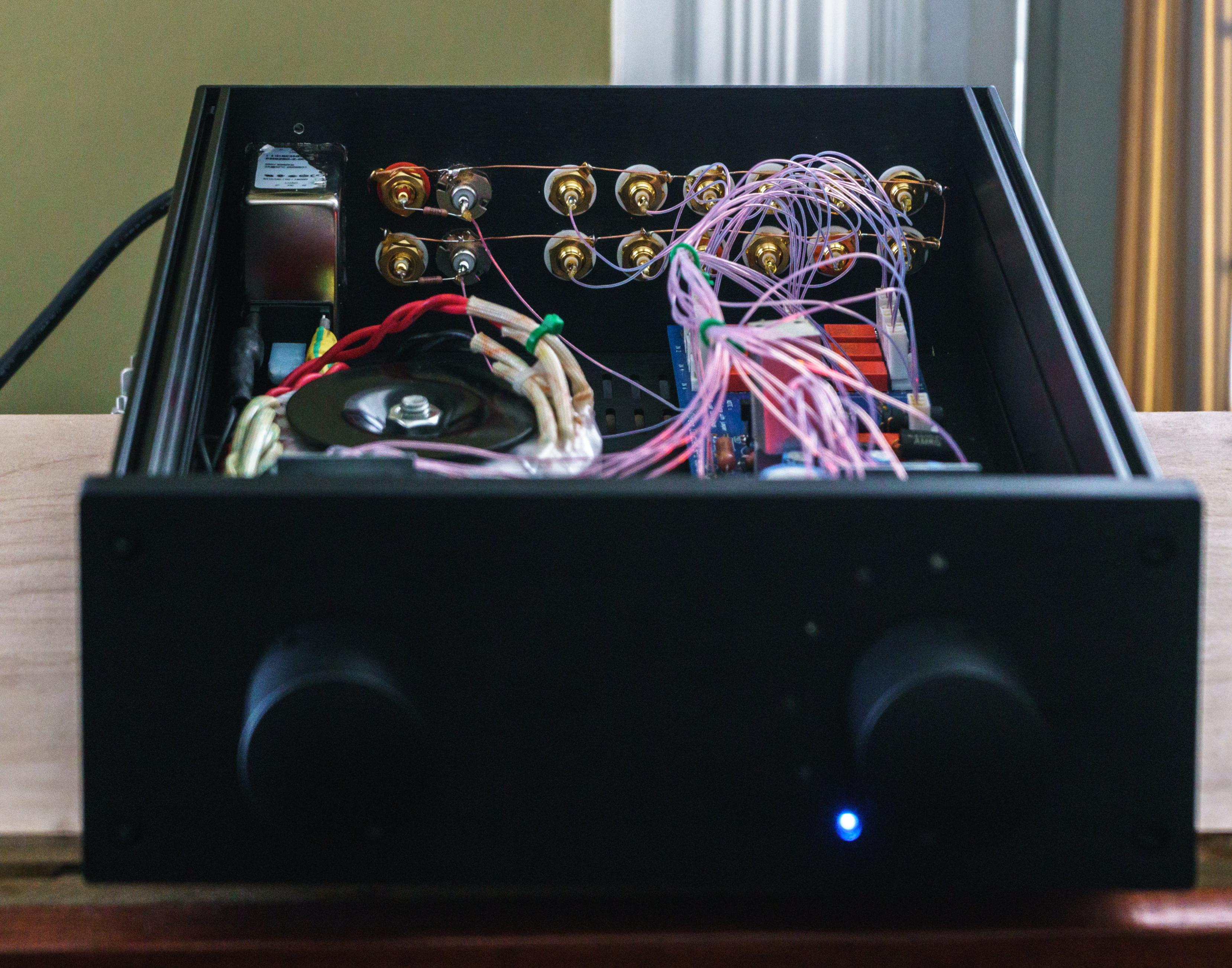

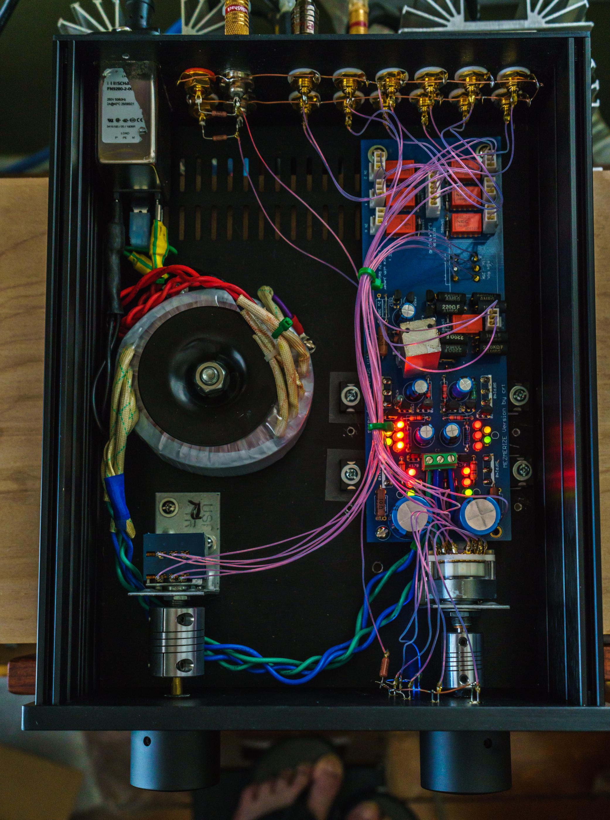

Just looked at the picture but why didn't you turn the PCB 90 degrees ? Then you would have the correct postition for the volume control (you would need an extension shaft/axle). Also the board could be at closer distance from the RCA connectors so essentially shorter wiring and less chance on mains hum from the transformer.

Hello Jean-Paul , it wasn't 2 minutes of thinking, was 6 years but I am a super Dumb.... just kidding, the board does not fit the way you propose , but they are as close as they can be.

Thanks Salas, as always you were right, put the fuses on and they are standing. Playing some music right now, no hum , dead quiet only music.
The only problem that I have right now is the cardas RCA's , solder is not sticking to them because I connected the Amp to them and they are not working.
Also, the LED's on the switch, they are not on, but I see on the picture that you posted,the middle point should be ground but is wire to the positive on the PCB, assuming this is right I connected to negative on pcb, then back to the iron.
Thanks again for your really helpfull guide.

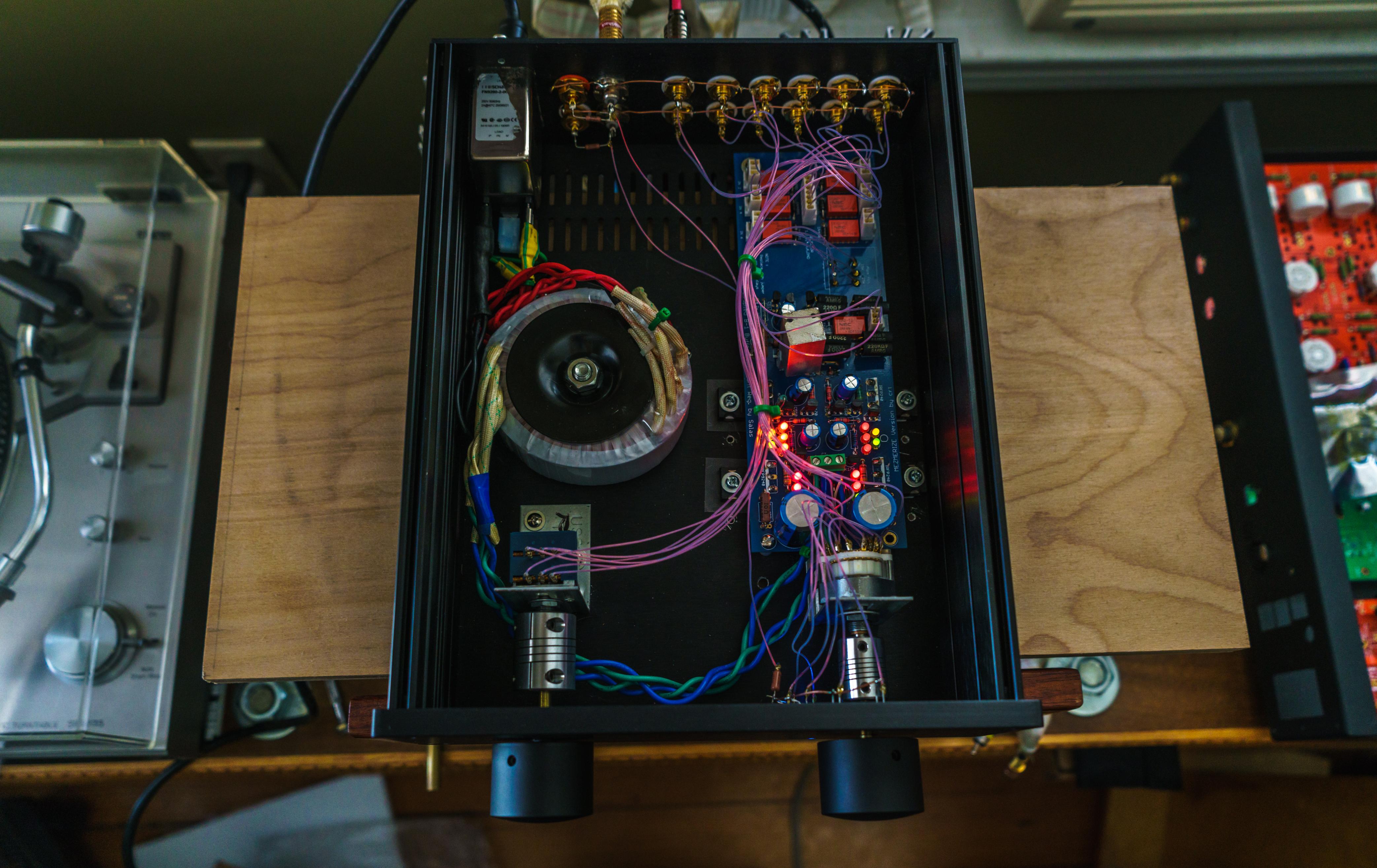

Hello Salas, scratched the surface of that connector and I think got it , is working on that connector, is playing beautiful music right now , have some pictures for you. Now I have to start soldering the last components of my dac (QuangHao DAC (it is way way more complicated than your project ) also I'm going to build your phono preamp after hear how amazing the Mezmerize sounds.

Your boxed Mez looks nice. Simply dark and purposeful with well integrated source selection lights. RegardsHere is the last one.

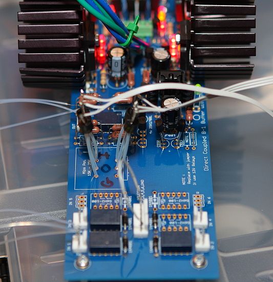

I want to add a lightspeed attenuator. Do I connect it? at the exit of the DCB1, on the boards pins, before it?

I have a similar question about the attenuator, I read somewhere that you put in on the input to the buffer. If this is the case doesn't the DAC or whatever is feeding this going to see the impedance of the pot not the buffer?
My DAC has digital volume so I'm going to build mine without volume but may add it later as the DAC is said to loose bits when the volume is well down.

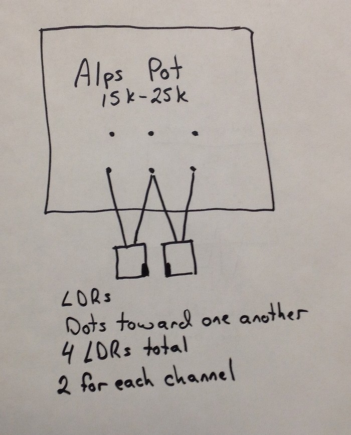

Thanks Eric, I haven't ordered the selector board as I'm only using the 1 input. Do you have a diagram of how you've implemented the ldr's.

You might consider Uriah Daley's "Clone Note" version - it has the adjustment of the series ldr for input/output impedances range, and the shunt resistors give the required attenuation and no need to closely match the ldrs - much more transparent/clearer sound than the basic 'Lightspeed'
As any volume control pot, stepper, etc produces a change in impedance (or a range of impedance dependent on attenuation) try the B1 buffer before the volume control and also after it, to see which suits your other components
