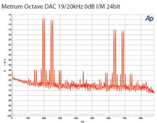

A bunch of DIY that had zero science classes compared the classes that those engineers had, decided that they "know better" and there is no need for filtering with NOS. There are no aliasing products in the audio band due to lack of filtering. Filters are just a conspiration. 19kHz and 20kHz fundamentals will not make the below picture (that is a real-life $24k DAC in NOS mode with no filters):
Fine, have fun in your imaginary world. Probably you will say that the above spectrum "sounds just fine, with exquisite 3D depth and a wide stage"....

You, as a illuminated teacher, care to explain how that non-filtered garbage shown in the previous picture can sound good?
We have alias products all the way to -32dB. And this is only from two fundamentals. That's the evidence that you missed - was there since 1982 when they invented the CD format.
Let me put the pic one more time so you don't miss it:
Nice pic, and here's the one from the Hifi Critic interview (I assummed it's the same as your's with the 19/20 kHz testtones). I'm sure if I were to use the AP we have at work, I'd come up with the same results.
Thanks to a test CD with tones up to 20 kHz that I've owned since I could still hear 20 kHz, I now know that 18 and 20 kHz are totally gone, and 16 kHz needs a higher setting of the volume knob.
Lay may hearing threshold over this graph (and lets not forget masking), and there you have the explanation why I don't hear any artefacts. The perfect low pass filter at work.

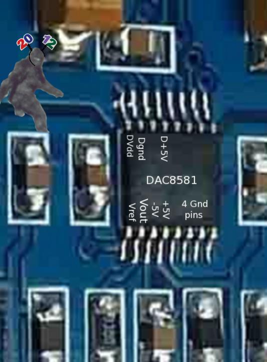

A little bit of sleuthing and it seems to me to be a DAC8581, the 4 ground pins are a giveaway, anybody with this dac and a multimeter should be provide confirmation?
Best pic I could find, just cropped and enlarged
Now to hunt down some Sasquatches :)
Also see the DAC8580, a member of the same family. The DAC8580 combines DAC8581 with an on-chip, 16x over-sampling digital filter.
