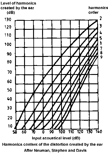

Gabevee said:
The ear does by the nature of physics create its own "even order" distortions due to the fact of unequal pressure on either side of the eardrum. I do not know the "percentage" of this distortion, but the amplifier or speaker that produces a similar type of distortion (not so much quantity) will sound more pleasant ("The Science of Music").
Yes, both the spectral content as well as the level of the distortion determine how pleasant / unpleasant it is.
As for the amount of distortion generated by the ear, the chart below adds some numbers to it. I'm sorry but in my recent HDD crash, I lost a huge file with more data on this subject. Fortunately, this image was also in another file which I was able to save.
IMHO, the imaging one gets from most tube amplifiers is from the even order distortion. This is why tube amplifiers also are perceived as "louder".
I sort of agree, provoding you are talking about specific amp's operation <i>near</i> clipping, when the usually much shallower knee in the transfer function of a tube amp will have the same audible effect as a compressor. It does not explain why my 25W differential tube amp sounds louder (more powerful) in the 1W region to a similar power class A SS amp I have. (100+dB speakers)
No, 25% distortion is never good. 1-4% OTOH can "sound" very nice. Odd order distortion is pretty much clipping, and one never wants to play their amps that loud ("drive them into clipping") anyway since these types of distortion can actually eventually damage the amp.
The only place more than a couple of percent distortion is good is in a guitar amp, but lower levels can sound OK, even pleasant, depending upon spectrum. Unfortunately though, with high levels of THD comes IMD in many (most?) cases which is considerably less pleasant to the ear. Put an orchestra and chorus through most SETs and watch them fall to pieces.
3H can be caused by a lot of things, completely unrelated to clipping, and except for DHTs, most amps can be clipped continuously and survive just fine.
Cheers
