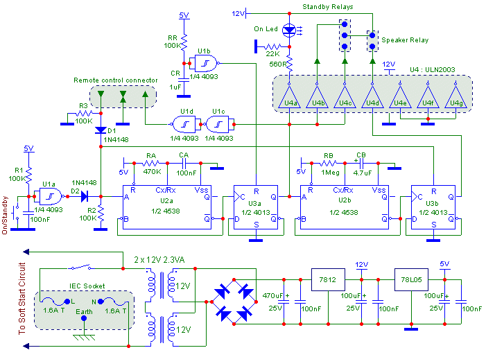

Many requests too for the standby circuit... So here it is.
Just a few logic circuits put together, et voila :)
A triggering pulse is either generated by a debounced pushbutton, or by a pulse
coming from the preamp. These two activation sources are "summed" by a discrete
OR gate formed by D1, D2 and R2.
The working mode is slightly different in a stanby->on or on->standby sequence.
From standby to on, the pulse triggers a non-retriggerable monostable (U2a), with a pseudo-period of a rough
50ms (RA x CA). After this time, the first D ff (U3a) is toggled, and its output switches the standby relays
on, an the "On" Led as well. It also triggers the second monostable, with a pseudo period of 5s (U2b & RB x CB),
and after this time, the speakers relay D ff is toggled on. The relays and Led drivers are contained in an array
of darlingtons (U4, ULN2003), which includes free-wheel diodes for the relays.
The "shutdown" pulse acts a bit differently : it immediately shuts off the speakers relay
(through U3b's reset), and disconnects the standby relays 50ms after.
When the mains switch is activated, a simple reset circuit (RR, CR, and U1b) ensures a right
state of the circuit.
The "On LED" arragement allows to have a faint light when in standby mode (with the 22K resistor), and a full
light when on, through the 560R resistor. Tune these values to your likes, and according to the Led you're using.
The soft start circuit for the power transformer is not shown, but you you can find it here on the
forum. 120VAC/60Hz users should use a 150nF X2 cap for C1...
Just a raw estimation, so be careful and recalculate the values !!!! Letal voltages here.
Feel free to ask if anything is not clear.
