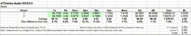

We haven't done anything with our 5.5 yet. Attached are the measured data from that pair.
From the data, it looks like a BIB or a mid-tweeter in a FAST (OB or otherwise)
