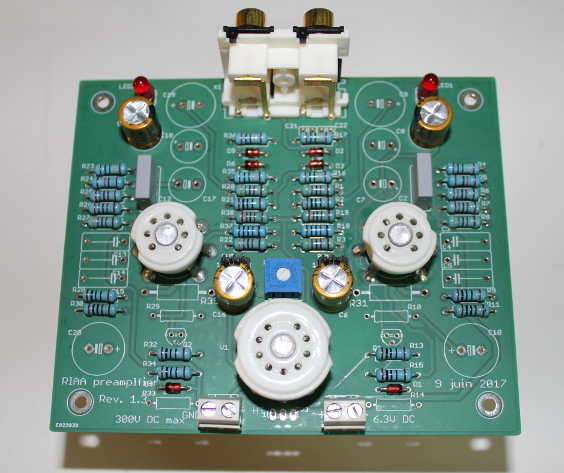

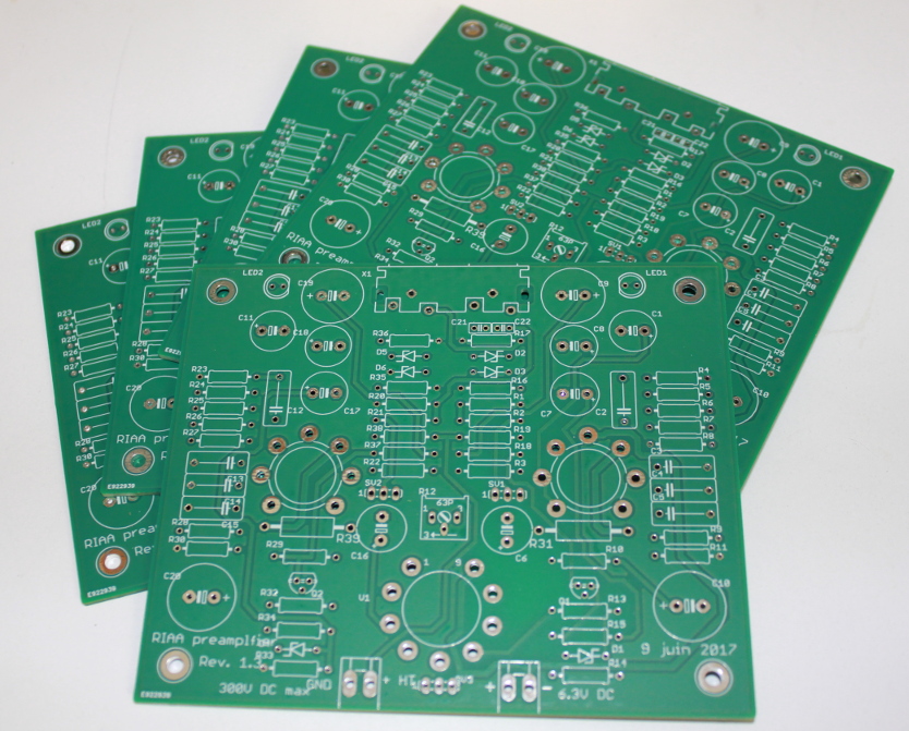

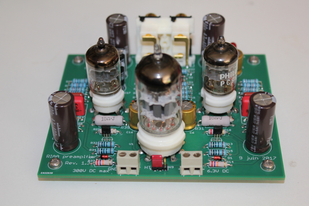

Nobody found it but there was a big error on the PCB : the pin-out of the ECC82 / 12AU7 was reversed, I mean view from bottom instead of top
Hopefully I discovered that just after I had sent the files to the manufacturer and I could change it immediately
Now I have just to wait and hope there is no other error ?
For your information I have added the final version below... For a better readable PCB, I didn't enable the ground planes.
Marc
Marc

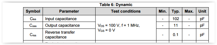

One more thing to check - the ZVN054A has a dissipation rating of 700mW. Its voltage and peak current rating is fine.
You might want to check if you are safely within that rating with R14, R33 at 27K. If it is dissi[ating more than say 350mW you may want to choose a higer power rated MOSFET. There are some newer devices rated at 1.5 watts with similar low Crss. On another thread Eli (Duttman)saidf he uses IRFB20 when the ZVN0545 doesn't have enough power capability, you could check it out.
Ian
Ian
Hi Ian,
Thanks for the warning !
I try to look to other depletion mode MOSFET in TO92 package (PCB is in manufacturing...) and I have found two interesting alternatives :
SSN1N45B from Fairchild, Vds = 450 V, Id = 500 mA, P = 2.5 W, Rds =3,4 ohm, Crss = 6.5 pF
STQ3N45K3 from ST (with Zener) Vds =450 V, Id = 600 mA, P = 3 W, Rds = 3.3 ohm, Crss = 3 pF
To compare the ZVN0545A has also Vds = 450 V, but Id is 90 mA, P is only 0.7 W and Rds is 50 ohm, Crss is 4 pF....
The device from ST is a little more powerful, has a lower Crss and include a Gate-Source Zener protection. As a bonus its price is only 0.58€ each in qty of 10 on Mouser The ZVN0545A is 1.18€ and the SSN1N45B is the cheapest at 0.48€ !
What do you think about using the ST part and avoiding the external Zener ?
The other suggestion from Peter did not fit in this project because it's a TO220 package, far too big
Marc

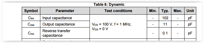

...try this STF7N60M2
Am I reading the STF7N60M2 datasheet correctly? Does that really say its Crss is 0.68pF? Is that possible? If so... Wow! What's the catch?
Or am I confusing Crss with Cinput?
Higher power rating is good, make sure pin out is the same, it is a pain to bend leads around to suit the PCB. BUT don't go higher power rating than absolutely necessary, higher power rating MOSFETS generally have higher lead capacitances.
Because it is in Source follower mode then Ciss is not critical but for optimum HiFi performance Crss is important. if you check out the various data sheets you will see that Crss modulates with Vds (that is with the audio signal in source follower mode, coz the Vdrain is fixed but the Vource follows the audio signal) and that is the problem. From the datasheets you will also see that as long as you maintain a Vds of at least 30V, even on peak positive going signals, then Crss is low and reasonably constant.
Ian
Ian
No, the pin out is not the same, the gate on pin 1 instead of the middle one but it is easier to adapt it than a TO220
Thanks for the explanation, I learn a lot with you ! Crss is only 3 pF with the STQ3N45K3 from ST, this is even better than the ZVN0545A which is also becoming more difficult to find... I have bought to test it.
i use it on ecc83 (very high ri, no prob) gyrator, sound is sharp as razor Drives endstage very well
Went thru all mfg., only ST has so low Cgd fets..
oh, another.. http://www.st.com/content/st_com/en...esh-gt-700-v/mdmesh-k5-series/stf3ln80k5.html
Cmiller = 4pF + (70+1)*1.1pF = around 85pF

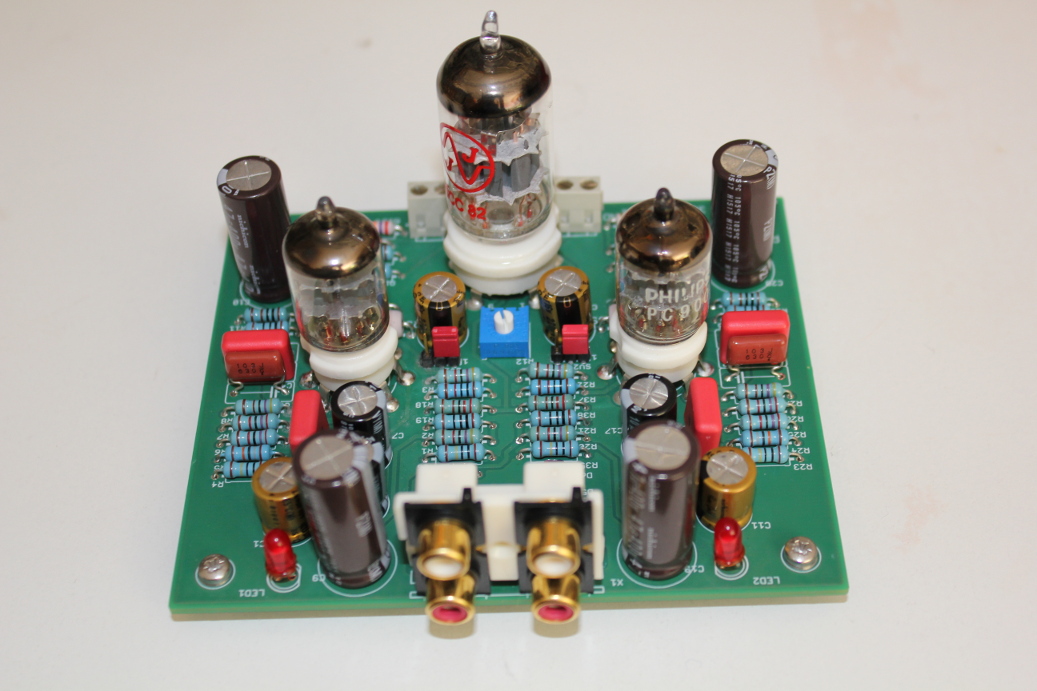

The Project is moving ahead, board is partially built, I need to order some components that I haven't in stock...
By the way I changed some resistors value in the RIAA network to use more common value (E12 series). I replaced :
200k + 7.5k = 207.5k with 180k + 27k = 207k
and
30k +1.8k =31.8k with 27k + 4.7k = 31.7k
The change is lower than the 1% tolerance of the resistors and should not modify RIAA correction
Some photos of the work in progress...
Marc

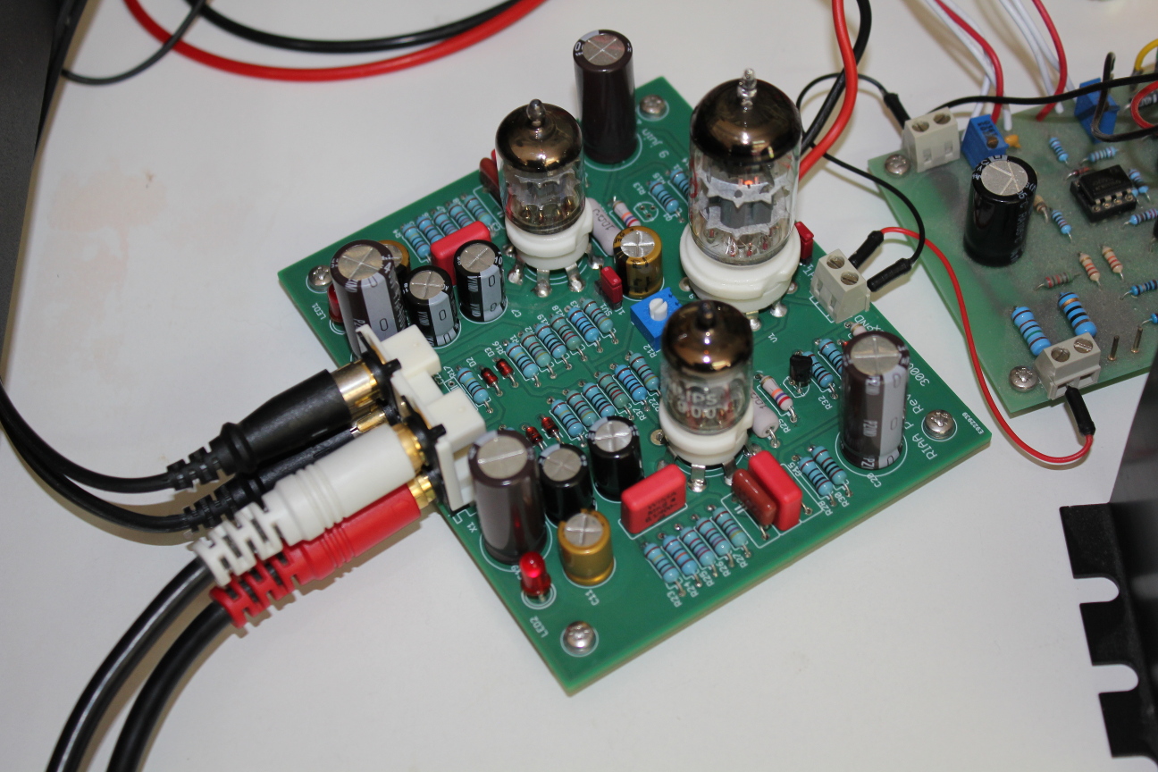

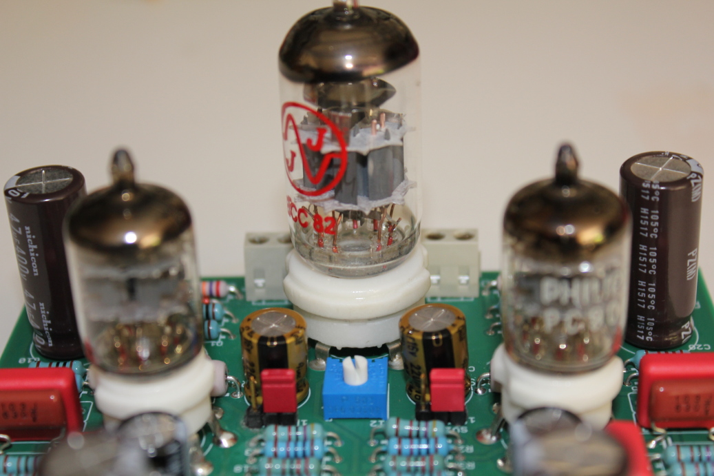

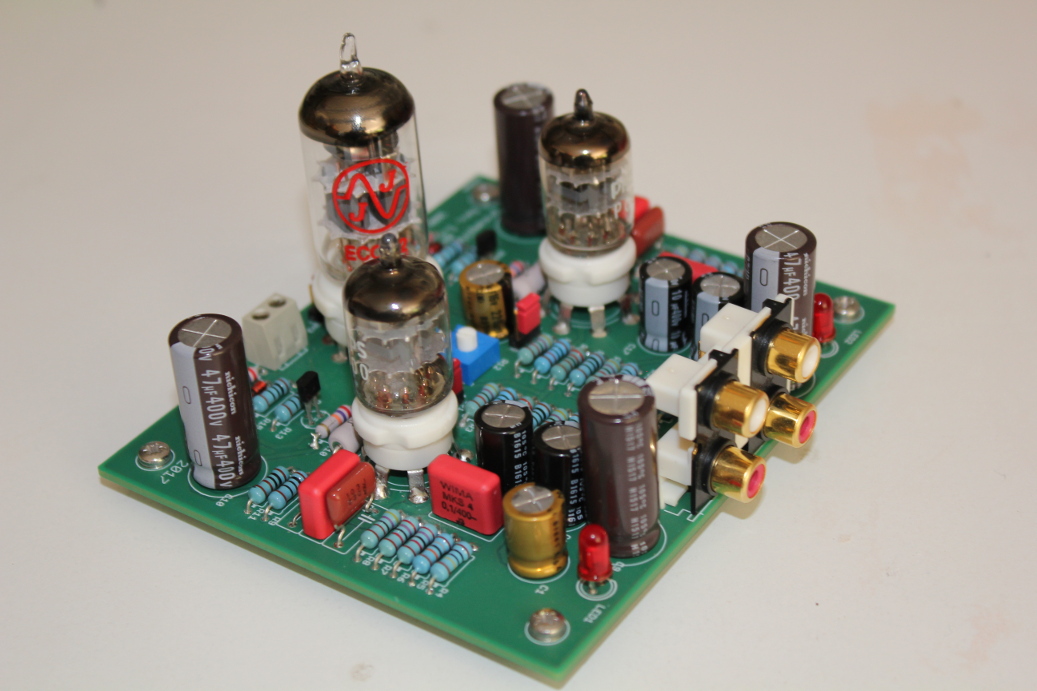

After a short trip I am back and i have finished the RIAA amplifier (see the photo) but I have some trouble with one channel
On the fourth photo you see the red jumpers for the PC900 option, on the fiftieth photo the second MOSFET is not yet soldered, with only the first working channel completed, at that time I was still happy
After I completed the first channel with the STQ3N45K3-AP, it worked immediately. I found it a little noisy but as I made the test with a old turntable and a old Stanton head in an open environment (no shielding) I didn't investigated that further in a first time... I checked the temperature of the MOSFET and found it a little bit warm but not hot
Therefor I decided to use the ZVN0545A on the second channel to avoid to turn the leads of the transistor, as Ian pointed out they are not fully compatible !
That was a big mistake ! Not only the second channel didn't work, but the MOSFET became immediately very hot. I stopped everything and de-soldered it (what a mess with plated through holes) to replace it with a STQ3N45K3, however I had the same symptom : MOSFET very hot and no sound
It is exactly the same layout than the other channel, I don't understand... I cannot make voltage measurement because I am worrying that the transistor will die if I don't remove the power immediately ! Any suggestion ?
Marc
