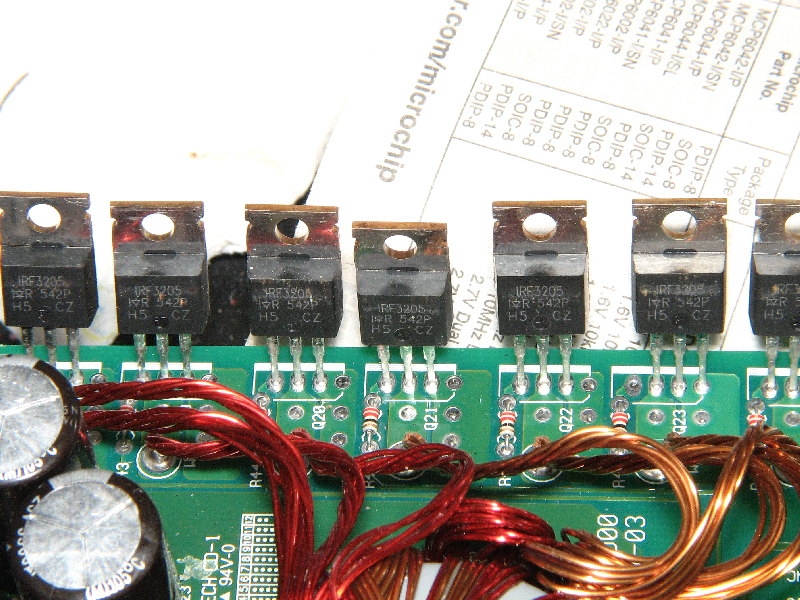

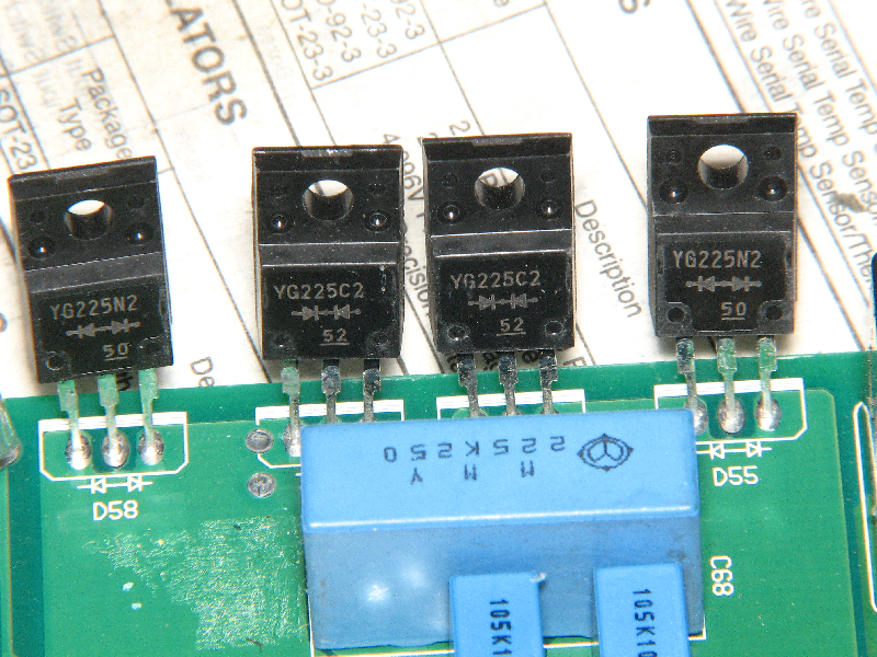

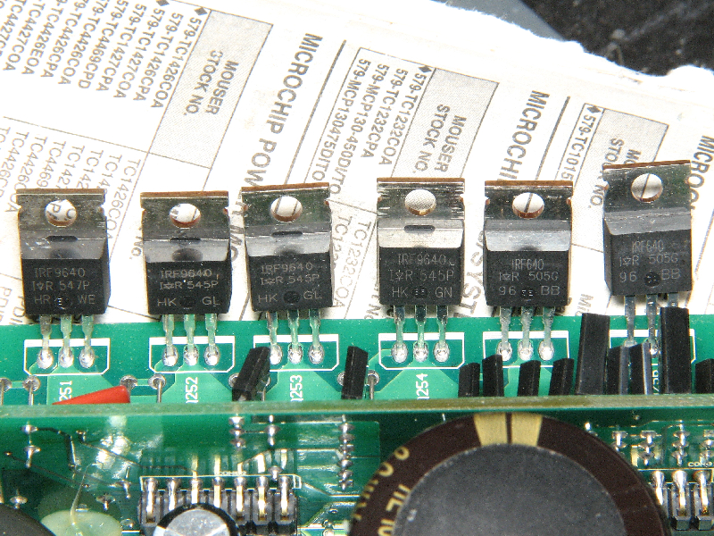

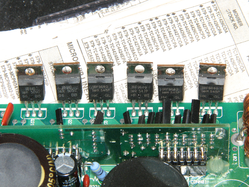

Need to know what and where ALL to-220 package parts go inside this amp. Here is the list
D55
D56
D57
D58
Q17
Q19
Q20
Q21
Q22
Q23
Q24
Q211
Q212
Q213
Q214
Q215
Q216
Q251
Q252
Q253
Q254
Q255
Q256

See attached. What do you need the schematic diagram for? I don't have one but I may be able to tell you what you need to know.

D55 = YG225N2
D56 = YG225C2
D57 = YG225C2
D58 = YG225N2
Q16 = IRF3205
Q17 = IRF3205
Q19 = IRF3205
Q20 = IRF3205
Q21 = IRF3205
Q22 = IRF3205
Q23 = IRF3205
Q24 = IRF3205
Q211 = IRF9640
Q212 = IRF9640
Q213 = IRF9640
Q214 = IRF9640
Q215 = IRF640
Q216 = IRF640
Q251 = IRF9640
Q252 = IRF9640
Q253 = IRF9640
Q254 = IRF9640
Q255 = IRF640
Q256 = IRF640
