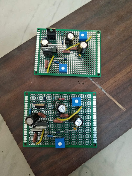

At last Some progress.
Here are pictures of some progress. Actually I forgot order zener dioes and bleeder resistances. So I ordered again.
Hi!
Two questions:
I have 70mV rms (psu is for one chanel only) of ripple with 88000 uF for rail (no crc filter), is it OK or it need however crc/clc filters?
About ac gain some tricks for best performances?
Now I have set it for best simmetrical wave form performances at 1khz sine for 4 Ohm load before clipping.
Is this the right way?
Thanks.
-if spks are silent , no need for CRC ; if there is buzz and it annoys ya , go for CRC
-AC gain - 50% is , say , starting point ...... you can try up and down from there , and let your ears decide ; no other recipe
I have calculate (2A bias) about 60% after my empirical scope analysis.
Do you have hear experiences about ac gain setting?

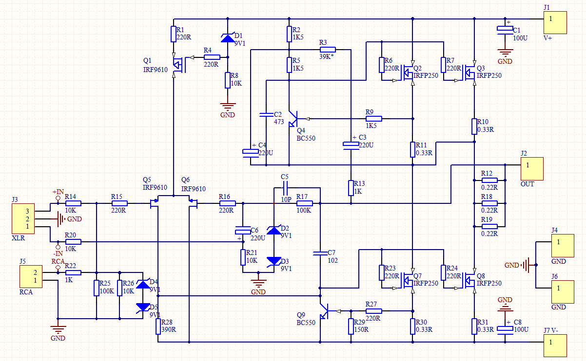

Hi! Please some advice.
I used according Mr.Pass diagram
R17= 10k (with 100pF //) instead 100k
R21= 1k instead 10K
Is sure the there are no differences in the feedback network?
And about C6 220uF can it be a good idea to bypass it with another capacitor of appropriate value and specific constructive feature?
Also decresed R29 from 150r to 100r to raise the current protection limitation, are thi the right way?
