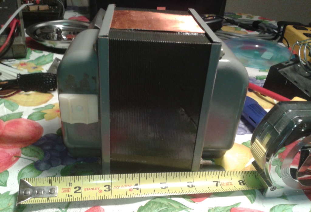

Finally got around to it. Took Xformer out, removed end bells and immersed entire unit into Polyurethane Varnish for a couple of hours.
I then let it dry out for 3 days, reassembled and reinstalled into amp.
Result? Marginally better :( Wasnt worth the effort nor the expense ($25 for the varnish alone:eek:)
Bummer.....

'Did tell you more appropriate methods, and a DIY version too!
There is no guarantee of any useful penetration with just 2 hours sitting in (cold?) varnish and 3 days air drying in
an enclosed volume suggests what little penetration there is could still be wet with solvent. It needs stoving to dry firm.
Hard varnishes (regular Copal, Spar varnishes etc.) are often used to ensure enough mechanical strength for impregs.
and an old transformer will need it.
Be serious, heat the transformer to 60-70 degrees C (check) first and then dip it outdoors with no ignition source or it's :flame:!
Don't remove until it is all at ambient temp. 'Not sure doing it in sub-zero weather is going to work, though.

Thanks guys. I`m not quite ready to give up on this as I really like the amp:)
Ian: if I understand correctly, I should heat the transformer and varnish first.
How long should the transfo be heated at 60c? I`m concerned about the insulation melting off the primary and secondary wires.
How would you suggest heating the varnish?
With only 1 litre of varnish to play with, the transformer would have to be "basted", would that work?
Tony: I`m not sure if there is enough clearance to accomodate wooden shims between the winds and core, if there is, can your method be used in conjunction with that of Ians?

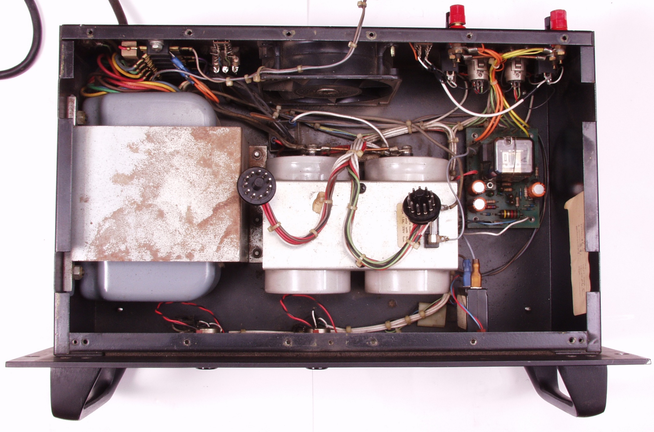

Another Update
Not satisfied with the results of my varnish soak, I decided to give the mechanical decoupling method a shot.
I found it interesting that with the xformer removed from the chassis, the hum was practically inaudible!
It took some time to figure out a scheme given the really tight fit within the chassis but I managed to do the following:
Inserted a thin dense foam pad (think mousepad) between xformer and chassis at the two points of contact, the mounting side and bottom, as well as between the xformer and right angled metal shielding plate which covers the top and side of the core.
The xformer was secured like this:
1/4-20 bolt head>metal washer>3/8" rubber grommet sliced down the middle>chassis>foam pad>metal shield>Xformer>other half of sliced grommet>metal washer>nylon nut.
The last half grommets could not be used on the underside of the xformer as there are speednuts mounted there and quite unreachable.
1/4"grommets went between the shielding plate and underside of the chassis.
The result? A significant improvement! It is not totally silent, I suspect a little transmission taking place through the bottom speed nuts but not much can be done about that.
For the moment, the noise level is acceptable. Depending on my level of OCD and or boredom, I may re dip and cook the Xformer when the weather permits.
Thanks to all who chimed in, hopefully this will help someone in the future.
