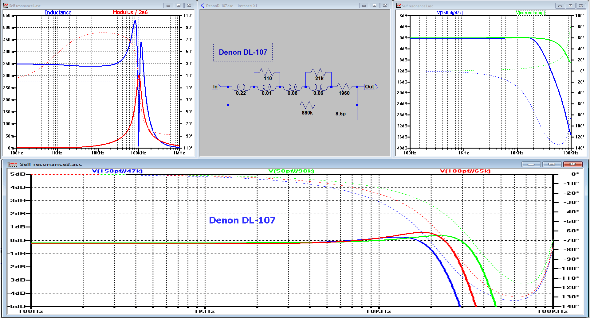

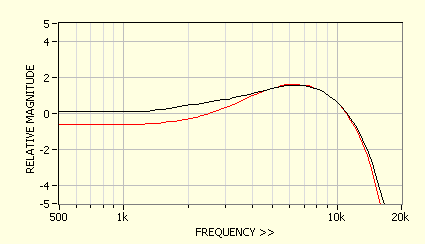

Back onto MMs and I would like to present another rare oddity. The Denon DL-107 which is a wonder from the 70s. Supposedly designed for the same radio turntables the DL-103 MC went into so a low compliance brute of a cartridge. I can't help collecting things like this. Note we are trying the same loading with all cartridges at the moment to test a theory, so optimisation might follow. In this case the simulation and measurement are slightly apart being 3.6dB different between 20kHz and 30kHz. This will need revisiting but again no evidence of mechanical help in the HF region.

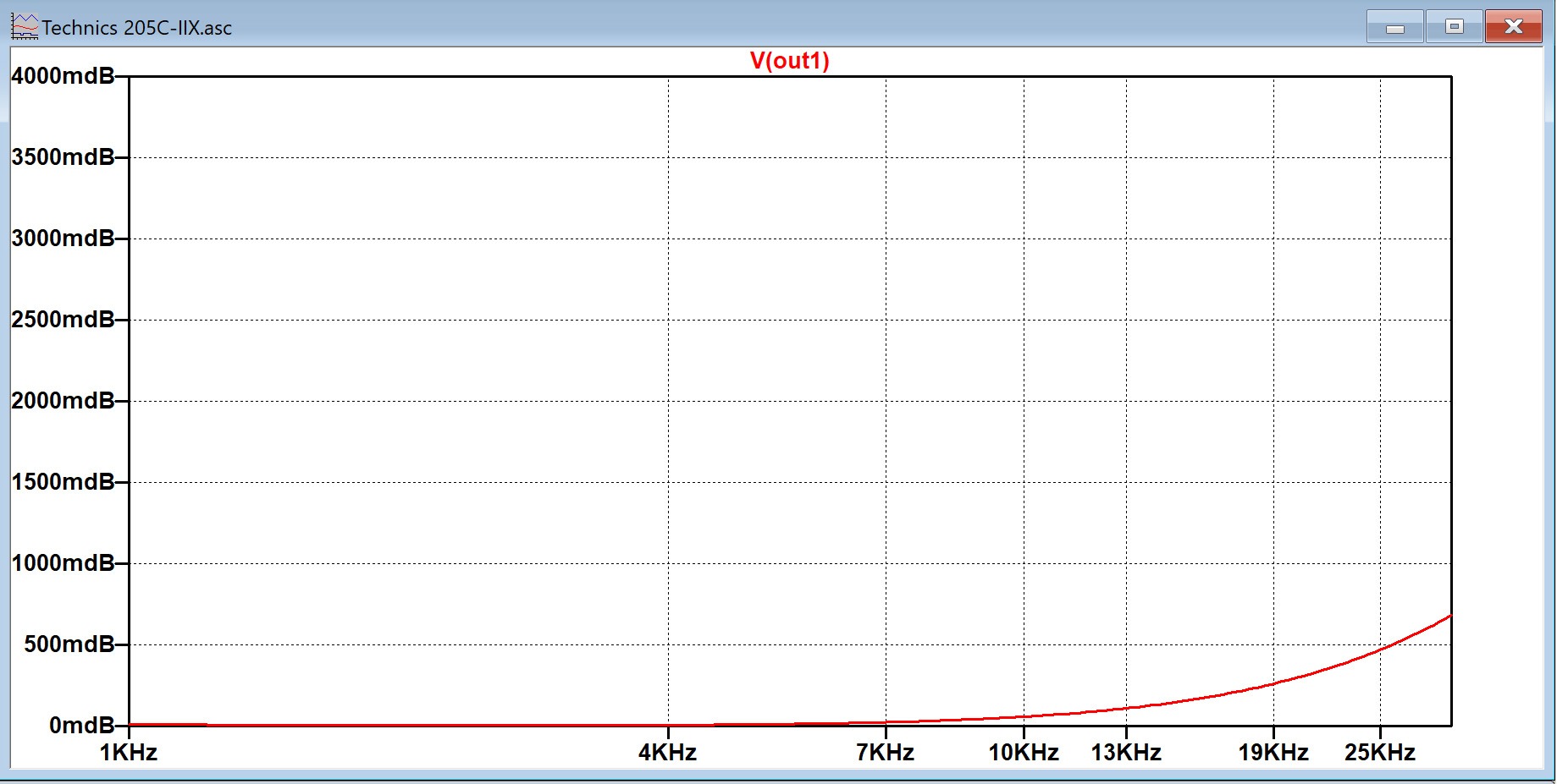

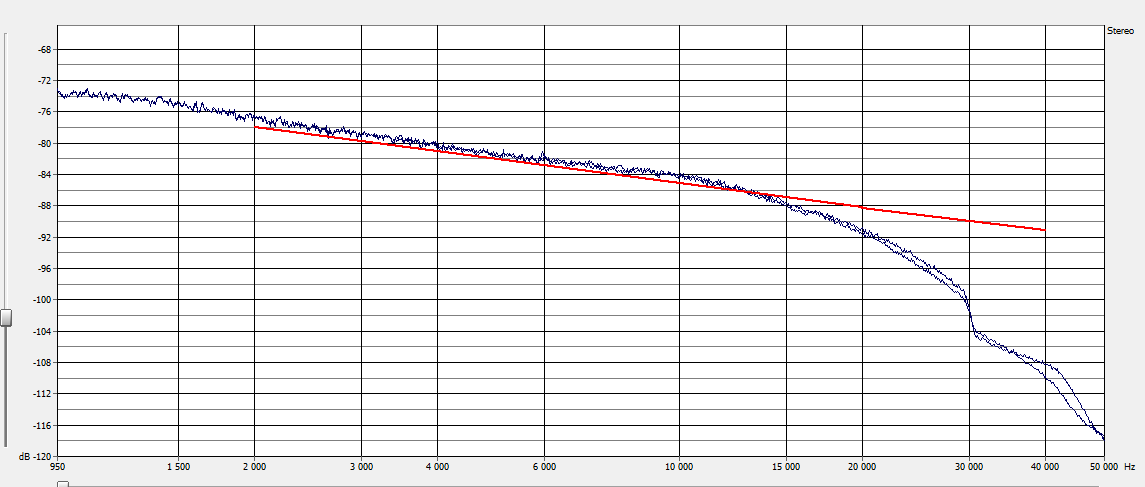

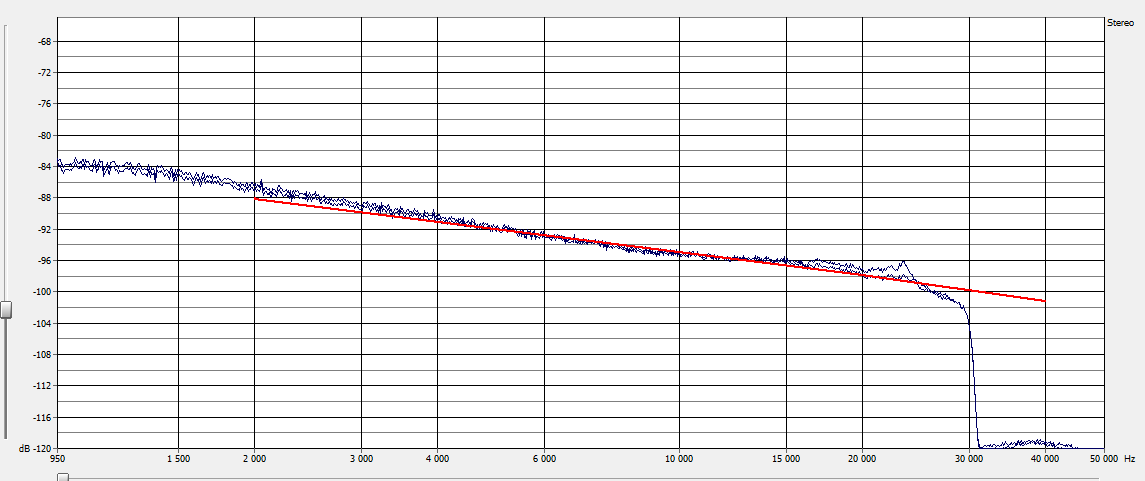

And finally tonight a cartridge people may at least have heard of, the technics snappily named EPC205C-IIL. It's younger brothers the mk3 and mk4 are famed as some of the greatest MM ever made but IMO this one is no slouch. Plus I can't afford the more fabled brethren. The L model has a very low inductance coil which should make it less sensitive to capacitive loading, so lets see how it did. For a cartridge older than my wife ;) it did pretty well. Second picture here shows deviation from the simulation and this is around 0.3dB at 20kHz.
None of this is AES grade data but really not seeing anything to even hint at a mechanical resonance. Now of course I'm not expecting to find anything so I may be blinkered, but data is there for you.
What stylus and loading was that test with ?
I have both a mk2 and Umk3 with OEM mk3 stylus and Jico SAS/B and I can vouch for the wonderfully detailed sound of this cart.
How about that 1 dB...3 dB peak at 24 kHz? It could be a resonance with Q > 1/2 sqrt(2), although the roll-off above it looks to gradual at first sight. At least it's a peak that the MC cartridge hasn't.
I would expect the biggest mechanical peaks for cartridges with a high inductance, high recommended load capacitance and nonetheless a reasonable frequency response.

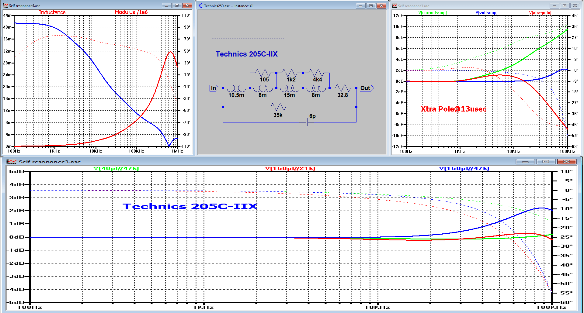

Even one of the latest posts still treats the cartridge electrical circuit as a simple inductor having series resistance. This simply isn't true and leads to incorrect assumptions about the mechanical system. If you make a multi-frequency electrical impedance measurement of a moving magnet cartridge, you find that hysteresis losses in the pole pieces/core require splitting the inductance in two, with one inductor having parallel resistance. The effect is that at high frequencies, apparent inductance is much lower than low frequency inductance - which makes a big difference to the LC resonance. That same model is also needed for a moving coil cartridge because of transformer coupling to the adjacent magnet (just like loudspeakers). Without a valid electrical model, attempting to deduce a good mechanical model will be hard.
Tinkering just with the electrical model for cartridges designed after 1980 (all I have), simulation says that reduced loading capacitance (200pF maximum) is always a good thing, but that loading resistance usually needs to be increased. I decided that "optimum" loading was one that didn't have a 6-7kHz depression, and tweaking for that invariably causes an HF peak (which I probably won't hear). Now, the interesting thing is that I see that Paul Miller's measured response of an Ortofon 2M showed a very similar response from a test record. Which says that it was only the very early designs that needed the resonant LC equaliser to correct their response and that loading capacitance now forms an unwanted low-pass filter, just as suggested by Cordell.

Sorry I completely forgot to add the cartridge models, they are anything but simple. Agreed that excess capacitance is usually the thing, but right now we are not looking at optimal loading rather seeing if MM response can be explained entirely by electrical means, which so far we have.
@MarcelvdG there is 'something' on one channel at 24kHz but not on the other, so I suspect something else there. Above 20kHz we don't have a test method we can use for that. Needs more thought.
@warrjon Jico SAS stylus same loading as for the other tests 48.5k||192pF.
Forgot to mention, based on the generator models Hans developed some cartridges (ortofons and modern ATs) do lend themselves to the Cordell 'damped RIAA' approach. Others do not as this leads to a rising response that needs another pole to correct. But some of us are happy to have phono stages that are effectively customised for one cartridge...

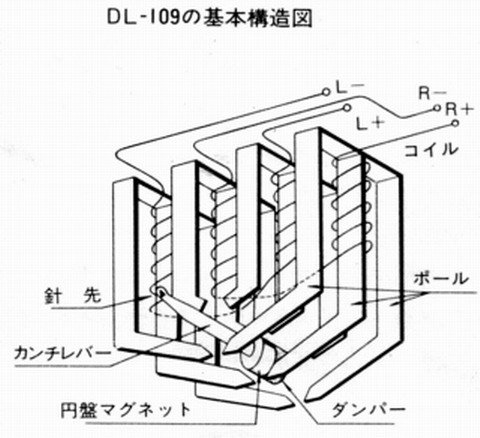

As you well know the cantilever flaps all over the place and it's a miracle the darned thing works as well as it does. I do have a B&O MMC but that's in california. I also have an At150 which I need to ship to norway for measurement. As I am on record saying, the transmission line model for a cantilever makes more sense to me and there are some tantalising glimpses of this in some of the 80s cartridge literature but I'm not sure of the right way to meaure it. For your delectation I have added a diagram of the internals of the DL-109. It's bonkers, so I had to have one. The logic behind it is explained in the patent for it's older brother the DL-107 which I have if you are interested. But 4 pole is more common (think ortofon).
The Decca/Neumann designs (which I think of as sum and difference sensing) do have a simplicity about the setup that is intriguing, as does dynavector. I've never had the pleasure.
