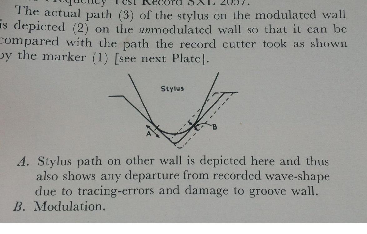

Apologies for bad rapid phone pic of the part of the page in question, but I think I have worked out what they did, just not how. Reason for scan is easier to explain.
As only one groove is modulated, you can see all stylus movement is at 45 degrees, so if you were to put a teeny pencil on the stylus on the unmodulated side you would trace a sinusoid on that wall.
Now, the end result is an SEM scan. Impressive as I have used a 60s SEM and they were ornery beasts (especially when 30 years old). SEM needs a conductive surface to work, so I am wondering whether they worked out how to put something conductive on such that the stylus on the unmodulated side smeared the track into it. How and why it didn't ruin the tribology is beyond me but this matches what you see.
Could be wrong as it was 3AM when this came to me!
Can't argue with you on that. Reading the missing page doesn't make it much clearer. Basically as only one wall is modulated the stylus will slide up and down the unmodulated wall, but how on earth Dr Chippindale recorded that is the mystery I have no idea. I'll try and find out more.
As regards reasonable situation, that comes back to the issue of when the plastic deformation limit is reached (and if in fact it can be) which links to forced applied due to resonance.

I really doubt it has anything to do with tip-mass........
We know the test track was the 10kHz band on Decca SXL2057, which was one channel only modulated physically 5cm/s rms. For even a 3mg tip mass stylus, that works out as a lateral inertial force on the stylus of about 0.7g rms, coincident with 0.7g rms upforce, which is insignificant in the context of normal VTF here............and besides doesn't explain the continuous gouge pattern on the unmodulated wall.
I agree with you that, on the strength of J Walton's plastic deformation tests on blank vinyl with a spherical tip, about 3g was the observed limit for plastic damage. Yes, that seems to close a loop. But for those tests to be valid, the stylus would have to be truly spherical because the base of the stylus would have the contact point, whereas styli might not be produced with that in mind............? A rounded off conical, for example....... There's also a factor of sqrt(2) to apply to accommodate two support points in the V groove.
At least, I believe, we might have found the source of the stream.
I venture there might have been some mix-up between 3mg tip mass and 3g VTF in the labelling, handling or interpretation of the images ?? But even 3g VTF seems improbable to inflict such damage, which would be sure to show up in tests but doesn't, IME.

Definately tip mass, but I haven't waded through enough of his papers yet to get to the bottom of how he calculates this. I've found the section but need to confirm that he is consistent where he works out static force plus inertial acceleration to get beyond the plastic deformation limit. I've found the section, just need some time.
Joined 2014
Just had another scan and the book is not consistent. In one section he calculates that the tracking force required for handling maximum expected modulation with a 2mgm tip mass is 7g then a few pages later he talks about the damage caused by that tip mass tracking a 2g, where it will clearly be mistracking. I need to look at the WW articles to see if he covers it in more depth.
Basically he is saying that tracking force needs to overcome Inertia in the stylus, the compliance and the frictional force required to move the tonearm. So far so good, but the source of the numbers is not shown. There are then some tables showing distortion for different tip masses at the same VTF vs frequency and modulation depth. In these at 8kHz and 5cm/s a 0.6mgm tip mass will be around 3.5% HD, a 2mgm tip mass 5% and a 3mgm tip mass is just shy of 20%. And he claims it is that 20% distortion that causes the stylus to 'plough its own groove'. or in other words mistracking damages things!
Or to put it another way, to get 3mgm to track you need such a high VTF that it's likely to damage things and if you track it too light it certainly will. But his argument is not presently particularly coherently.

Yes - I think it doesn't stand scrutiny, and I can't quite make those figures work, but a factor of sqrt(2) might cover it in terms of Walton's target. Tracking a 15cms/@10kHz grooveshape with a 3mg stylus would require about 3g VTF, and result in peak normal force of about 5.8gf, I think.
However, the SEMs we have are a much softer target: 5cm/s@10kHz on one channel only for the Decca SXL 2057.
I speculate that, considereing a 3mg 'tip-mass' stylus required 7g VTF to track, that is what was used for the test? Hence the gouge on the unmodulated wall, and damage to the modulated wall. For completely unforseen reasons, the association of high tip-mass needing high VTF was self-fulfilling in terms of causing permament damage due to high VTF ?? That would be consistent with the SEMs, IMO ?

I think you have it (a bit more alert now so I can type betterer). He calculated 1000g for the extreme peak modulation which is in the same spherical cow as your calculation. Now he changes to a 2mgm effective mass and calculates 5g VTF for mono and 6 for stereo. Then he says another 3g to overcome the 'damping' This then leads to the Walton spec for a pickup (as you say SOTA in 1960ish) should be
5cu compliance
less than 1mgm effective tip mass
'well damped'
3g VTF.
Still leaves a hole the test for the damage though and you might be right that he just didn't copy read properly. I guess you don't buy my theory of the unmodulated wall 'gouge' actually being a smearing of something conductive to give a stylus path recording? (don't blame you either :) ).
