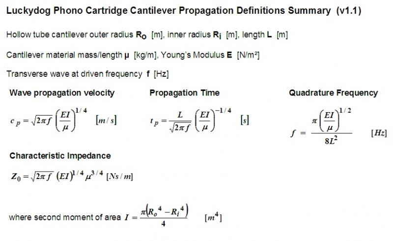

Hoorah, found the equations I derived some years ago for a cantilever as a transmission line, thought might as well put them up here......
The frequency term crops up because transverse vibrations are dispersive, ie waves propagate at different velocities depending on sq rt frequency. Mechanics is stranger than electronics by far
Quadrature frequency is the frequency at which phase shift between ends of a cantilever is 90 deg.
Interesting ? I can't vouch for correctness, BTW.

Ha, I wish ! Such stuff gets purged, if you would believe it, but not from this site AFAIKReal men use the internet as backup. (Linus Torvalds)
SAW/BAW filters have always done my head in
Except that all electronic components are at some level mechanical.
Yes, Rayleigh waves in solids are weird. Left to their own devices, they are dispersive (ie different frequencies propagate at different velocities), but by careful design SAW filters can have constant prop velocity versus f. Can also make long TLs or delay lines from them, of course.SAW/BAW filters have always done my head in
Fortunately, I think what happens in cantilevers is classic beam flex, rather than Rayleigh waves. Though they are cousins. But even in classic beam theory, the surface layers and boundary plays a big part in determining TL properties overall, esp as to damping.
