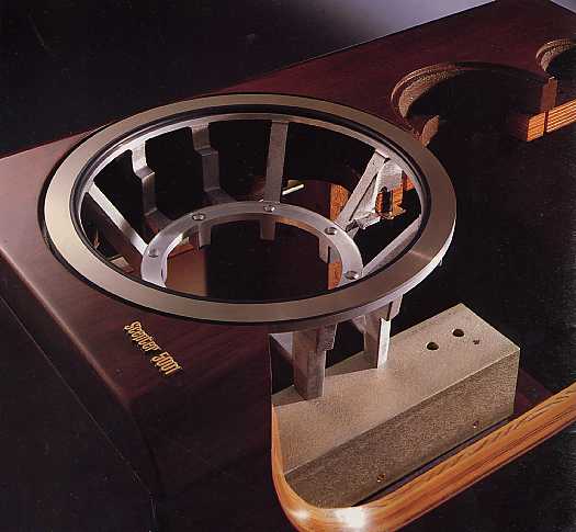

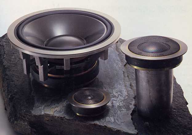

"isolated mount system" of Onkyo Scepter 5001 (1986)
43×75×49 cm, 73.5kg each
