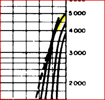

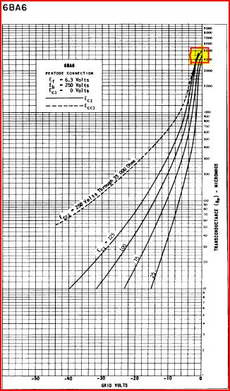

I believe my mistake was a misinterpretation of the data sheet.
The data sheet under "Characteristics" calls out two configurations. One at 100V Plate and one at 250V Plate. I'm using the 100V Plate specs which are :
Plate Voltage - 100V
Grid-No3 and internal shield - Connected to cathode at socket
Grid-No2 supply voltage - 100V
Cathode Bias Resistor - 68 Ohm
Plate Resistance, approximately - 0.25 Meg
Transconductance - 4300 umhos
Plate Current - 10.8 mA
Grid-No2 Current - 4.4 mA
Grid-No1 voltage (approx) for transconductance of 40 umhos - --20Volts
Since I am adjusting the Grid-No1 bias to set the plate current to 10.8mA, I should not have had a cathode resistor in the circuit. The cathode resistor was providing negative feedback which resulted in low measured Gm values.

I attached the 6BA6 gm curve for reference. I think the measurement needs to be done in the area of the chart I highlighted in the enargement. To measure gm between 4000 and 5000 the grid swing needs to be <= 1.5V peak-peak (~0.5 VRMS) or less and biased up so that Vg1=0 on the positive peak. I think for small signal pentodes the 0.1V RMS might be a better choice if you can get the S/N ratio of the test set good enough. Your current 1VRMS produces too much current swing at the anode.
Michael
I had suspected that and tried lower drive levels.

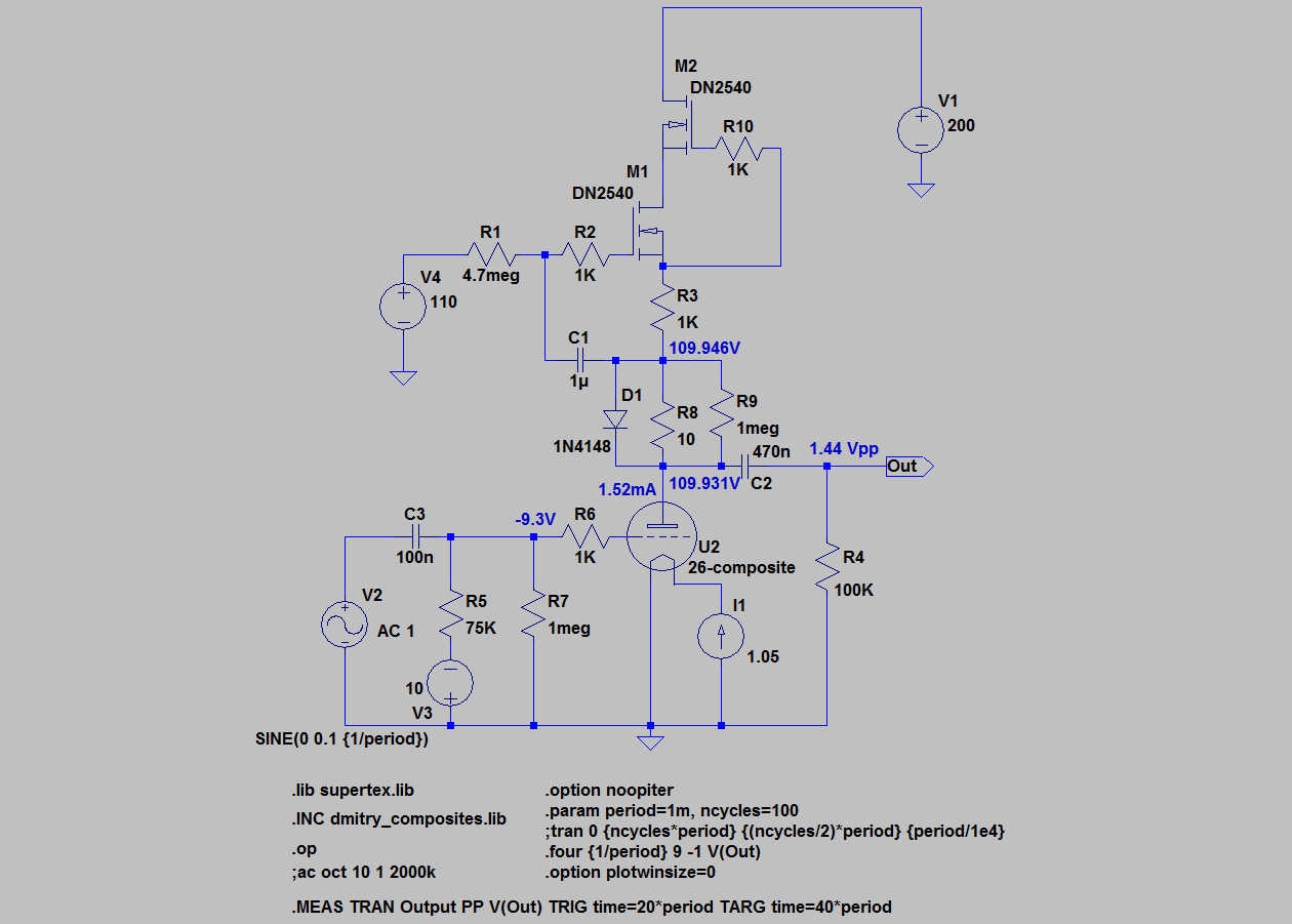

Hi everyone,
I'm trying to adapt my curve tracer to also measure transconductance using an externally 100mV 1KHz feed. As I'm also using a digital panel meter to switch between anode, screen and grid voltage measurement and avoid impacting the grid bias due to the meter input impedance, I changed a simple bias circuit to a simulated inductance (gyrator) to provide a stable DC bias point. That's works (simulates fine).
Now, when I'm adding a gyrator load and placing a 10 ohm sensing resistor in the anode to measure GM using an AC mV panel, when I simulate it in LTSPICE I get very tinny signal close to 15uV
Am I making a basic mistake here?
Ale

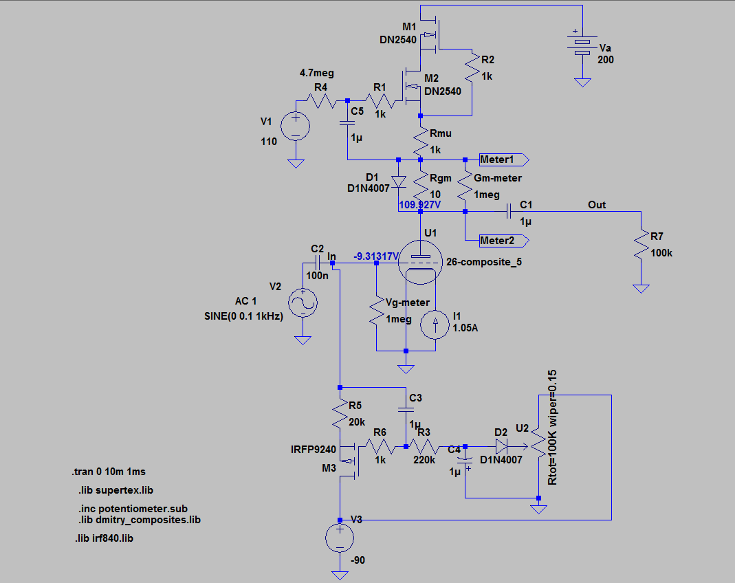

Ale
Yes, it's works, but...
1.) If your negative bias supply (gyrator) not ideal, it makes as divider.
Divider with 1Meg resistor (DC), and divider with signal generator, then shunt input signal.
2.) I think anode current (variation) is to small to measuring in 10R, without amplifying.
