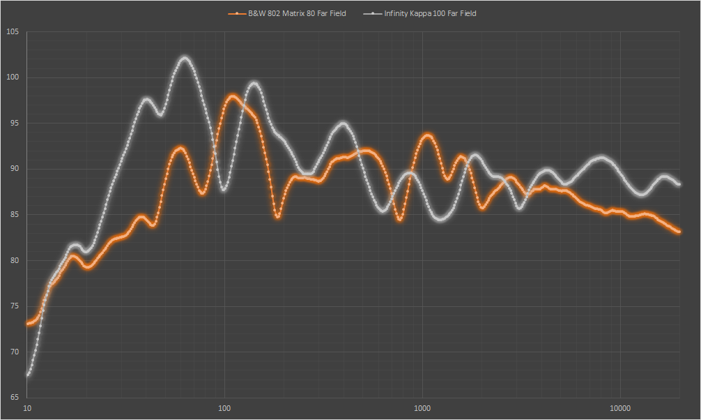

We then decided to measure some well regarded speakers, namely a B&W 802 Matrix Series 80 and a monster 150 lb. Infinity Kappa 100 tower. These are far field measurements, in a more sizeable room (25 x 20 x 10 ft.), with exactly same Omnimic settings for both.
Forget about my friends bookshelves for a moment, since the results (attached) with the B&W and Infinity left us completely confused. What do I see in these results? As expected, the Infinity has likely a better bass and HF responses (no wonder, since it is bass reflex with 2 12" woofers specified down to 30Hz, it is also a 5 way speaker and has at the top an Emit B ribbon tweeter). The B&W is a closed box, so the LF (also 2 12" woofers) rolls sooner.
However, other than that, the same wild response ripple (room reflections?)that don't help understanding the speaker properties in the most audible range of the audio spectra. Besides, where is the huge delta in the efficiency? The Infinity is spec'd at 89dB while the B&W 802 Matrix Series 80 are much less efficient, at 85dB.

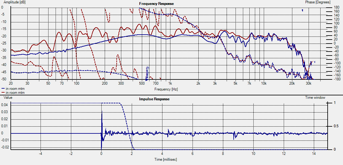

With the Omnimic (I have one also), window your measurement by clicking on the impulse response plot at the bottom. Click at about the 3 or 4 millisec time and place your mic about 1/2 meter from and on the tweeter axis. When you click on the line you should see the line be red from 0 up to the point where you clicked and black beyond that.
Windowing will take out those pesky response ripples. If you still get some, slowly move the mic closer to the speaker with subsequent further measurements to see if they diminish. If they don't, then there's something wrong with the speaker like serious internal reflections or cabinet resonances, etc....
Also, the speaker should be well off the floor and pointed away from any nearby walls, ceiling or other obstructions. If you can't do this, then you'll need to move the speaker to a place where these reflective surfaces are gone.

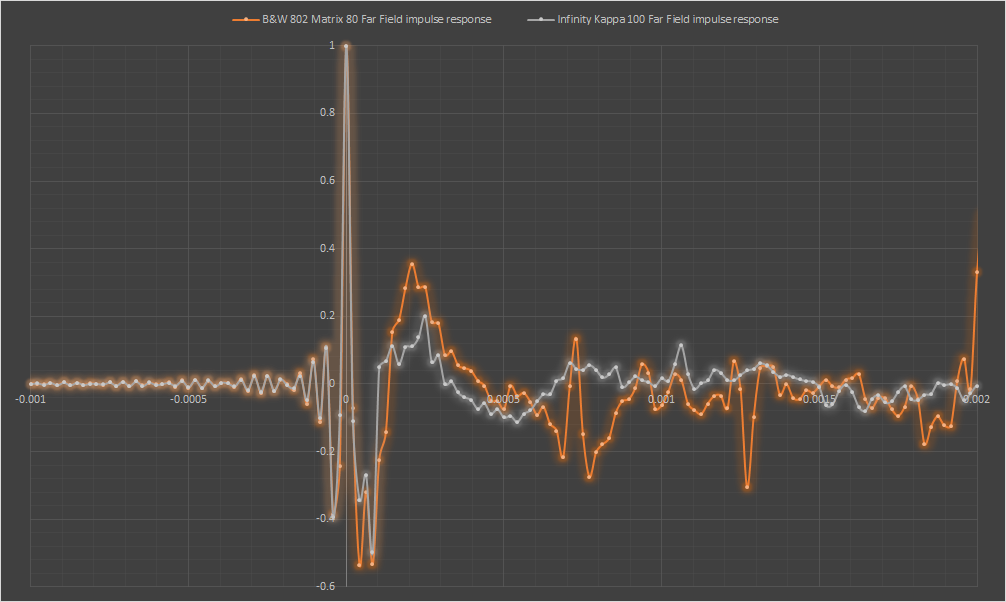

Thank you guys, that helped a lot. Still lots to learn about, I knew it's much harder than designing and building audio amplifiers.

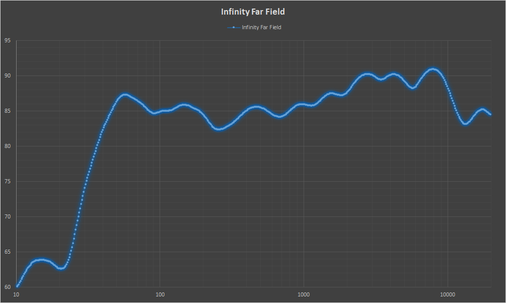

The far field measurement of the Infinity Kappa 100 monster now makes more sense.

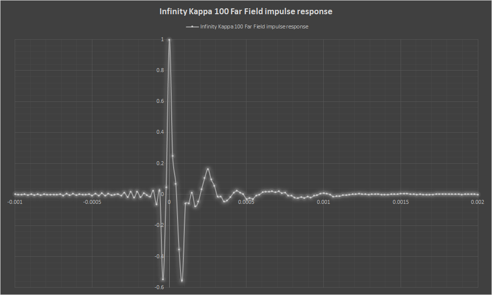

The impulse response is on the ribbon tweeter axis, 2mS window. Is this typical for a ribbon tweeter?

If you're measuring out to 2ms before truncating, the stuff below 500Hz will be meaningless. But you may want to be looking above 1kHz as well- your charts cut off there.

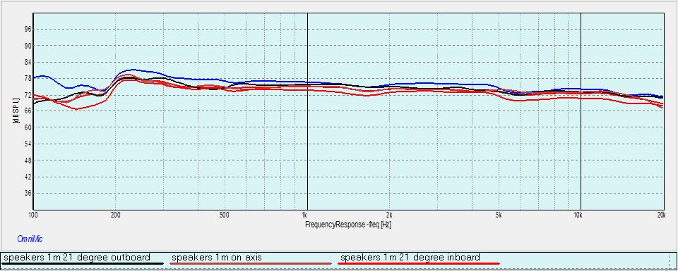

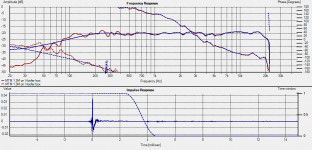

This is a windowed measurement of my prototype speakers using OmniMic to illustrate what a properly windowed measurement looks like. The stuff below 200Hz shouldbe ignored- that's where you take a near-field measurement, then merge it.

Windowing for the merge was 10mS (so down to 100Hz), I corrected, the impulse response is on the ribbon tweeter axis only.

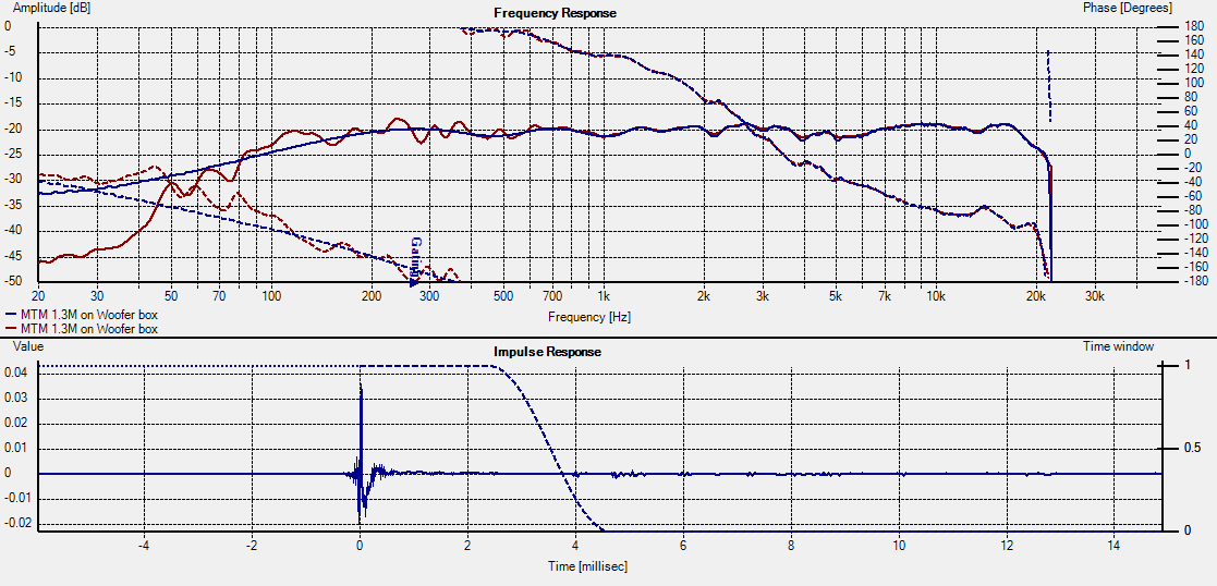

I would suggest that 4ms is probably the best you could hope for in any normal room (and even that is probably pushing it). I can't even get >4ms measuring outside (though I only have a small back yard). :)
Attached is a measurement done outside at 1.3M showing the same measurement as gated, and with 1/8th octave smoothing.
2nd image is the same speaker measured in room at the listening position (with no attempts made to optimise measuring setup. ie was not trying to get quasi anechoic response). again showing gating and 1/8th octave smoothing.
With careful speaker and mic placement, moving furniture around and generally experimenting until you find what works best, you can get pretty good measurements in room, but I would say not far field (in the normal sense of the word). 1M mic distance is the most I would ever try to use in room, and in fact the final measurements (taken outside) I settled on when getting measurements for a crossover at around 300Hz were done at about 0.7M and spliced with nearfield as per the links that jreave has provided.

How do you deal with wind noise outside though? Do you just time it not to be during a breeze?
Yes, try to run the measurement during a quiet period.
Generally outside measurements are limited to frequency response only since the background noise floor is likely to be poor even during a 'quiet' period. If you measure loud enough, the background noise should be a good 30dB or so quieter and really ceases to be an issue anymore. 65dB+95dB = 95.27dB

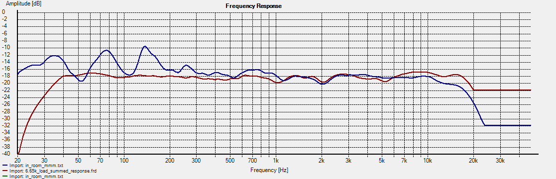

Phase data is the main reason... with the typical curve you get from doing in room measurements if you are trying to do a crossover around 300Hz or lower you are going to struggle getting good phase matching with real measurements.
I tried using in room MMM measurements for doing my crossover design between my MTM's and 10" woofers, but it was not a success. Using the methods linked was much better. even with a CTC distance between the woofer and the tweeter of nearly 0.8M and a crossover frequency around 270Hz I am getting very good integration. MUCH better than I thought would have been possible with such a sub optimal setup. It was just supposed to be a stopgap till I can redo the cabinets for the 10" drivers, but I was pleasantly surprised. Without going to this trouble, I do not believe it would have been a success.
I still have some issues in room. Big (+-5db 1/6th octave smoothed) peaks and dips below 200Hz. That is something I'm not sure would be better addressed in the crossover or through EQ (or ideally through room treatment).
There is a school of thought that the crossover should be neutral and give a good response for quasi anechoic, and anything required to get that good in room should be though EQ. I guess the reason for this is that you will need to redo the crossover if you change rooms, or even if you move things around in your room.
The attached shows the in-room MMM measurement (blue) vs the simulated quasi anechoic response using a 4th order acoustic bessel slope at 270Hz. The fluctuations below 200Hz are too big to be able to do anything sensible in crossover design in my oppinion. I think I have over cooked the bass a bit but I'm only going to back it off by about 0.5db (I added 1db yesterday and it was I think a little bit much).
