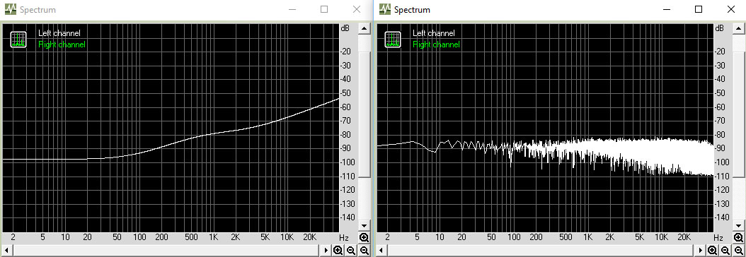

It is incorrect that white noise has most energy concentrated in the upper half of the spectrum.
That may seem to be when displaying the spectrum on a log scale.
However when switching to a linear scale, you can see that noise is evenly distributed all over the spectrum.
See images below lin and log from 20Hz to 20 Khz made with a Scott anti Riaa .wav file played through a Riaa filter.
It fully confirms without confusion that the noise used was white and that the anti riaa correction was well done.
Hans

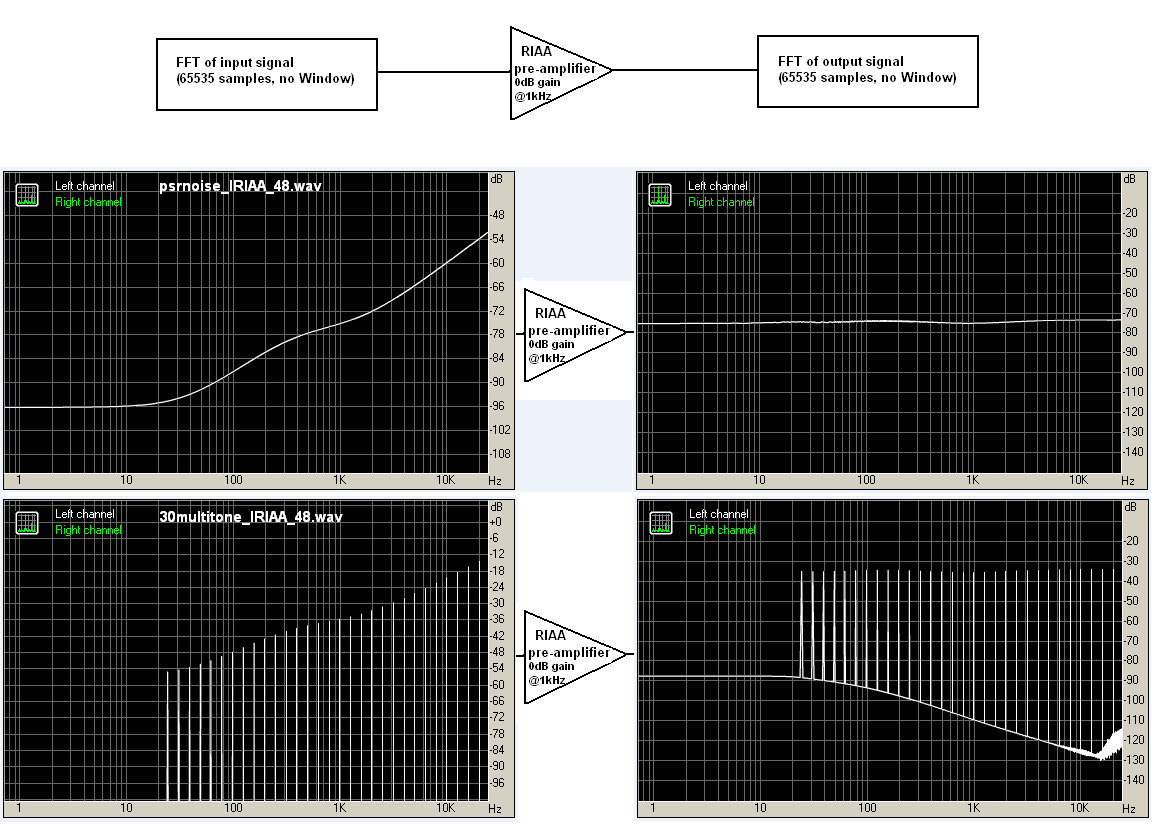

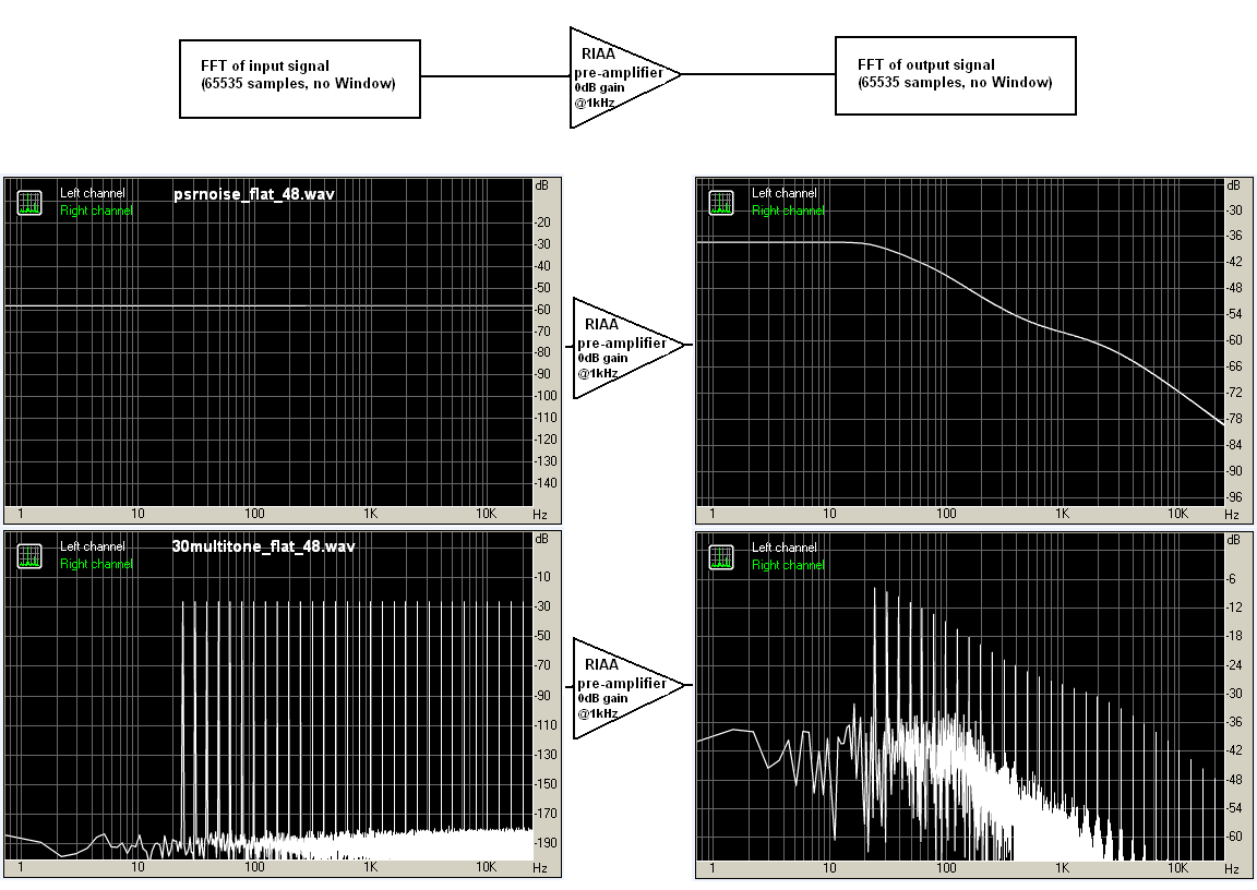

Well, if helma has been confused, following the simple approach I suggested in post# 3, he should expect these results (see attachments)
Scott’s files can be downloaded from Linear Audio site, download section (thank you Jan)
https://linearaudio.net/sites/linearaudio.net/files/psrnoise_flat_48.wav
https://linearaudio.net/sites/linearaudio.net/files/psrnoise_IRIAA_48.wav
https://linearaudio.net/sites/linearaudio.net/files/30multitone_flat_48.wav
https://linearaudio.net/sites/linearaudio.net/files/30multitone_IRIAA_48.wav

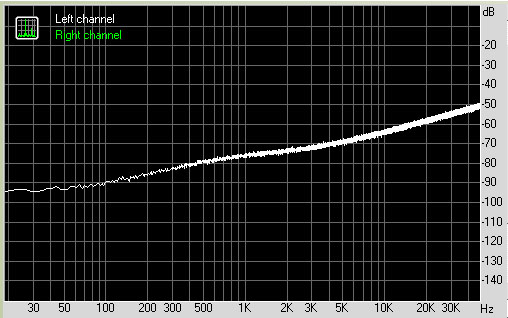

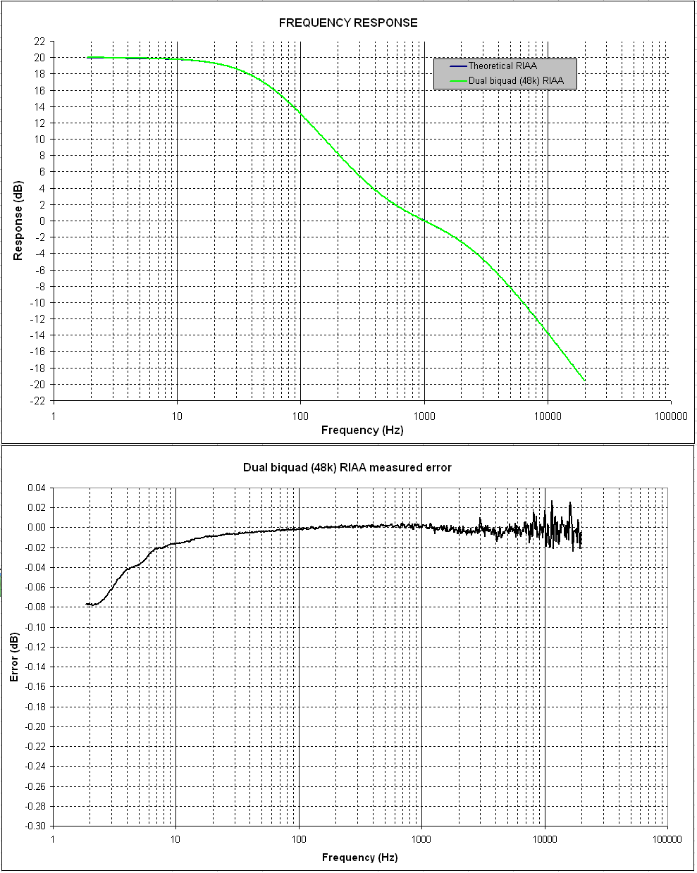

My 2 cents- trying to measure RIAA accuracy directly requires a measurement system of wide dynamic range and little noise. Though it can be done, it's a fool's errand if you're looking for 0.1 dB or less
Hi Conrad.
It can be done. Care only not to overload the preamplifier.
Link is from real measurement using soundcard recording.
DUT is a 2x4miniDSP module acting as a RIAA equaliser. Max output level is 0.9Vrms
http://www.diyaudio.com/forums/atta...ing-vinyl-2-dual-biquad-48k-riaa-response-png
George
>Edit
Here is the source post
Digitizing vinyl
Please visit also this post for details about how the measurement was done (essentially, like jaddie has outlined in post #27 above)
Digitizing vinyl
George
Hi George,
How did you produce your smooth Riaa corrected curve from Scott's IRiaa curve.
I used LTspice to send Scott's 96K file through a Riaa filter and produced a new 96K .wav file from the result, but you obviously used a different approach.
With a 65K FFT, my results are in the left image below, before and after Riaa.
But I have a problem in understanding RMAA, because when taking a 32K FFT from Scott's file, thereby doubling the filter bin width, see image at the right, I would expect an even smoother image than the 65K FFT image at the left.
Unexplicably this is absolutely not the case ??
Hans
