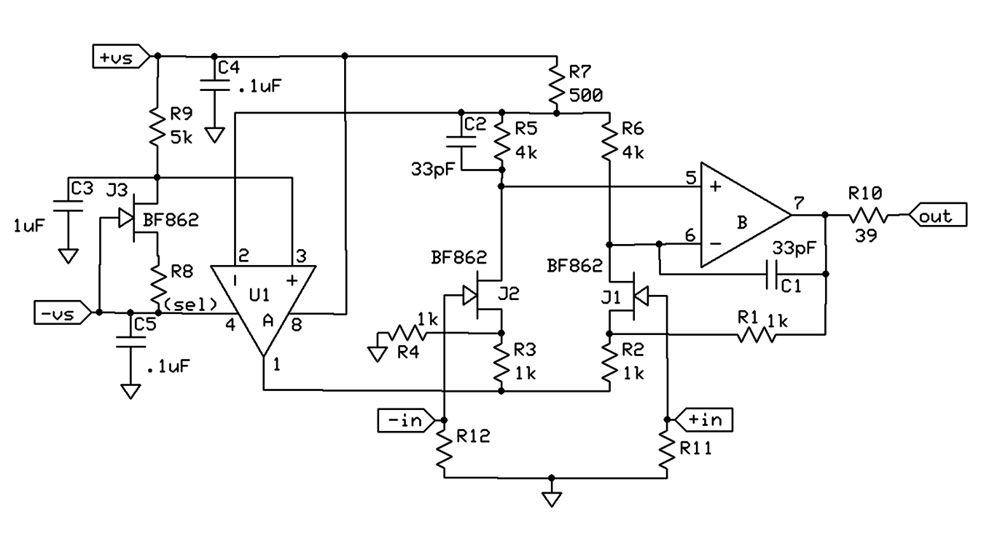

For maximum versatility you could use an instrumentation amplifier. There are many already available or you could build this little circuit. The FET's need to be matched or you need a big AC coupling cap in series with the gain resistor which goes between the sources of the input FET's.
I wonder if you've given more thought to that circuit (post 17) after writing up the two-part Linear Audio articles on microphone preamplifiers. I've built a couple versions with both BF862 and K170 and an LME49720 opamp.
I recommend the transistor matching device you showed in the LA article.
