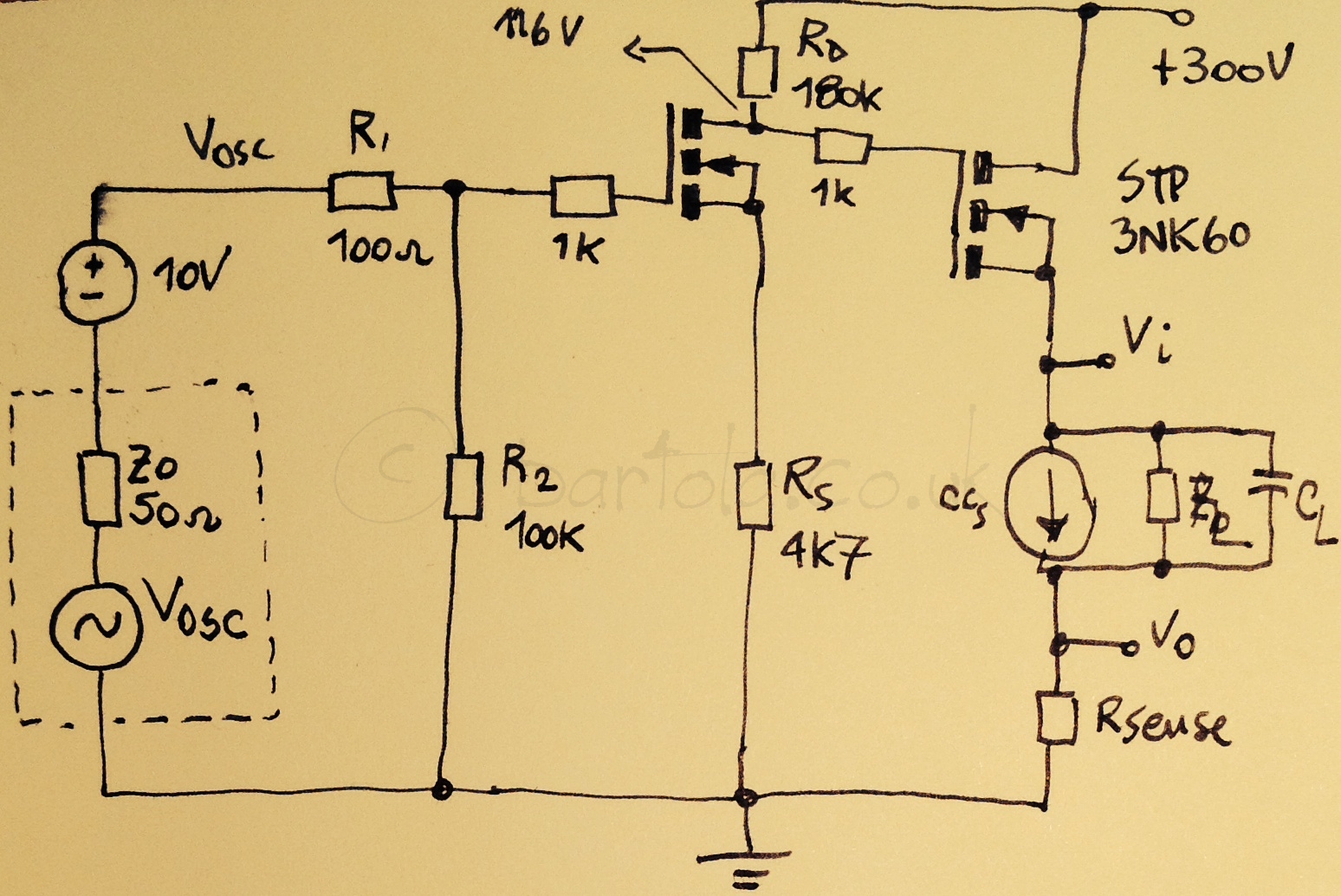

Ale: Try this -- you won't blow up your signal generator --
It's basically a HV inverting amplifier --
because the MOSFETs have reactive components you have to make a measurement with Z=R(real) for a baseline of magnitude and phase, then take the measurements with the device under test and use complex algebra to calculate the reactive impedance. Audio Precision has a macro for this on their website written in the AP version of VBasic.

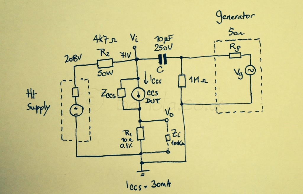

Ok. So here is what I'm planning to test. First the circuit for CCS measurement:
This will work fine I suppose. The gain is about 40(32dB) and should deliver 120Vpp to the CCS. I could measure then 115dB with averaging on the oscilloscope or with the PC audio interface. With a single supply the CCS current will pass through the sensing resistor and I wouldn't be able to use my 60dB differential preamplifier. Any ideas to avoid this?

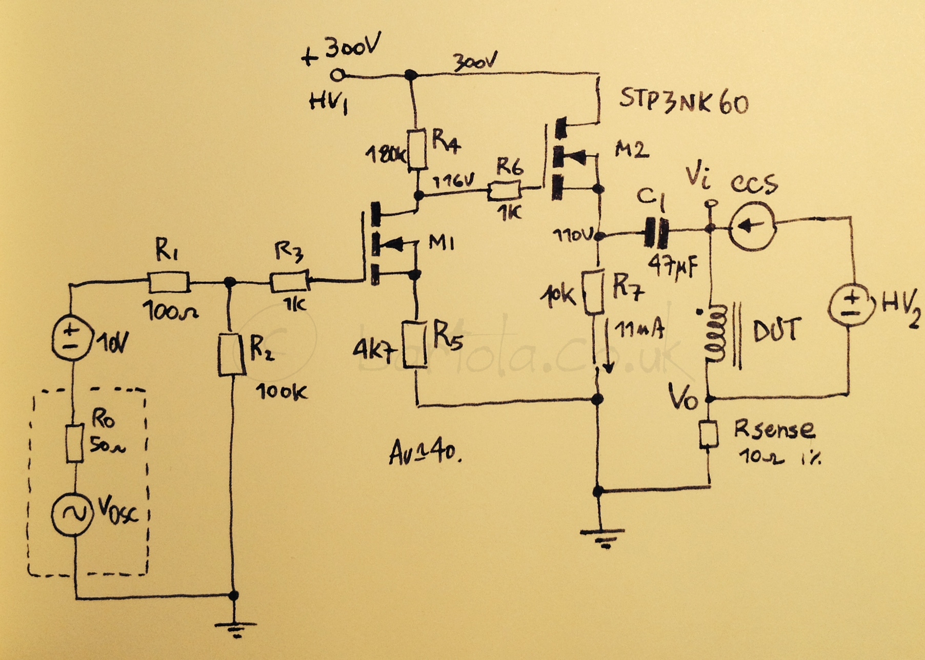

I guess I could use a similar arrangement as the one shown below which I was planning to use for measuring choke inductance (or transformers):
This way the load current doesn't go through the sense resistor. It requires a second power supply as a downside.
