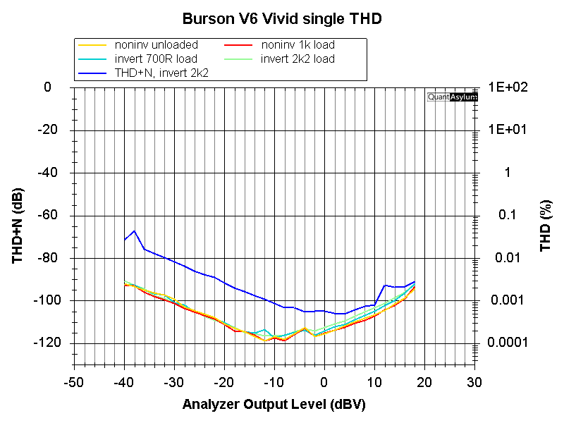

I've measured its distortion performance using the QA403 audio analyzer and here are the graphs, first distortion v. level for both inverting (gain=-1) and non-inverting (gain=+1) topologies:
Clearly this opamp has decent (but not world class) distortion performance. Powered at +/-15V. 600 ohms load seems to be handled in its stride.
Alas the power consumption is a massive 13mA with no signal (the only pitiable specimen of a datasheet I could find claimed 8mA). That same datasheet only claimed 0.02% for distortion, which perversely under-sells it - perhaps the datasheet is not for the Vivid V6?
Little bit let down at higher levels, but most practical uses will be somewhere in the 0 to 10dBV range.

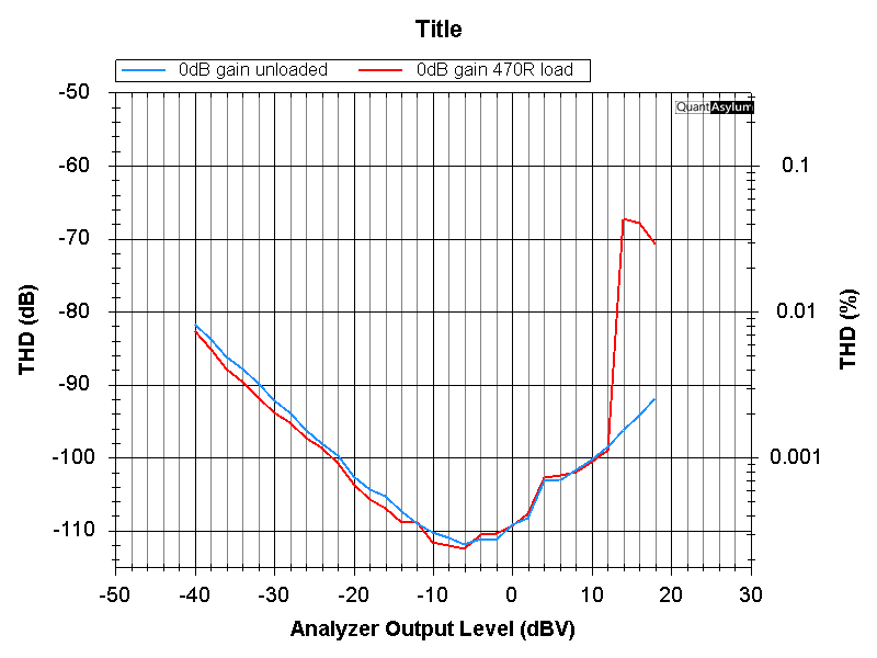

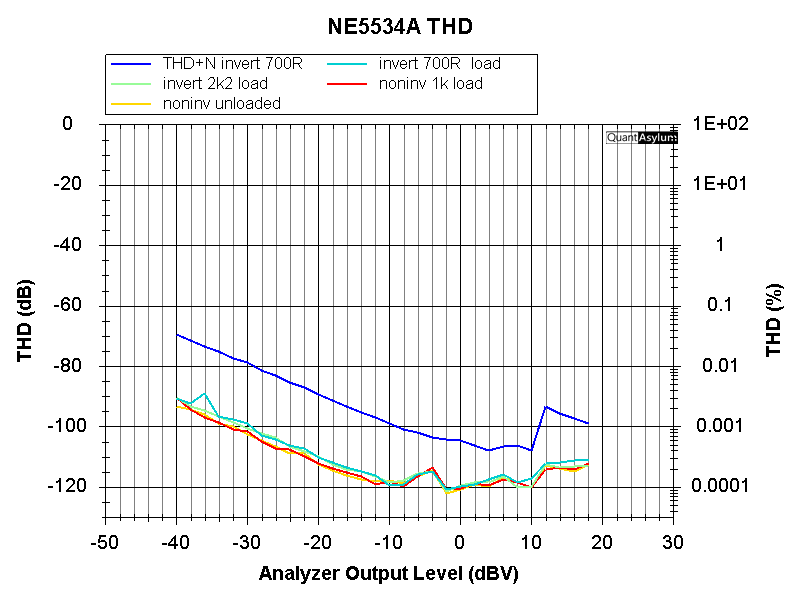

I've just compared the Burson to a discrete opamp (basically a Blameless style circuit, 10 transistors) that I knocked up on a breadboard using KSC1845's and KSA992's:
Mine above clearly isn't so good with 470R load at high levels, but is generally lower distortion and much less noise - from this graph's noise-limited segment I estimate the noise of mine as -123dBV, the Burson -102dBV (although I'm not sure of whether the QuantAsylum window noise bandwidth is factored into these values, so the absolute value is probably different).
So the V6 Vivid is clearly a noisy beast (voltage noise to be specific) if its 21dB worse than a bog-standard Blameless input section...
I might rerun the Burson tests to check I didn't make a mistake as its so different.

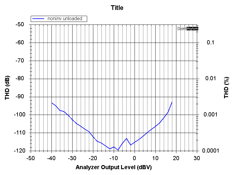

Ah - there was something definitely wrong with my last Burson measurements - here's non-inverting unloaded graph I've just remeasured - much more like it, noise is NOT an issue with this device (not sure where it came from last time though...perhaps inadequate decoupling or pickup from surroundings?)

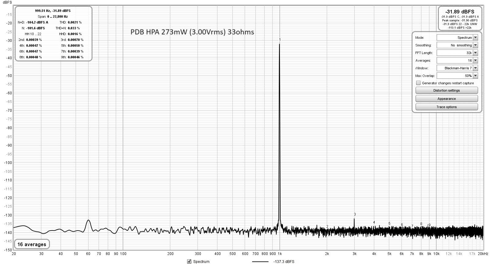

The side topic here that is interesting is that the NE5532's are getting some love here. I had a board house assemble my latest headphone amp spec'd for OPA1642's, but they didn't have those in stock so I opted for NE5532's (plenty in stock). They actually sound great and measure well too. I was thinking of removing the factory installed 5532 and installing some 1642's, but maybe no point in it. Here is 3.0Vrms into 33ohms (NE5532 driving a diamond buffer output stage):
