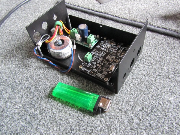

Measurements of an ES9023 DAC
the chip will perform very good and better than CS4397.
Well, it probably already does perform better, but it is let down by flatcable connections etc. I'm working on a ES9016 design, that will replace the CS4397 dac permanently. This ES9023 design is just to get some experience.
One thing that wonders me is the input impedance of the amplifier. If it is low that could explain a part of the difference in buffered/unbuffered configuration. One can understand that the JG buffer is a good combo with the ES9023. If I still could buy the matched FETs I would build one too.
Amp is a Kenwood L01a, according to specs, input impedance is 50k, which is not that high, but quite "normal". The difference between buffered and unbuffered was to be expected, because the opamp inside the ES9023 cannot do miracles. But I cannot put a finger on the reason why the dual supply version is an improvement without the buffer, but performs equal compared to single supply with buffer. Perhaps the charge pump inside the ES9023 doesn't deliver enough current?

Last Friday, I experimented some with stacking of ES9023. Don't whether there are any posts on this topic on Diyaudio.
I just soldered two ES9023 on top of each other, leaving the CP/CN pins unconnected. The MSCLK pins are not directly connected, both have their own 100 Ohm resistor. I left the no-audio pin disconnected for the top DAC chip. All other pins are directly connected. The chips get a symmetrical supply (-3.6V and +3.6V)
It works without any problems.
Initial impressions are:
- Larger soundstage (perhaps bit too large, "virtual surround" like)
- Less bass
but the second chip is brand new, so I must repeat tests after 10 hours of burn-in.
Any comments on the way to merge the output signal of the two ES9023 dacs? Like giving both dacs their own passive LPF, or even separate buffer stages.
Or does someone know of a simple way to split L/R signals in the I2S stream? That would definitely improve the cross-talk performance.
