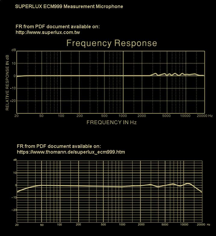

Anyhow, when I searched the web for some month ago I came up with another measurement microphone which comes in a "ready" package, the mic is Superlux ECM999
Can be ordered from Thomann and other places for a bit under 40€
Superlux ECM999 - Thomann UK
Have seen these also on AliExpress but at no price advantage.
Seems like the Superlux microphones are originally from Taiwan.
http://www.superlux.com.tw/index.do
ECM999
Superlux - ECM999
Sensitivity: -37dBV/Pa (14mV/Pa) 1Pa=94dB SPL (at 1,000 Hz Open Circuit Voltage)
Rated impedance :200Ω
Minimum load impedance: 3,000Ω (Obs! in the PDF it says min. 1kOhm)
Equivalent noise level: (A-weighted) 22dB
Max. SPL (1 kΩ load) :132dB SPL (THD≦1% 1kHz)
Dynamic range (1 kΩ Load) :106dB
Environmental conditions:
Polarity: Pin 2 output positive voltage (related to pin 3) when diaphragm receives positive pressure. (Diaphragm moving inward)
Connector: 3 pin male XLR type
Finish: solemn black finish
Weight: 150g (5.30 oz.)
Current consumption: 0.5mA
Noise ratio-to-Signal :70 dB
Power supply :9~52 V Phantom
Dimensions :Φ21.0x193.0mm (0.83x7,56n.)
Frequency Response :20~20000Hz
I noticed there's some discrepancies on the frequency response given in various PDF's for ECM999, see attached picture. :(

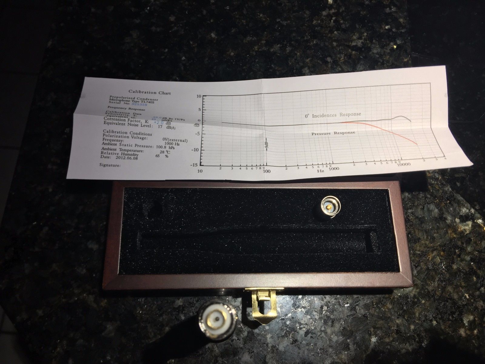

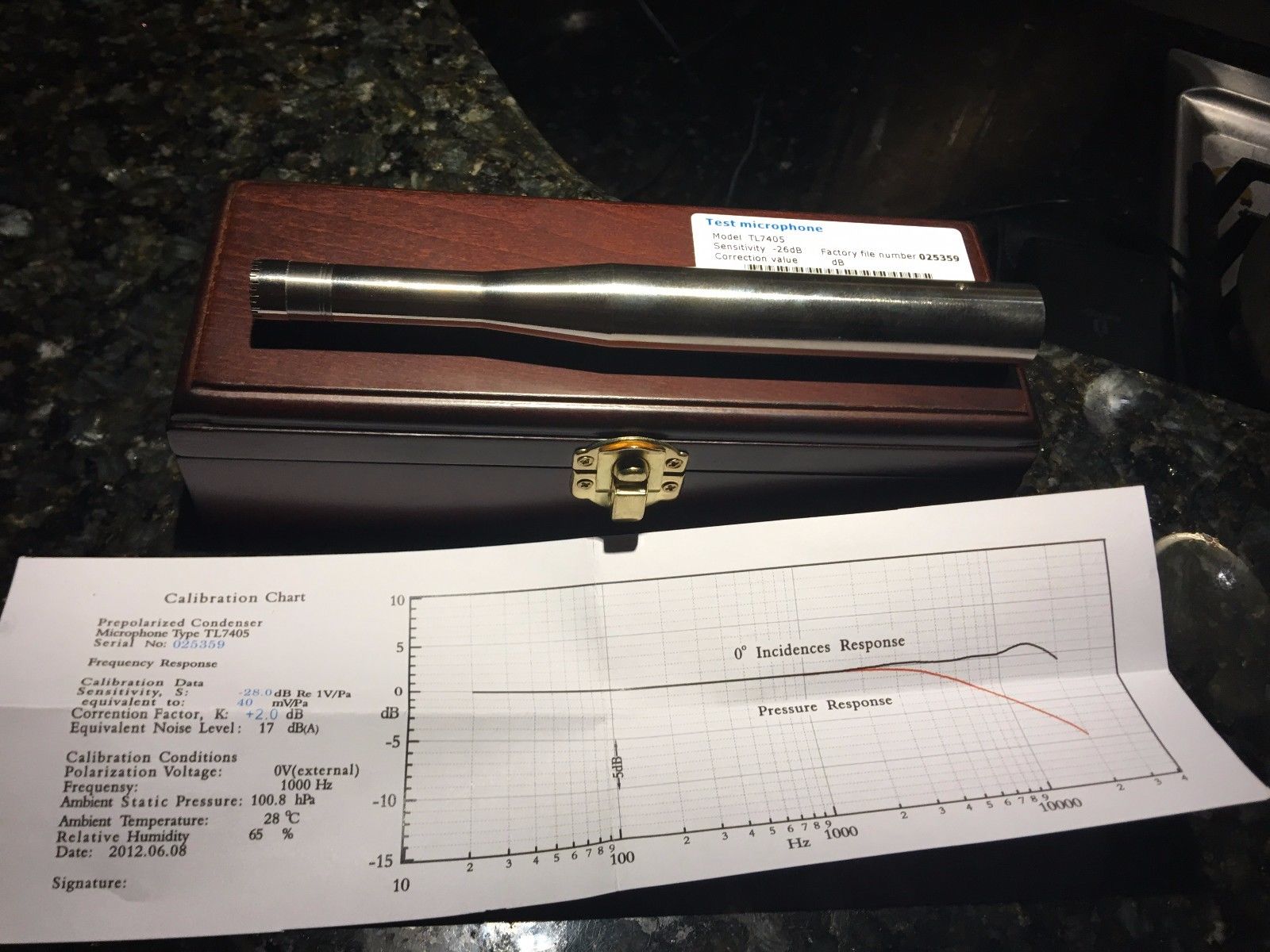

Some day ago skimmed through eBay for calibrated mic's, just thought I would attach some pictures of an "interesting" case, the asking price was ~700 US$, but as one can see from the calibration graph the mic (Type TL7405) has a 10dB droop from ~2kHz and above, ie. not much better than one of the electret capsule I found earlier, maybe this one has other qualities?

The upper curve is the correct free field response (what you normally do for speakers). The calibration is using an electrostatic actuator which creates the equivalent of a pressure response. The difference is due to the physics of the size and shape of the capsule in free space. The mfr has a specific correction curve for the microphone diameter and the electrostatic coupler based on the physics.
Any microphone disturbs the sound field around it. The B&K mike book has a good description of the phenomena. https://www.bksv.com/media/doc/be1447.pdf Section 2 I think. Lots more than you may want to know.
