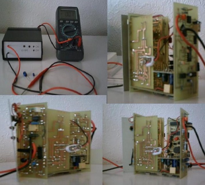

I am going to link a couple of capacitor threads to this. This meter was based on a design published by Cyril Bateman around 10 years ago. It measures the "goodness" of electroylitics, not the value, not the E.S.R. , it's much better than that.
So what is Tan Theta. Well Tan Theta = ESR/Xc put simply.
Some results then,
A "Nover" 47 mfd 16 volt cap gives 0.107. A Panasonic ECA 47 mfd 16 volt gives 0.068.
A Jamicon47 mfd 50 volt gives 0.035. A "value" 47 mfd 16 volt gives 0.106. A rubycon 47 mfd 100 volt gives 0.018.
A Gemcon 220 mfd at 16 volt gives 0.056 and a Panasonic ECA 220 mfd at 35 volts gives 0.056.
The lower the better !!! So those Panasonics are pretty good, that Rubycon exceptional.

It was in Electronics World January 2000 for the final design. I think there was a kit at the time.
I cheated with mine, made it using what I had available, and didn't use the recommended 7106 DVM IC for a display device. Made mine as an add on to a multimeter, which involved designing a log/antilog circuit, but it's fine. I built it for a bit of fun really.
If you would like a copy of the original circuit email me.
