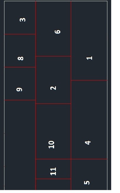

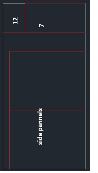

here are al the fractional dimensions,and 4 printfiles.
make sure they do a 1:1 copy
you can check this with the dimensions from the pic .
you can take every dimension from the prints(print model 3 is ideal situation,its up to you how accurate you want to make that)
also draw some bracing on it ,you can also trace that from the print.
print 1
print 2
print 3
print 4

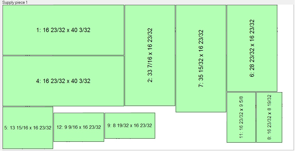

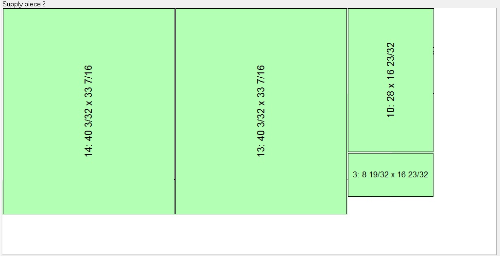

make the top (first 2 parts of the horn)first,then mout this with the rest of the horn.

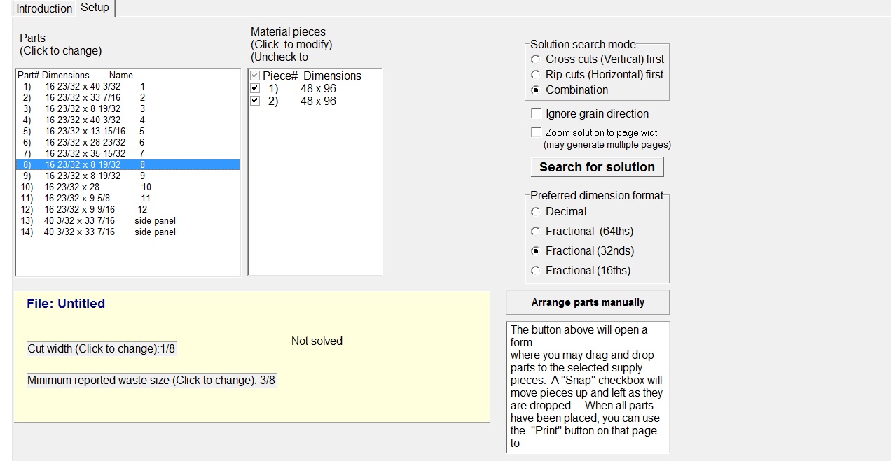

set the saw table @ 16 6/16(42,5cm) wide and cut al those pannels so they are al exactly the same width
Epa you make the cutlist to be print out as a template.
Epa the largest size paper the copy center print is 36x48
its 35*41 so it fits exactly.
the rest is up to carpenter with his tape measure
Epa thanks alot for every thing. It is time to make this project a reality.

make sure the printfiles are correct/check it with the dimensions on post 143.
also print out the pics in post 143 and 145 and they can take all measurements from the print files and also the pic in 143.
make sure all pannels are the same cut/width(so 16 23/32 ,it doesn't matter if its 16 6/8 ,as long they are all 16 6/8 ,so the side pannels wil fit without gaps)

Cutlist
After you finish watching soccer can you take a look at this cutlist and let me know if it is correct.
