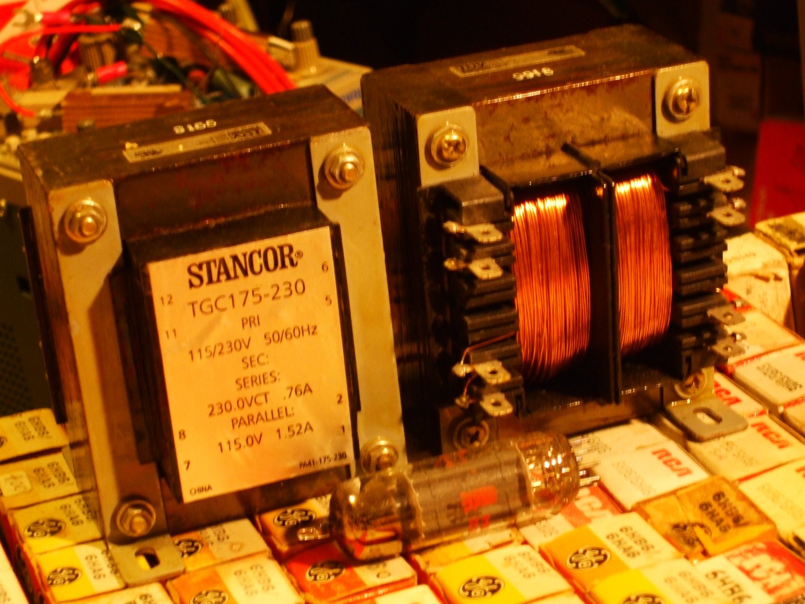

I have almost all the parts to build a Circlotron on the shelf here. The floating B+ supplies can be done cheaply with some Stancor TGC175-230 industrial xfmrs (or the many equivalents around). These have dual 115V primaries and dual 115V secondaries. Those are placed on a split bobbin, with only 69 pf capacitance between primaries and secondaries. (low C is important) 175 Watt each. I don't have a 600 Ohm OT however, but I have some large toroid cores and some moderate C cores that could be wound up.

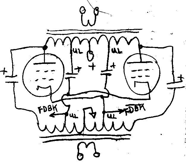

I'm more likely to just use the Elliptical Twin circuit with an Edcor OT though, less % CFB. (28% CFB using 40% UL taps: .4/(1+.4))
If one uses the driver tubes in pentode mode, then bootstrapping can (effectively) eliminate the output stage CFB altogether.
Don't really need the CFB with the Crazy Drive outputs and some local feedbacks (from the output cathodes) to the driver cathodes.

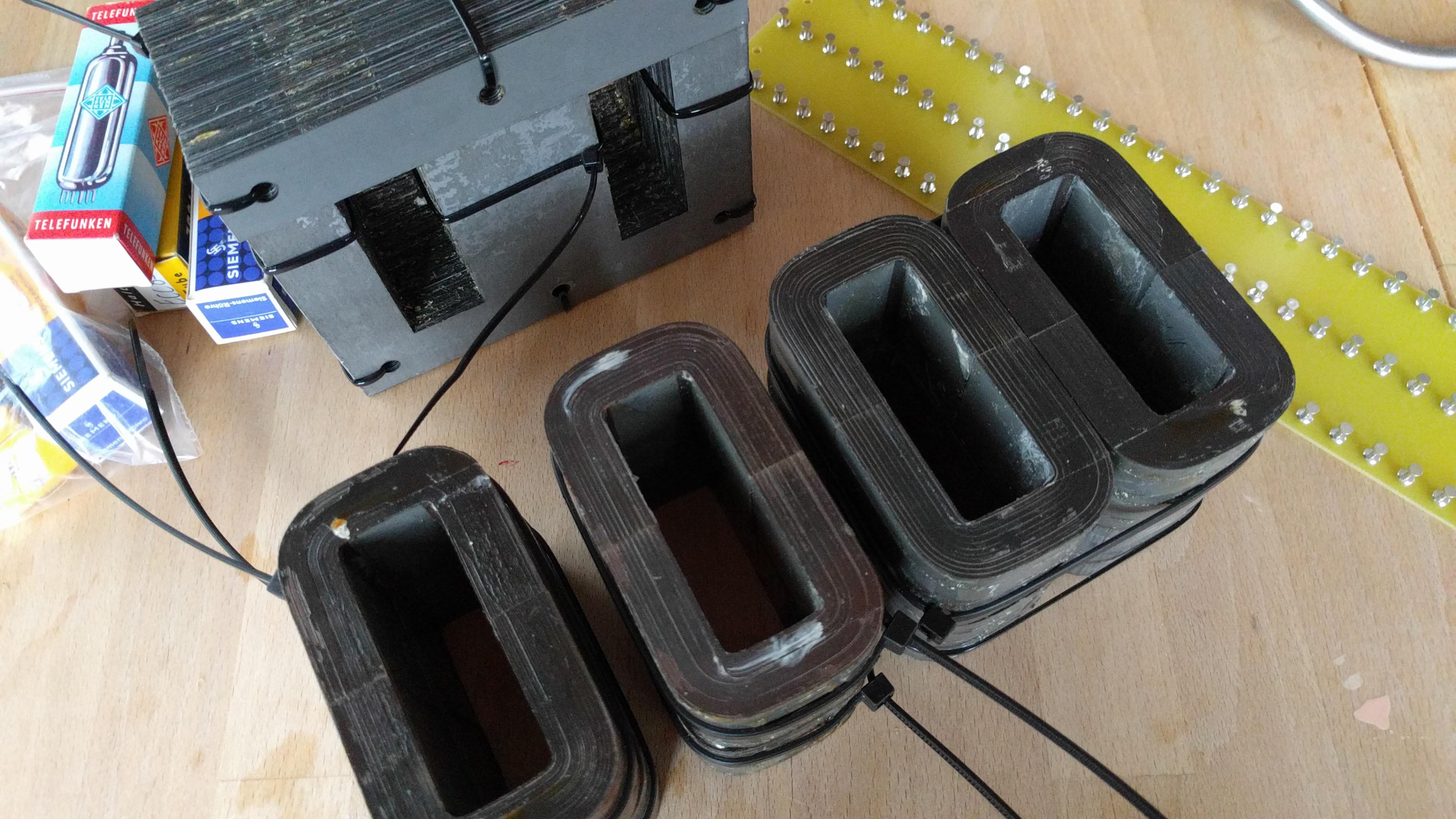

Well here is a picture of the hardware i found the latest years
C cores with a total center leg of 20cm2, not as big as they should be (hope is that they can deliver about 58w). EI 130 laminate for the power supply.

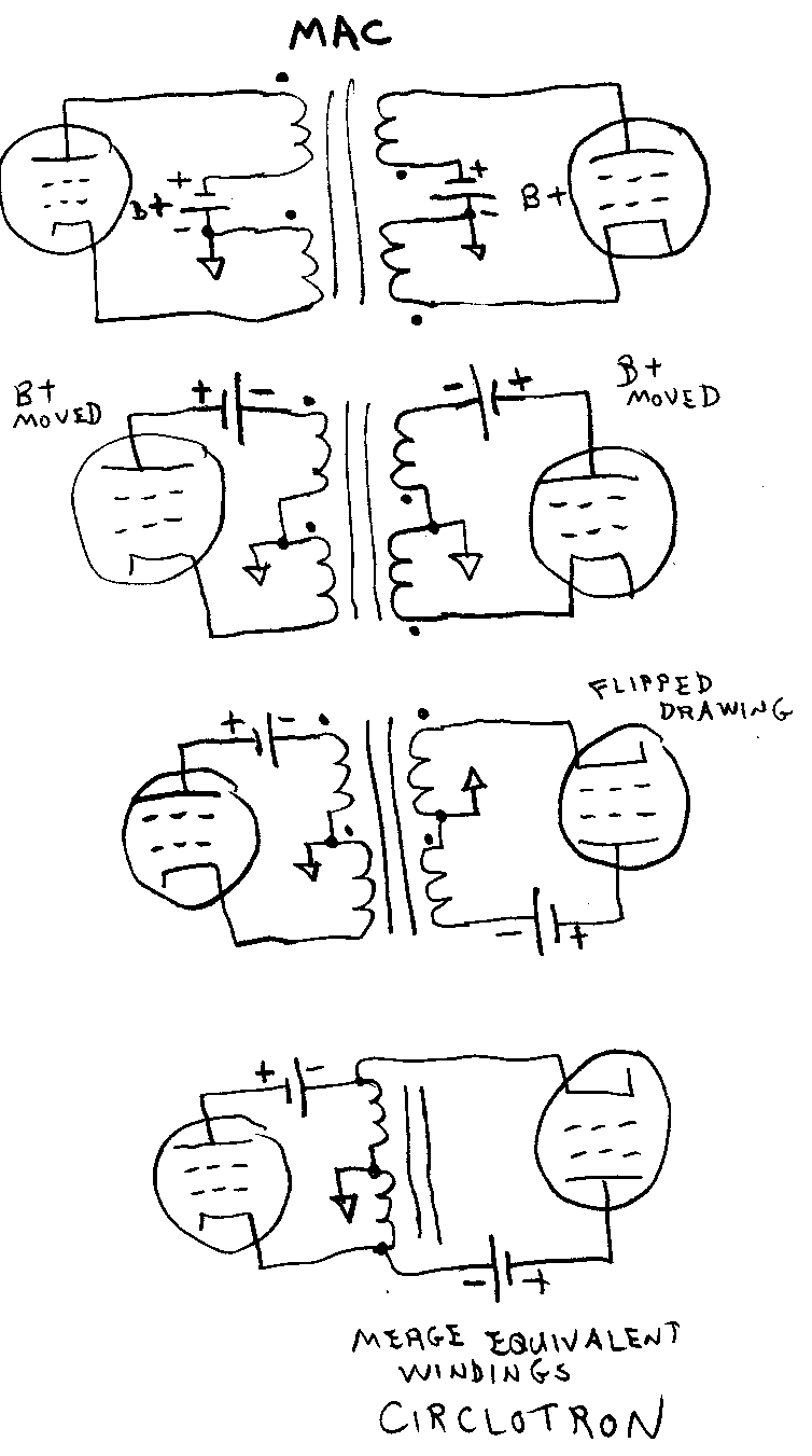

Equivalence of the Mac circuit to the Circlotron circuit (secondary left out for clarity):
Just the B+ battery getting moved. No longer any dangerous B+ across adjacent bifilar wires. OT is at ground DC potential in the Circlotron. Same AC peak current carried in the winding, so wire does not need to be bigger. 1/2 the bobbin area saved. Reduced leakage L and distributed C.

Agreed. The output voltage swing is the change in Va-k. The fact that the voltage swing is being divided into two coils is unremarkable. The same thing happens in any amp with cathode feedback. The Mac output stage is a 50% CFB amp with a unique circuit arrangement and winding that makes the capacitance between the coils a non-issue.
