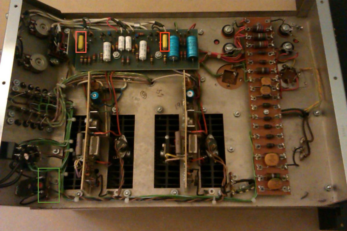

Shown is the underside of the MC250. Highlighted are
two of the Mylar caps, they generally don't need changing
but the electrolytics should be replaced.

Caps used by ahankinson include the following:
No, I didn't want to touch too much, so I just replaced the caps. Here's the digikey parts numbers I used:
4000PHCT-ND
CAP ALUM 470UF 6.3V 20% AXIAL
CUST REF #: C11, C12
493-3190-ND
CAP ALUM 100UF 25V 20% RADIAL
CUST REF #: C51, C52
493-10824-1-ND
CAP ALUM 10UF 25V 20% RADIAL
CUST REF #: C53, C54
493-13368-ND
CAP ALUM 1000UF 25V 20% AXIAL
CUST REF #: C55, C56
http://www.digikey.com/short/7dt04n
Check the electrolytic capacitors on the input board they have
a tendency to open. --anatech
Also trace the audio signal through the amp using a signal generator
at the input and follow it through the amp comparing left and right
channels.
Use 1Vp-p signal and adjust for no clipping. Find the problem
area.
