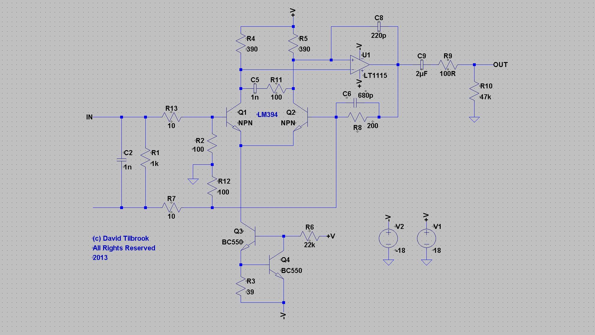

Hello SuperTuck,
If I was designing this circuit now I would do things a bit differently. Here are some suggestions for upgrades that you may find interesting.
Firstly it is possible to remove the input capacitor entirely by going to a balanced input topology, as shown in the circuit diagram. Normally the input coupling capacitor is needed, when using bipolar junction transistors, to prevent the input transistors' DC bias current from flowing through the cartridge. Provided that the input differential pair is very well matched (and it will be with the LM394) the balanced topology shown ensures that DC current in the cartridge is reduced to acceptable low levels. The downside is a small increase in noise, due to the thermal noise of resistors R7 and R13, which can be decreased if you need more gain. With the values shown gain is 26dB, well below that provided by the original circuit, but suitable for most medium output MC cartridges. Reducing R7 and R13, to 5R for example, will decrease the contribution to the noise from these resistors by 3dB. In any case, the noise performance should still be very good.
I think the op-amp should be upgraded to a modern pin-compatible device. There are many potential candidates, but the LT1115 form Linear technology is a good place to start. Changing op-amps has the potential to make these types of circuits unstable, depending on the high-frequency phase characteristics of the device, but with the LT1115 the only change that I think is necessary is to add a 100R resistors in series with the 1n capacitor C5. I am 99% certain that the circuit will the totally stable, but I do not entirely trust the SPICE models I have for the LM394. So if anyone can post a SPICE model for the LM394 they are confident is accurate, I can double check this. Capacitor C7 was required because the NE5534 is not unity gain stable, and should be removed if you are using the LT1115.
Assuming that the output load is 47k, the output capacitor can be reduced to 2uF, in which case a high quality audio grade capacitor can be used such as a metalised polypropylene or better. R10 is shown as 47k on the circuit, but simply provides a ground reference for the output side of C9. It can be increased as necessary, depending on the input coupling of the following stage. Alternatively, both R10 and C9 can be removed totally if the following stage is ac coupled and permanently connected.
With the values shown the input impedance is approximately 1k//200R, as determined by R1, R2 and R12. I have found that 200R is a good loading impedance for a large number of MC cartridges, despite the recommendation of some cartridge manufacturers for lower load impedances, in which case R1 can be removed. Capacitor C2 is for cartridge loading, and can be changed to suit your particular cartridge.
There are various other resistor changes as shown on the circuit, but it is sufficiently close that it can be built using the same PC board.
You mentioned that you will probably be making shunt regulators for the preamp, and I agree that is a good idea. I would increase the supply voltage to the +/- 18 V shown on the diagram (but not higher if you decide to go with the LT1115).
With these changes this should be a very good MC preamp. The frequency response at low frequencies will be 3dB down at less than 2 Hz and extend to over 1MHz. THD and IM should be unmeasurable for a gain of 26dB, and will remain extremely low even at significantly higher gains, and noise performance will be comparable to the original circuit. Although I have not built this particular circuit, I have had many hundreds of hours of listening tests with a very similar, although fully discrete circuit, with a similar topology, which sounds very good.
In any case it would be an interesting experiment to do. If you decide to try it, please let me know how you go.

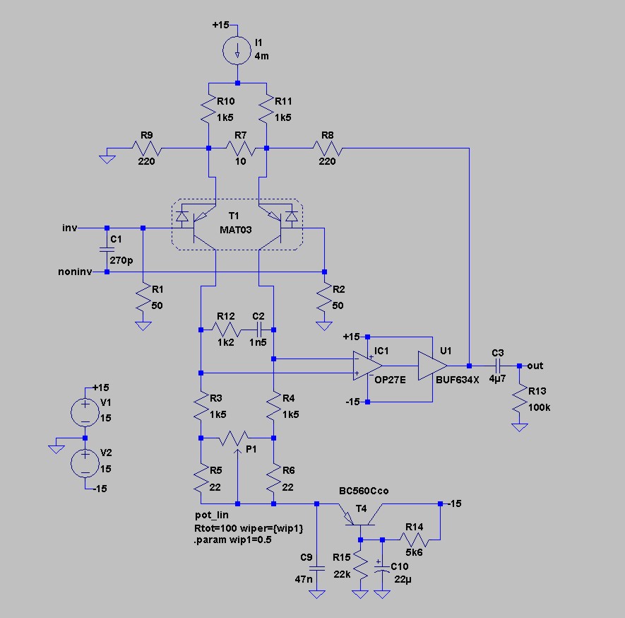

I´m not quite sure if the feedback configuration in #6, in that inverting input and feedback meet at the input/Pickup, is really working as intended.
It must be taken special care with the delicate coils of MCs that no, or at least safely small, currents are injected into the pickup.
I didn´t check the circuit on that, but will the cartridge be safe any time even at switch-on/off, or could the Opamp drive lethal currents into the pickup?
Attached is a slightly different configuration (here shown with the bipolar PNP MAT03, which has a slightly lower noise voltage figure than its NPN counterpart MAT02 but basically the same structure), which breaks up the feedback and input part, by connecting the feedback to the input transistors´ emitters. Now only the input bias current mismatch of the transistors Gates may ´stress´ the pickup coils.
With the bias current already in the low µA-range and a specced current mismatch of 3% any cartridge should be safe.
Also a Buffer is added behind the OPamp. The Opamp alone is not specced for such such low load impedance as R8 here and in #6.
It´ll probabely suffice without the buffer due to the small signal voltages and current demands, but current requirements of the feedback loop and the Opamps current capabilities should be considered.

Correction to my post re input impedance.
Re-reading the thread I see I made a typo in my original post. The input impedance, of course, is 20 ohms not 200 as I incorrectly stated. The gain is around 28dB with zero cartridge impedance, dropping to around 26dB with a cartridge source impedance of around 5 ohms.
If higher input impedance is required, it is also possible to introduce an asymmetric pseudo-balanced input topology, which still results in minimum bias current flowing in the cartridge. My notes on this are still buried in boxes after moving house, but I can dig them out if needed.
