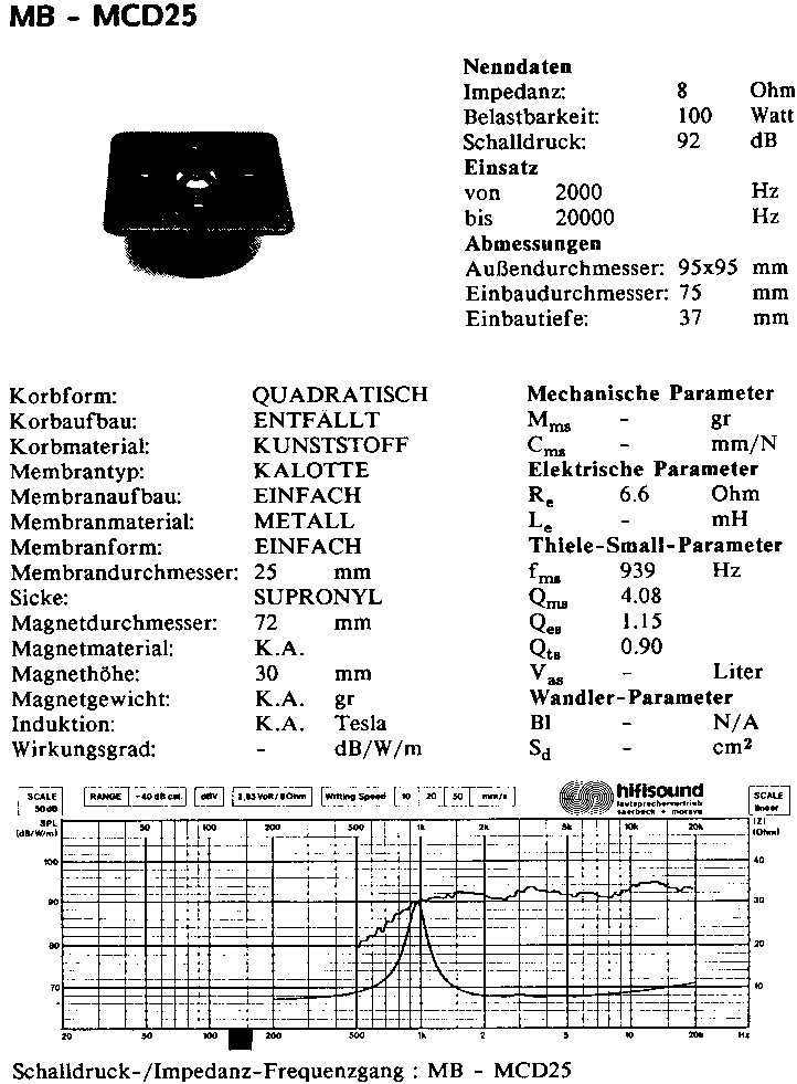

I found an old book with data about it:
Just note that the Qts of 1.56 tells me you have to careful and
take this into account when designing the crossover.
There is also likely to be a high impedance peak at resonance.
However if you pad it down for level matching using a series /
parallel resistor combination the parallel resistance will suppress
the impedance peak.
But not the frequency response peak due to Qts.
:) sreten.
