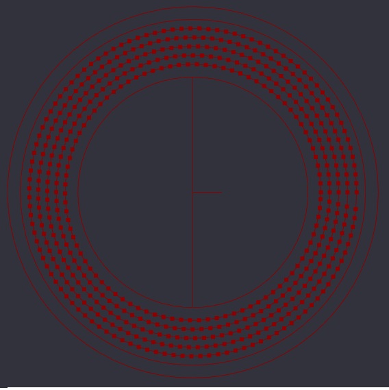

Maybe a stupid esl shape ?
well i was looking at some 17 cm woofers i still have laying around, and thought about using pcb material as stator, on thing possible with pcb (or at least more easy) is creating abnormal shapes.
so i thought of a sort of ring esl around my 17 cm woofer. the membrane is 3.5 cm wide, so dispersion should be pretty ok.
if i can trust sketchup i still end up wiht about
0.025545 m2 of surface. wich is as much as a 7 x 30 cm panel.
diameter of the panel is 18 cm and all the dots in the image ar drilled 3mm holes, i then remove coper around this hole to prevent arcing 4 or 5mm diameter. i then put the ring around the woofer. (this would have some consequences for the cassing of the woofer ofc)
Could this work? i remember that circular membranes where not the best, but in this case its not really a circle because the middle is not there.
i hope to be able to cross it around 2 or 3 k just like a normal 2 way design. maybe its even possible to lower that.
it also becomes a sort of point source although normally the tweeter is in the hart of the contraption :)

oh i just thought of something , of it could be that if ur on axis (in the middle of the ring) you could have some over kill of off axis response because ur of axis of all the membrane, but if you play with the width of the ring it could counter the rising response of an esl. hmm much to think about because almost all theorie is based on rectangluar esl's with a ring there are so much more things that come into play

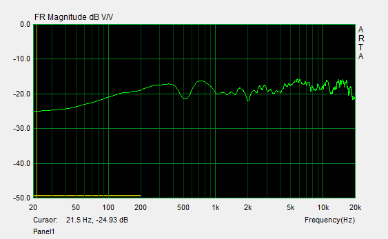

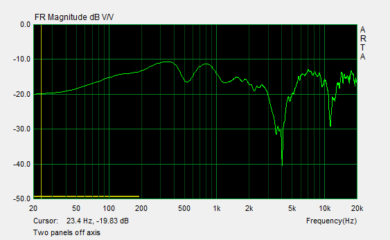

See screenshots of one and two ESL 150x30 cm, with treble segment(s) 2 cm wide.
1) Frequency response of two panels side by side, somewhat off axis
2) Frequency response of a single panel.
In picture 2) I can see no significant interference pattern in the SPL which is extremely obvious in 1).

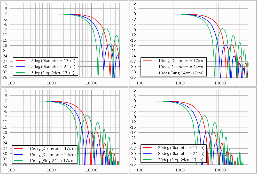

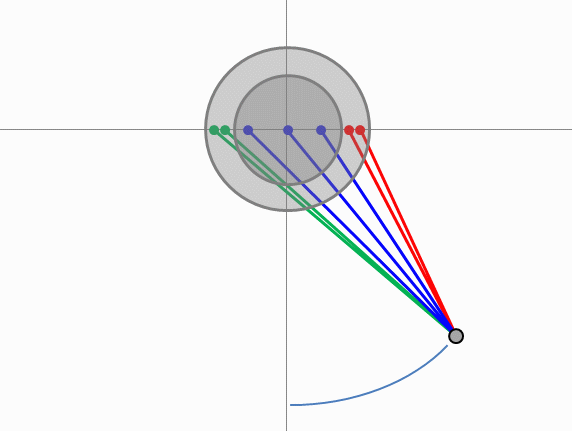

Off axis response deteriorates because of path length difference between different areas of a radiator. The differing path lengths shift the phase of the sound arriving from different areas resulting in cancellation rather than summation. So even if your ring is 3cm wide, there will be a considerable path length difference between areas of the left and right sides of the ring when listening off axis. Note difference in red and green lines in Attachment #1.
As AndrewJ mentioned, the off-axis response for the ring will simply be that for a 24cm piston minus that for a 17cm piston. You can calculate this using the Bessel directivity function for a piston that can be found in any acoustics text, or brute force summation of a large number of point sources distributed around the 3cm ring. The results are the same, and are plotted in Attachment #2 for a couple off axis angles.
Note that the ring has worse off-axis response than even the 24cm piston.
Looking again at Attachment #1, you can see that this makes sense because when you remove the inner 17cm area from the 24cm piston there will now be(on average) larger differences in path length between all areas of the radiator.
