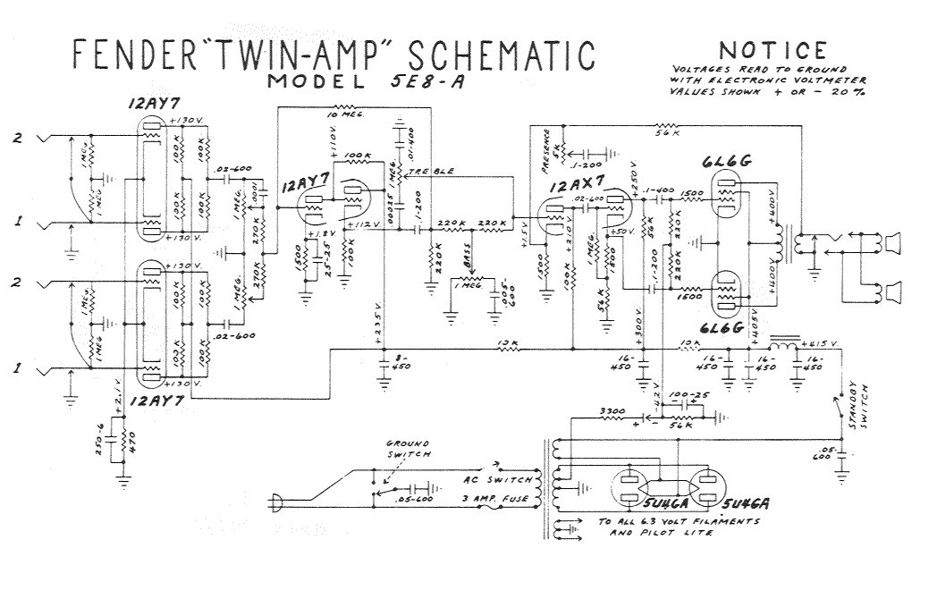

Attached is a Fender Twin Schematic...very typical of Guitar/Bass amp designs, regardless of manufacturer.
I would like to point out since the plate voltage is very high, the secondary is ground referenced for safety and acts as a feedback point as well.
If the event transformer shorts, the plate voltage would see ground and pop the supply fuse.
While I don't compare the two in performance, (distortion and power) the design you posted is not a high-power design....but looks appropriate for HP's.
