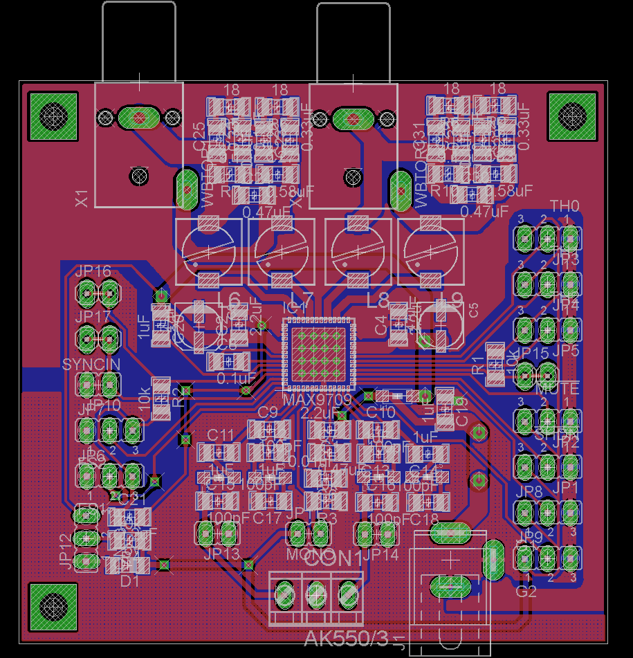

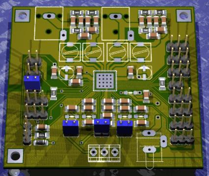

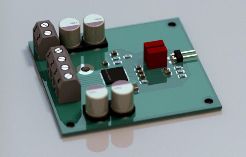

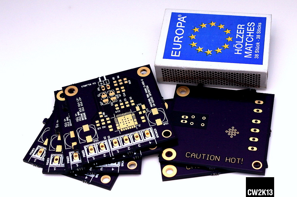

I´m working on the pcb design.

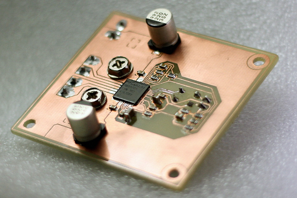

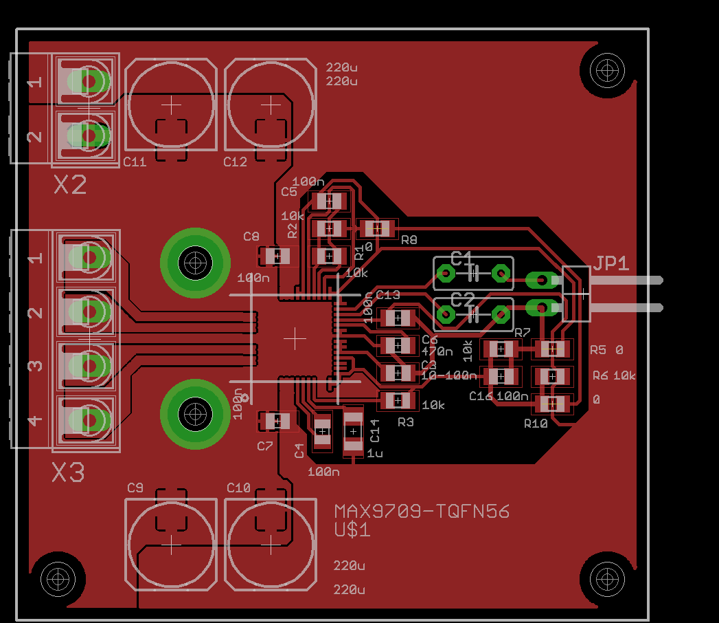

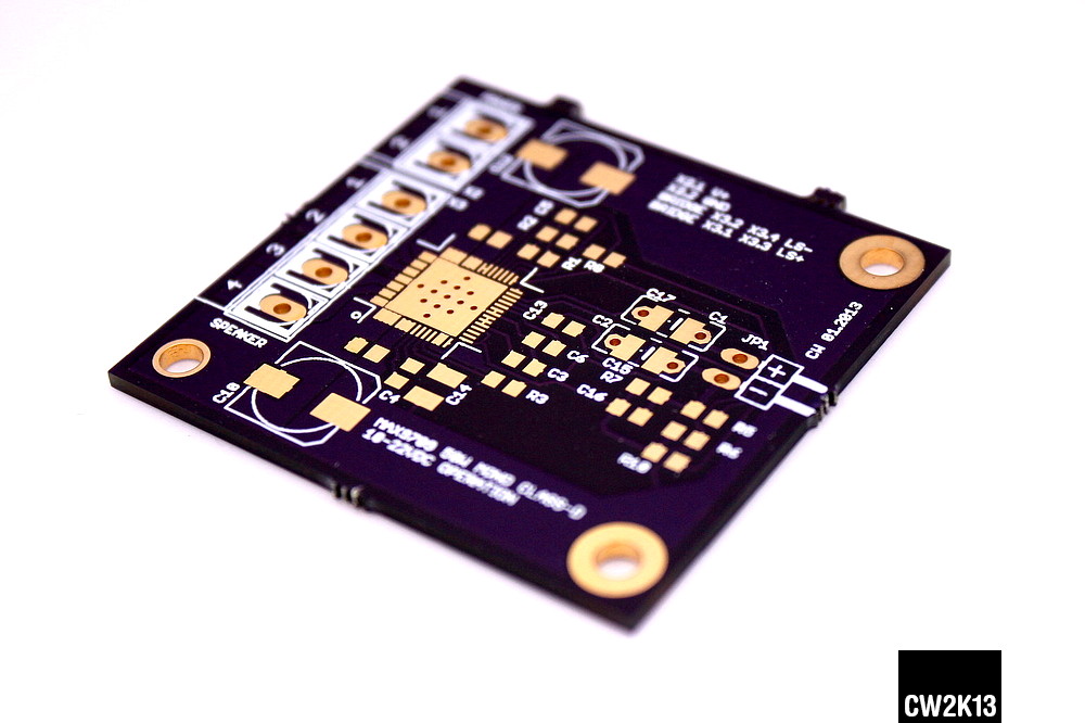

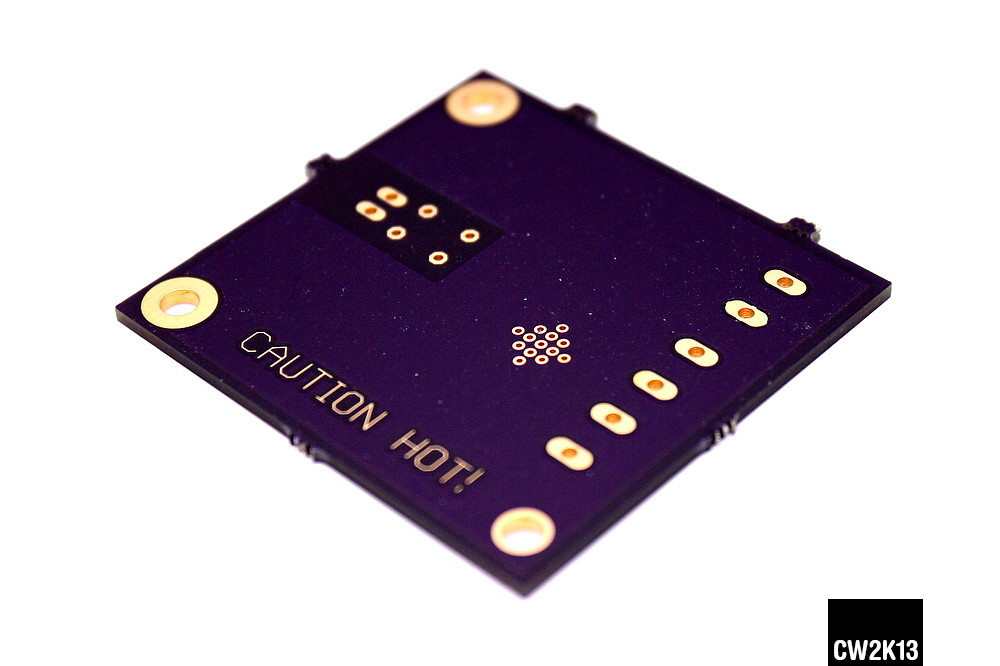

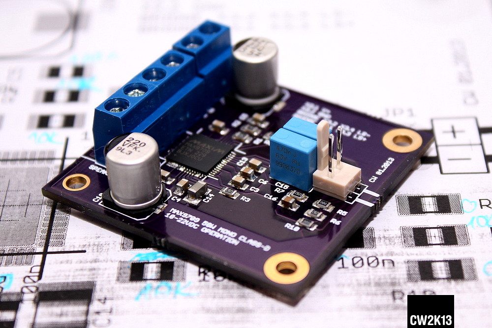

i build myself a 9709 monostage in 1-layer-design. So far temperature is not a problem, but i havent tried a 100%-run on 22V.
Powered by 12V PSU the IC topside will be at ~42°C after 10 minutes of 1kHz square wave input near clipping, so at 12V supply voltage, no additional heatsinking is required.
Strangely the IC is only pulling some 800mA from the PSU at this, so i gues impedance of the speaker is not as low as 4ohms.
Layout is working as is and it is considered to place a heatsink on the bottom side of the pcb.
Working params are:
SSM 200kHz +/-4
Mono bridged (1x50W)
22V max input
36dB gain
120°C temp shutdown via /mute input
filterless output
Cheers doc

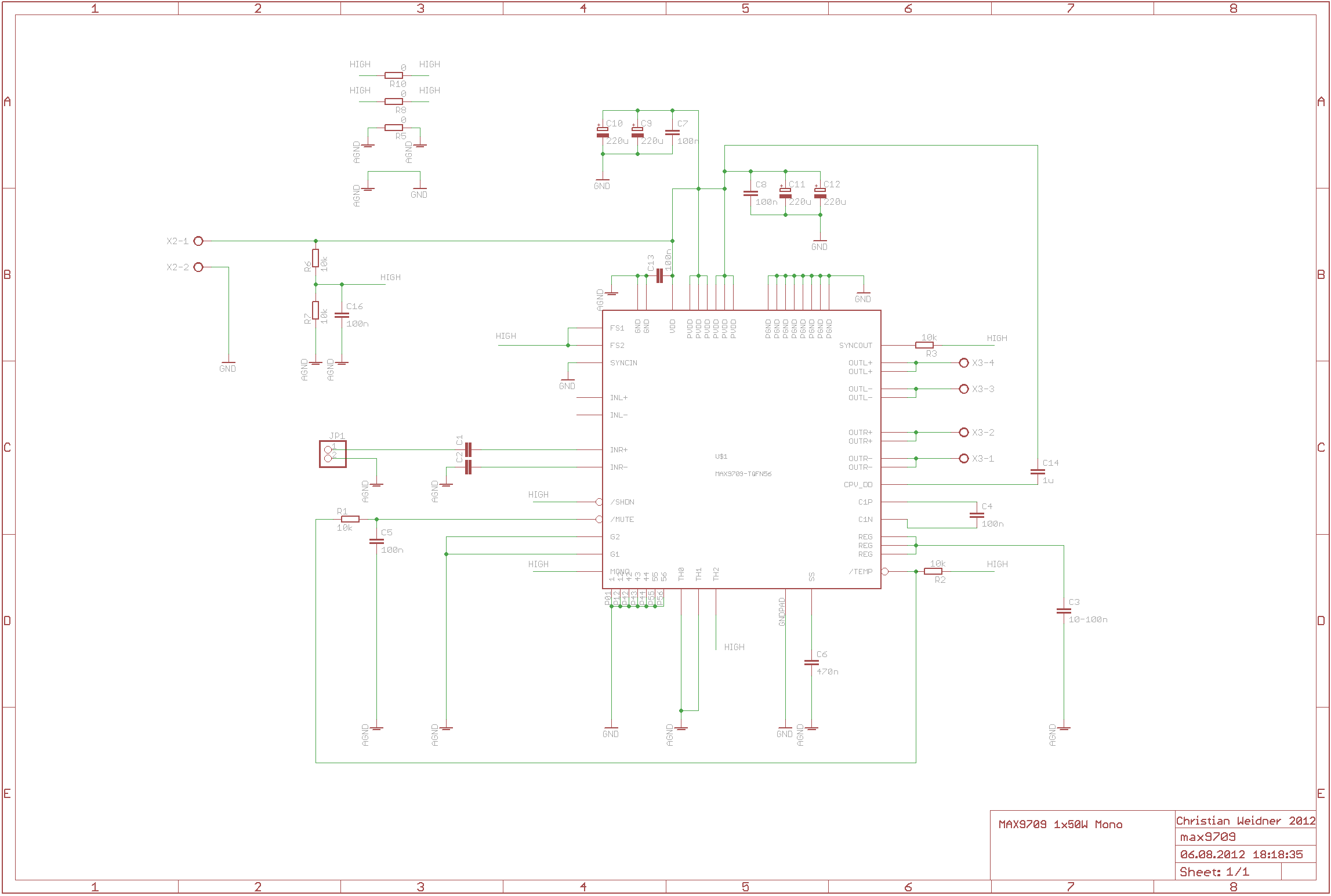

haven't got a notification for your reply, so sorry for the delayed answer.
As you can see, /SHDN and /MUTE are low-active, so, to enable the chip (/SHDN) and unmute it (/MUTE) both needs to be on high-level. Thats why /SHDN is connected to the 10k/10k Divider R6/R7 forming a high-level from VDD.
/MUTE is connected in that way, that the chip gets muted whenever the thermal-protection trips. R1 & C5 is forming a time-constant to filter this signal and mute ringing from the set thermal-trip-point. As from the datasheet you'll see, that /TEMP is open drain and needs to be connected to either REG (internal 6V regulator output) or high-level. So why did i connected this to HIGH rather than REG is, that the REG-output is not active in /SHDN mode and you may get in trouble while power-up-sequence. I had problems with this behavior when using the MAX9704 chip.
In normal operation, /TEMP is internally on high-level and the pin is "open drain output". So /MUTE is somewhat "high" as well. When thermal-protection is kicking in, this pin goes low and mutes the device. When the temp gets down, the chip is unmuted again.
Have a look into the dev-kit datasheet here:
MAX9709EVKIT Evaluation Kit for the MAX9709 - Overview

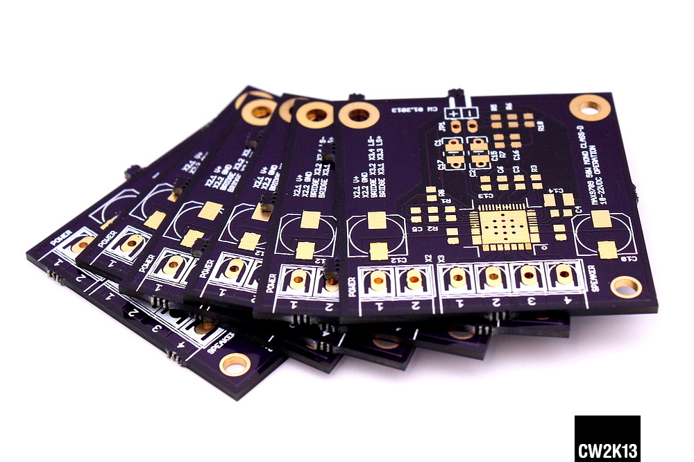

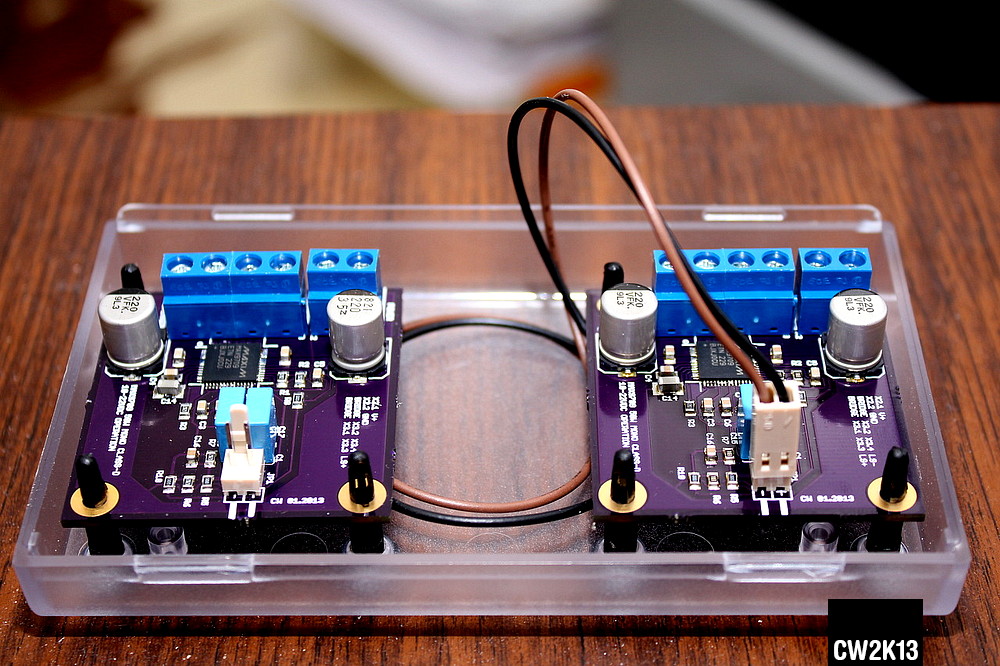

I made some PCBs now running here. :) 2x50W Mono.
