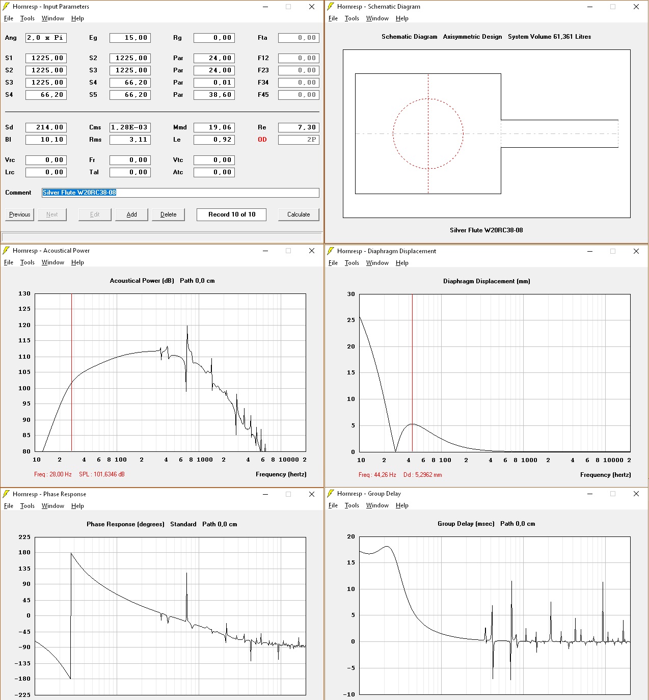

I feel a bit silly for forgetting about the Silver Flute W20RC38-08.
They are perfect for your application. Ends up at 61 liters, but there is fidelity. Not certain I would use anything more than a coil to smoothly transition it over to a good mid, could always just slam a small tweeter/widebander in the middle and call it finished. These will sound much like a sealed box, only with better extension. A bit of dip eq to get the match right, does not use a lot of power, just works.

Interesting but what about the 5mm xmax?
Fs is good but xmax-limited makes me think i will need 2 or 3 per side, am i wrong?

Do note that as my sims are in halfspace (2pi), at the lowest frequencies (28hz) you might get 107db max pending on room modes. This is why I always sim with 2pi, because sometimes the room modes f*** up the response and you get dips and peaks all over, and it's easier to use dip eq than trying to catch up with tons of power.
The port is front firing, and if you place it close to the back wall near the floor, you may get 107db's at 28hz, if you're lucky with the room.
