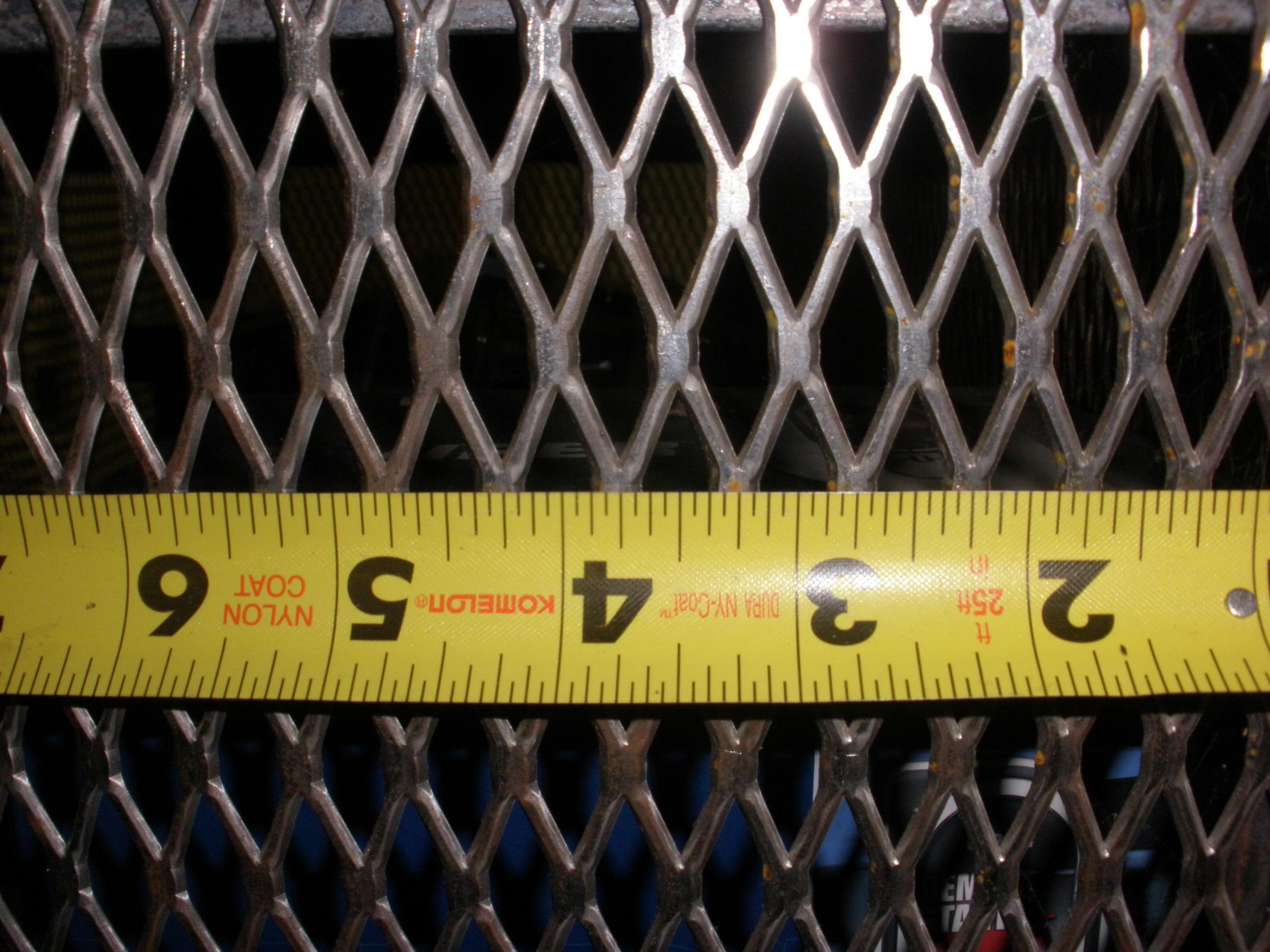

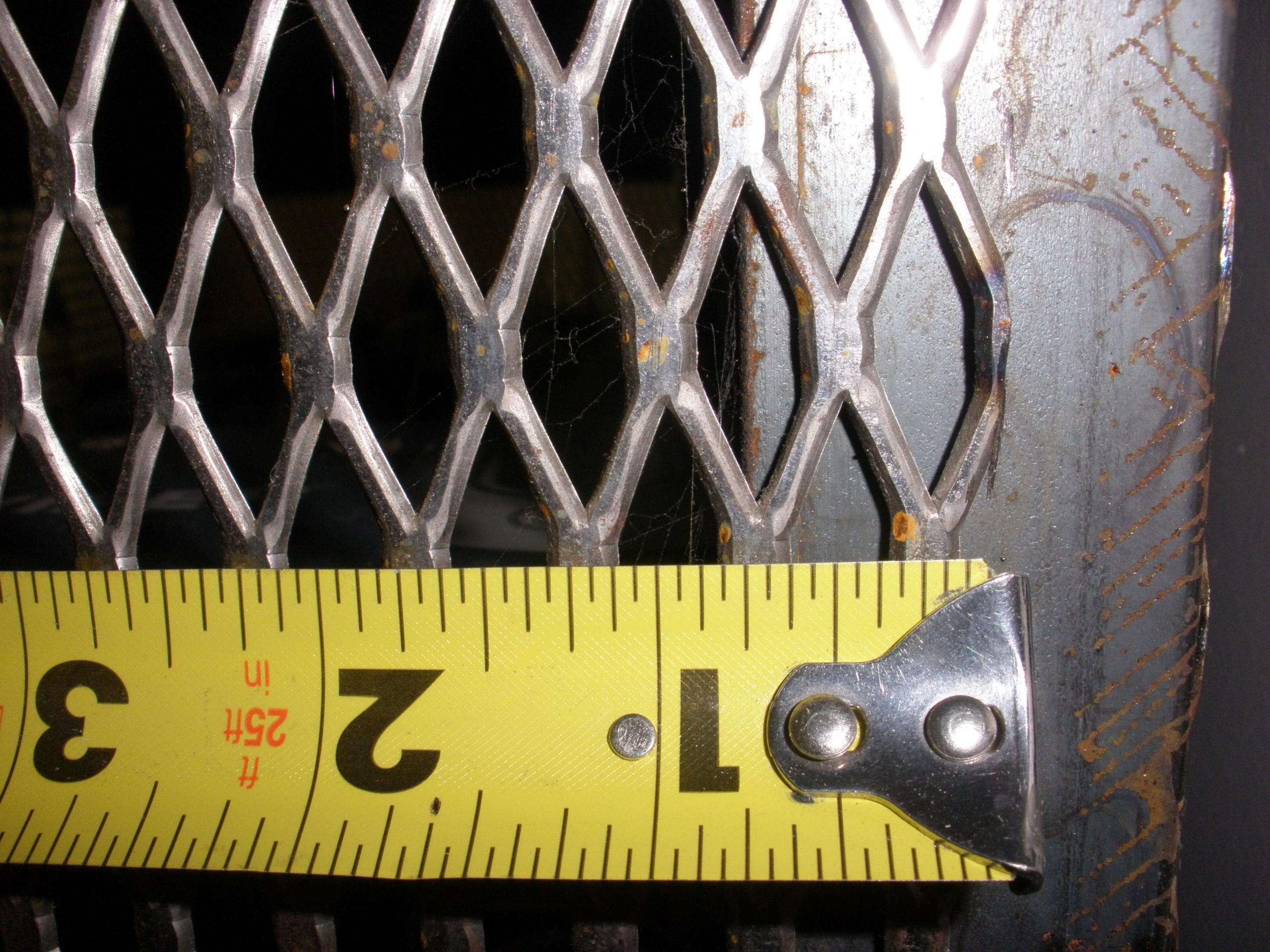

my best description of mine will have the stator eclosure with two steel rods, like a head rest on your seats, so just like you mentioned, i will have multiple mounting distance and if i have to get to them(stator), simply unplug and remove it for service or adjustments. Let me see if i can post a pic of some material and if you or anyone can tell me if it will work as a stator.
i had orginaly thought about using that same material but with smaller holes.i'll have to find my mcmaster carr catalog.i'm sure it would probaly work but might not be very effeciant due to the size of the holes.which is why opted for using window screen.the smaller holes give a more concentrated and uniform static field than the larger ones even though the open area is the same.i wanted to try wire cloth like the kind used for rabbit cages ,but i only could find 1/4" localy and at the time i was strapped for cash but mcmaster carr has some 1/8" and i would still like to try it someday.jer p.s.sorry for taking so long to reply but evry time i try to ,every one i know just has call me at the same time and talk forever!you know what i mean?

thats a stat panel? please ellaborate, i have never seen ones small. By the way nice recording studio! what kind of output in i guess clarity and the other questions

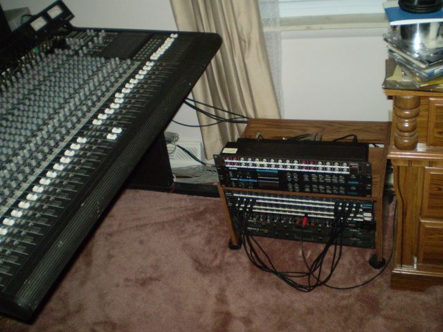

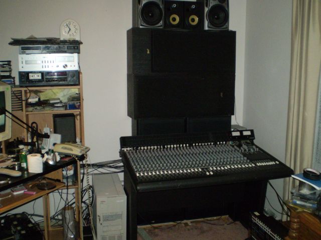

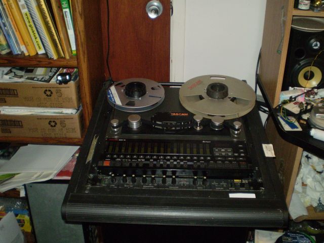

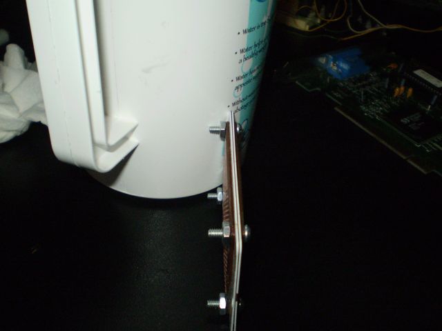

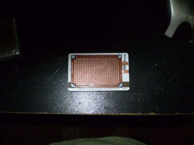

no it's not,i went to take some pics of them earlier today to post,but the batteries in my camera were dead.so i just got home about 30 minutes ago and im taking them shortly.those are for headphones and they worked the frist time i tested them,i used an el34 output transformer with the supply at 475v and about 90v to 100v p-p across the stators ,.0001" (1/10mil)mylar was used,licron as the coating,.032"(32mil)spacing.don't have the proper drive for them yet as i am working on a direct drive amp for them, hoping to scale it up to drive bigger panels.but just holding it against my ear it sounded awesome ,sooooo clean and low low's with absolutly no distortion. even though i couldn't drive them hard it was quite loud enough to enjoy only i wished i had two of them for stereo, as i will soon.at first i thought there wasn't enough high end,mabey the open area is to small,but boosting the treble eq didn't do much either,it could have been because of the recording off of you tube(jimi at woodstock).i've been pretty busy lately i don't even get play with the 16-track it just sits there and looks pretty.sad isn't it,so sad!i thought you'd might like to see it anyway.the next pics are ones that would be perfect for tight spaces and all of them are designed to be taken apart and put back together again.i can't wait to show you.jer p.s. oh man i feel like a little kid again!i'm getting those pics right now, and i will post as soon as i can providing the phone doesn't start ringing again!

I am curious with your headphone stators. It seems like a good idea to use those to make the stators. But in order to make sound, you need to connect all those small holes together. How do you do that?

i didn't.on the other (smooth) side i used aluminium duct tape,then poked and cleaned them all with a round toothpick.then i put some 2" clear tape on the aluminium to protect it and sprayed the other side with easy-off (sodium hydroxide)to disolve ant remianing burs in the holes.rinse with water ,carfully peel off the clear tape.wash and repolish with denatured alcohol .then mask off the conections and spray many coats of clear acrylic enamel then sand (on a glass plate with 600 grit or finer)and coat until smooth and flat.i'll take it apart and do some pics to show you. jer p.s. somtimes when spraying ,some of the holes would plug up so i would just use a toothpick to unplug them(when stil wet ofcorse).it was easy but required alot of patience!
