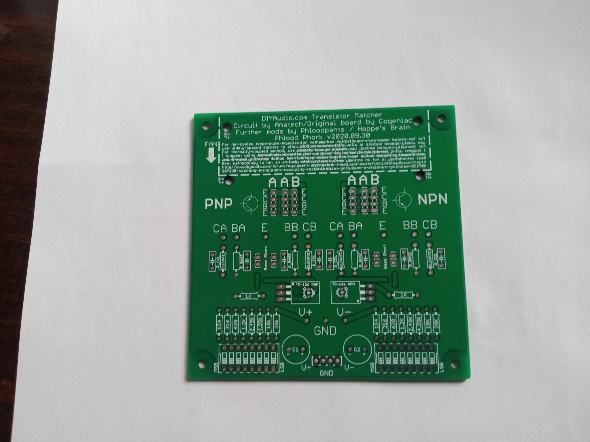

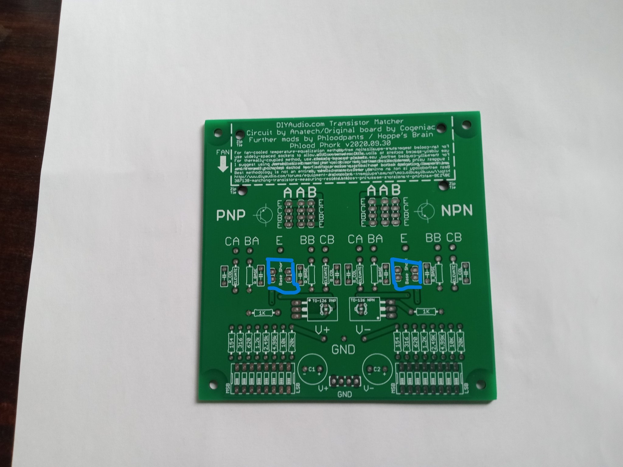

Hello everyone,
I purchased pcb's from Rick Ray (see pic) and I am ready to process my BOM. I would like to ask a few rookie questions:
1. Do the 4 jumpers labeled Base Short need to be populated ?
2. I am planning to leave the capacitors by the 0.1% (100R and 10K) resistors unpopulated. Correct ?
3. Could either of these caps be used for C1 and C2 the bypass caps for the PS: 10uf/250V or 47uf/100V ?
Thank you for the help,
Myles

Hi Chris,
Thanks for the reply.
Concerning #1: On the PNP and the NPN side of the board, what are the 4 holes between the two R_base resistors used for ? I have marked them in blue on the attached pic.
Concerning #3: The ones I quoted are just Nichicon aluminum electro's. I will order up some poly/alum ones. Do you have a recommended brand / part number ?
Myles

I'm afraid I don't know. The PCB I designed was much less complicated, so this is a question for the designer. Basically, the bases go to common through a 10K0 0.1% resistor. Nothing else is connected there.
What is most important for these capacitors is that they fit the PCB and they have good high frequency characteristics. 0.47uF is probably overkill for value in fact. I used polypropylene, but polyester would do fine here too. Most of those are rated for 50 VDC and your supplies are a lot lower than that.
These are bypass capacitors meant to lower high frequency impedance. Your bulk capacitance is in the power supply. If you were using batteries, maybea 10 uF is a good choice, otherwise use something smaller. To be honest, you will be handling this PCB a lot, over many years. Therefore, choose a part that fits tight and low so it doesn't get bent all over the place. Electrically the demands are not great.

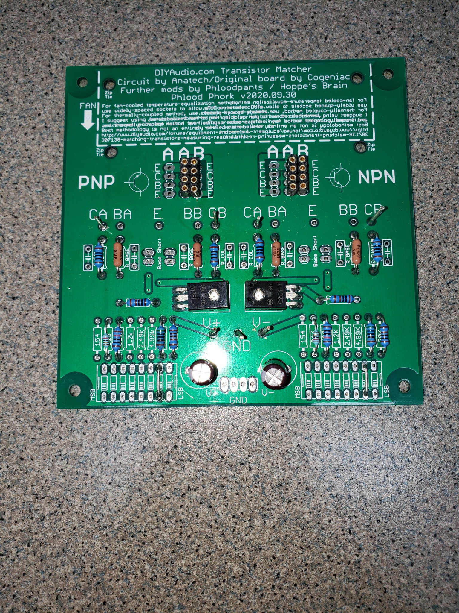

@Kokanee, the board was designed by @Phloodpants I have attached what I populated. I used 10uF electrolytics on my board. The silk screen indicates those are to short the base. I did not use those.
Hi Rick,
Clean build.
I used foam between the PCB and CCS transistors and ran the LED through it. That helps keep the LED and transistor at the same temperature. Also, the LED is supposed to be a normal red, low efficiency type. They normally have a red encapsulation, not clear. The voltage drop is sometimes different and I haven't tested if the tempco is very different or not. A standard efficiency red LED and BJT junction are pretty close for temperature co-efficient, and that is why that particular LED type was used. It varies a bit with current, close enough for this application.
Clean build.
Thanks @anatech, I will see if I have some normal red low efficiency LED's and will implement the foam trick when I change them out. I was very happy with the way the jig matched the transistors for a number of builds. I need to go ahead and get some DIP switches and fill out the resisitors.
Hey Rick,
I wouldn't worry about the other current settings. Popular current settings would be 0.5, 1.0, 1.5 and 2 mA for tail current. 1 mA is very common. Since I design and work on all kinds of products I wanted to make it overly flexible. Quite frankly, I had 8 positions to play with, 4 would more than cover what you normally run into. Plus, you can switch more than one in and come up with other currents. They do not have to be exact.
The only downside to matching is the wait for the parts to settle. Otherwise you can get extremely close matches with this jig. I'm very happy you find it useful!
-Chris
