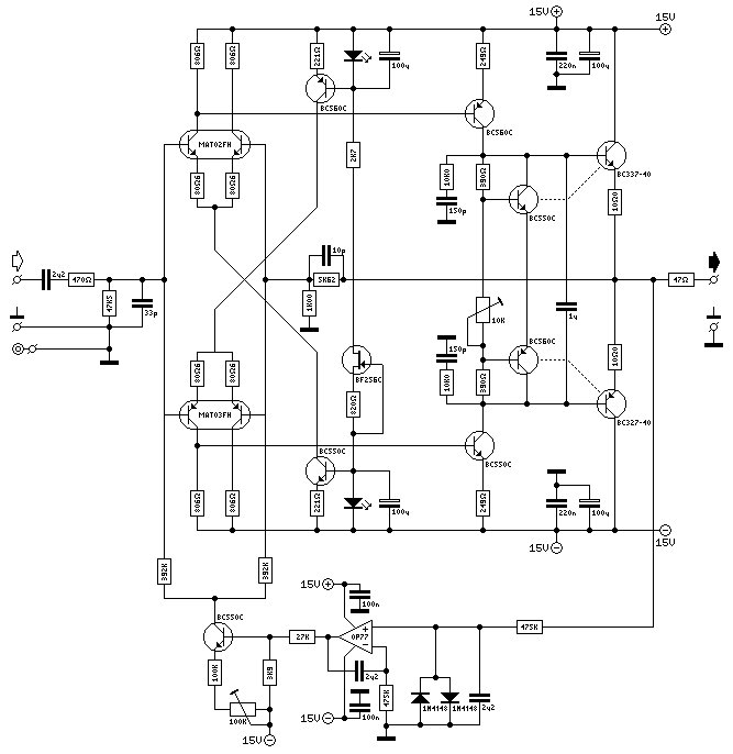

MAT 02/03 amplifier schmetic needed
Good for you, Elso. You might actually find more 3rd harmonic generated with the fet input, BUT it is a CLEAN 3rd, just like analog magnetic tape. The advantage of jfets is that they STAY QUIET over a range of source impedances, including both resistive and inductive. They don't require much input bias current either, SO you can leave out the input coupling cap. This is important! You can also use, with ease, MUCH more idle current on your input stage. This makes driving a comp cap easy, and potentially increases your slew rate. There is much more, but enough for now.
