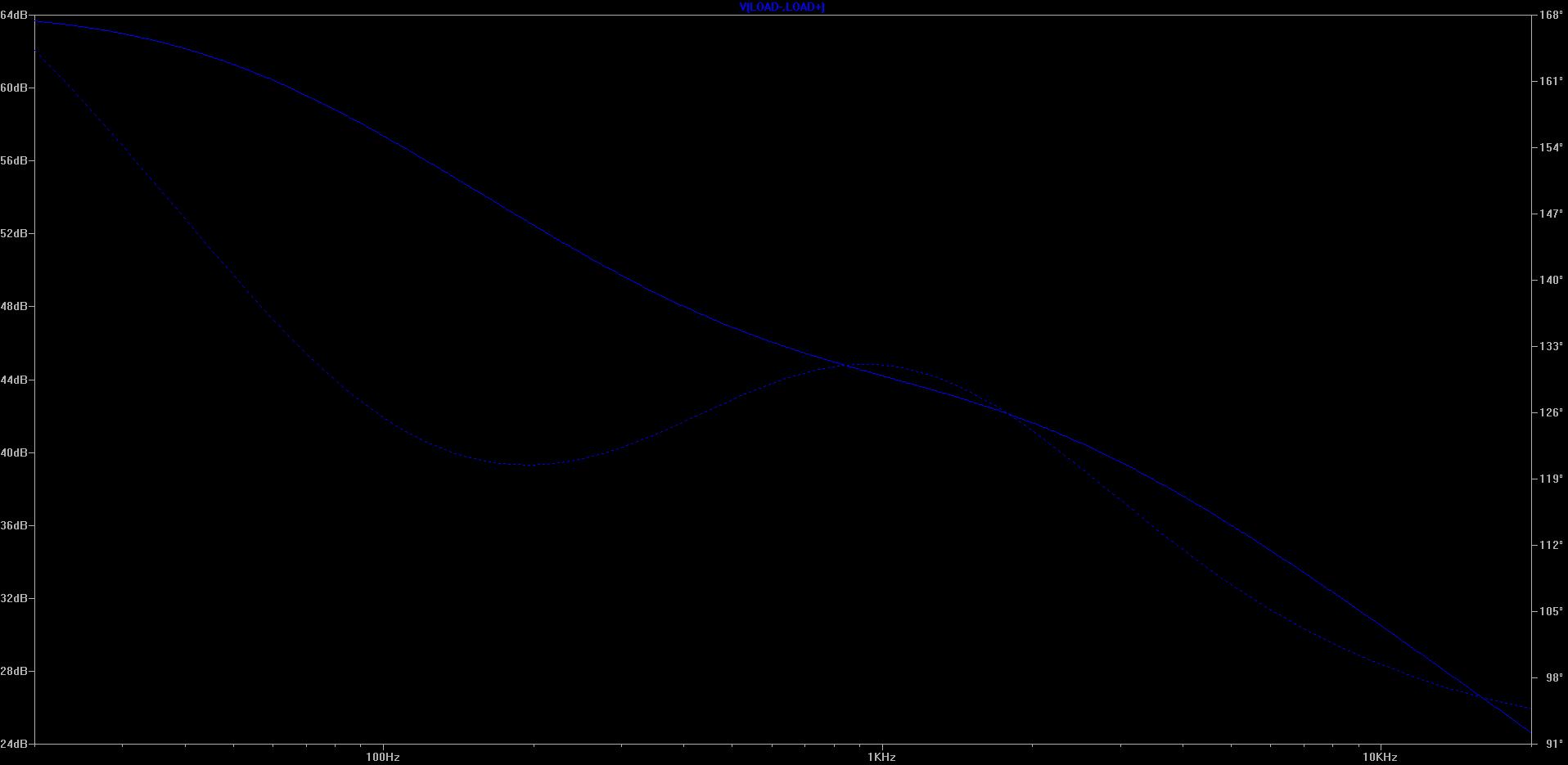

Is this what you have in mind?
Frequency response with Filter attached.
I can protoype it with this values and take measurements and post in here the results. If thad is what you were thinking, do you want me to measure it without the filter fitted and only the gain setting resistance on the TransZ or with filter in it?
Would this help development or you still feel we need to make adjustments to it or this is a good starting point?
If the schematic is not what you had in mind please let me know...

Stefano, the noise goes from gate to source and then though the 100 Ohm to ground. Assuming that R1, R26 are parallel AC wise you end up with 1nV/qHz only from this resistors. It is an improvement over R1 but still not very impressive. You should at least shoot for 0.5nV/qHz, that is 6dB better. My best stages are around 0.3nV/qHz so even 4.5dB better then 0.5nV/qHz.
For some reason it looks like I can't make them any lower on simulation or the gain will just drop.
I usually set that resistor down to 10ohm or less..however for some reason it looks like I can't do that here.
Any clue? Maybe if I lower the resistor that sets the gain on the trans Z network I can re-establish proper gain. However if I change that value I will likely have to re-design the RIAA 's circuit which it would be ok anyway.
I will work on it and post later tonight!

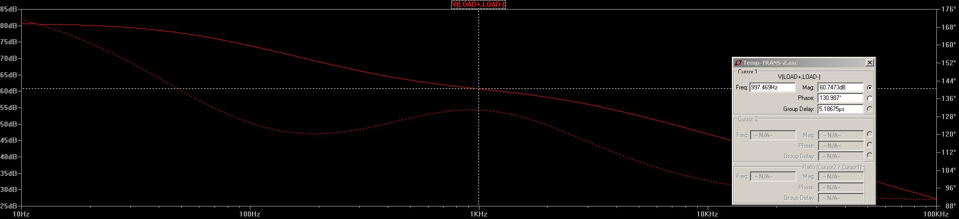

this is the latest scheatic for MasterPiece.
I had to re-arange the Servo into 2 separate ones and at taht point I was able to lower the Feedback resistors down to a very low noise approach and boost up the gain and reach 61dB with the single stage.
It looks like we could possibly get rid of the bootstrap caps using the arrangement shown here (please feel free to comment on pro and cons if there are any).
I am still not sure how it works in SE as it looks like the gain would drop down by 6dB on the Bal version in SE mode and how this can be re-arranged on the SE Paradise as the common mode resistors allows to set an AC path between the two halves boosting up the gain (also corrects a little bit asymmetries of the two parts thus lowering ditortion).
What do you think about this schematic? Is this what you had in mind?
As you can notice I have also halved the number of paralled Jfets which would increase gain another few dB eventually, but I think there could be sonical benefit by keeping this number down to the minimum required.
