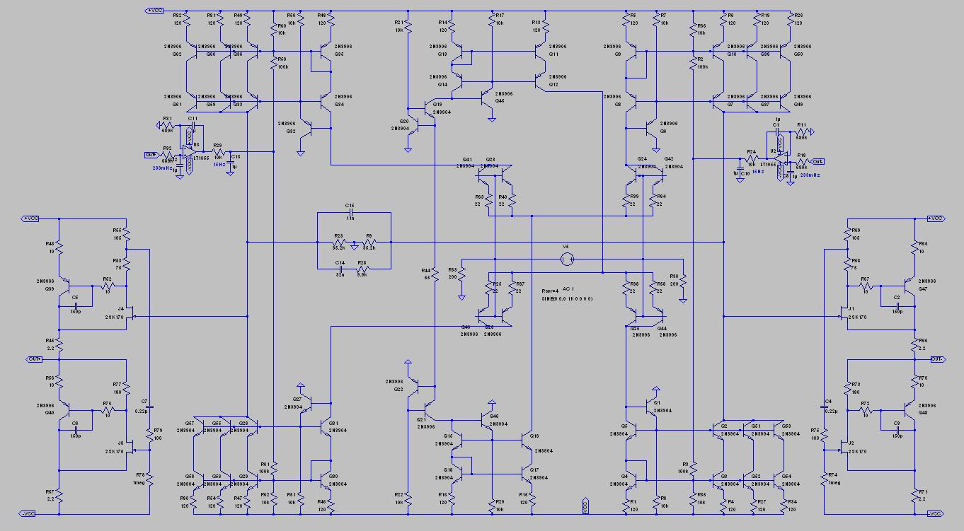

Yes, more current gives better drive but also more gain so you have to change the values of the RIAA components.
If it is not a topology problem i have no clue. Maybe the single RIAA simply does not work and we need two.
The Paradise runs on 10mA in the input and there is ample overload margin.
Does your simulation show that clipping behavior ?
No, simulation doesn't show any clipping.
However IMHO 10mA might not be enough to have good high frequency margine.
It is a matter to establish during design specification what is the max frequency you want to be able to bring the output at clipping at.
If we set a full swing at 25KHz for example I suspect that more than 10mA will be required.

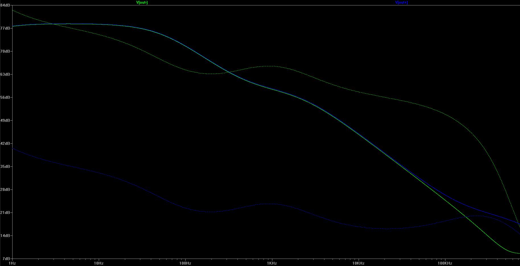

Anyway, simulating more, circled out what the problem is with the mismatching of the two sides.
On the bench I was noticing that mismatching of the two halves gets bigger and bigger as frequency increses and I couldn't explain why.
Here is circuit simulated using devices on the left side with different Hfe and shows exactly the behaviour I am seeing in real life (I thought it was pretty cool).
The conclusion is that tight matching for this topology is a MUST!
Here is the simulation shot.

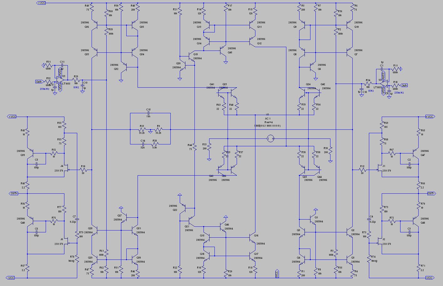

Here is the updated circuit using Celvin's buffer (however I haven't tried it yet I am going to do a shot out of output stage on this next prototype I am going to run).
I also added the option of doubling up the input devices don't think it is necessary per se, but current going through the device (about 8mA) is a little high to handle for the input device chosen and also linearity goes a bit down too.
I agrre scaling the mirror is not good. I did a power amp where I did scaling,(input to VAS) it did not do me any good, then i changed the mirror and had three parallel devices in the out-side then problems was gone.... maybe that will be the solution here also..I don't believe that it is a question of mismatch, more that your mirror transistors at not working at the same point on the curve.
You removed the cascode in the buffer..??
I thought of that, just didn't think it could actually create a problem on the mirror side riscaling it.
Let me rework the schematic to work about 30-35mA
