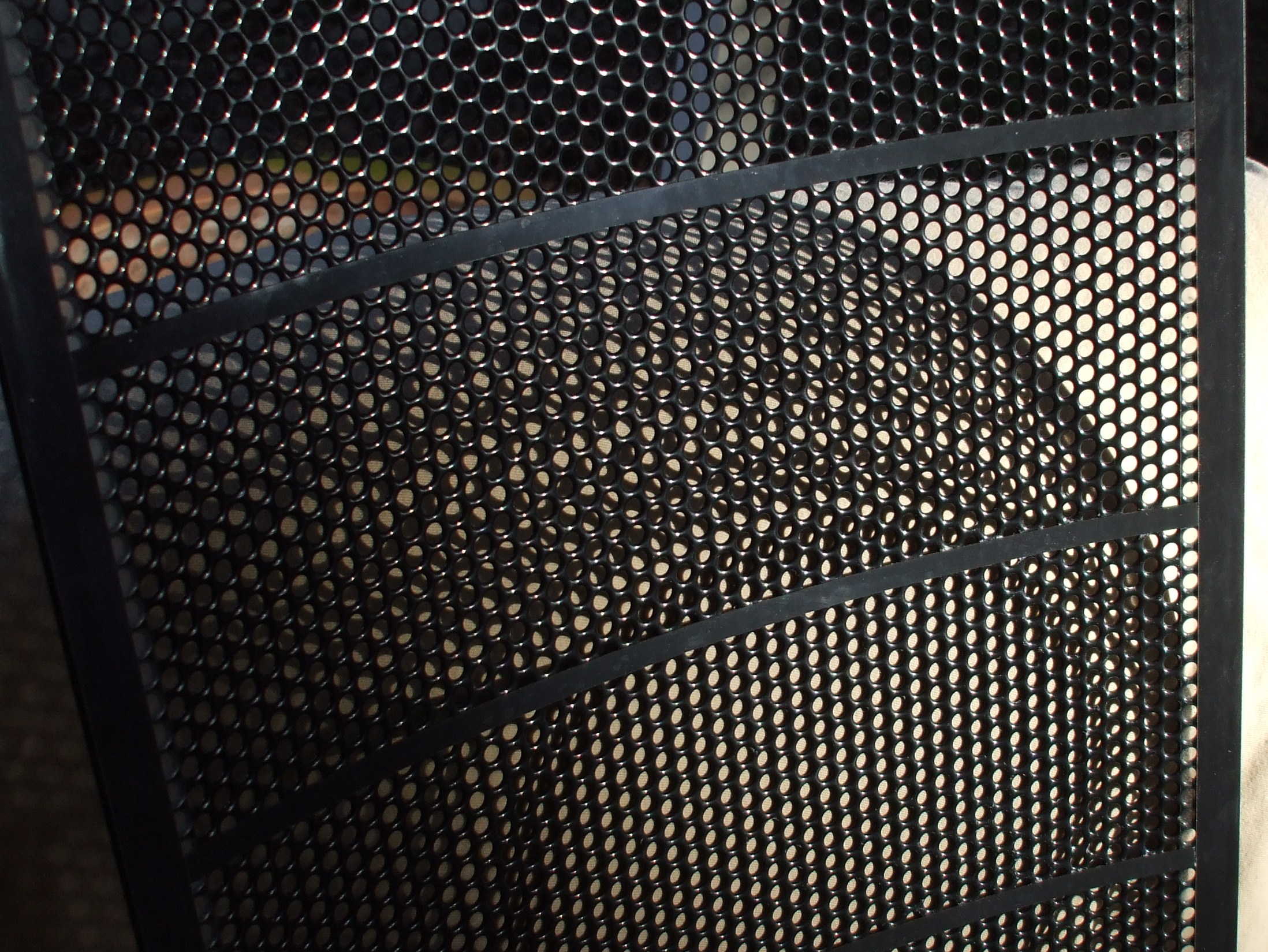

We have In the panels befor this time like the SL3 an others, the rubber in the spacer is thicker an softer....from 2000 on the {Lexan} is a harder rubber type.....About half as thick....one thing took a min. to get the panel pulled a part.....with No nicks in the mylar...the older panels were hard to get a part....an most of the time you would get a rip in the mylar... but most of the time you had nothing to lose....the older would lose it coting...so you had it put on High V coting to get them to work agin... sope work good grafit.. here is pix of the new panel spacer...Now with the new Mylar... it so thin if you put any coting on it you lose SPL...output drop off fast...i DONT think You can Recote..the new panles i have after a good wash an cleaning work great like new...no loss of coting after 11years....But the older panels can sound great an be recoted over an over....an the MIDs sound a littel sweeter..softer rubber....I need more time with the newer panels.
The info is from Stereophile v24n7.... vary cool maylar the highs are better than the older panes an you get more output from smaller gap.This info is for the diy in use...

...i DONT think You can Recote..the new panles i have after a good wash an cleaning work great like new....
Well i thought i would get hit on the
...Cant Recote.....you CAN recote any ESL Mylar!...
Now you can an must Wash any ESL....make big Diff, get rit of Dust....
