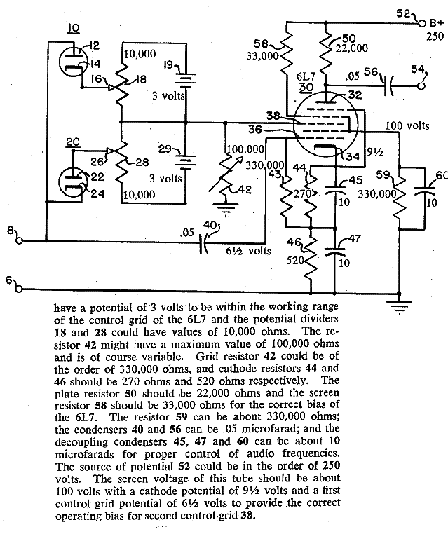

Patent shows 6L7, pentagrid; not 6L6 power tube.
I'd call it 2 quadrant. (4-Q allows inversion which we do not need.)
I can't see how it is more than an elaborate diode-limiter. Yes, it shifts the gain-control function onto an amplifier tube, but without any time-constants it is equivalent to a clipper.
I have real doubt that there is an optimum point for G3 where deviation *either* way reduces gain even approximately equally. That might be the first point to check. When G3 goes low it cuts-off plate current. Maybe when G3 goes high it steals current from plate. I can't see the two effects being equal? And that is not what I am seeing on 6L7 data, for the bias points cited in the patent.

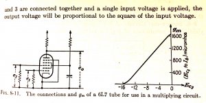

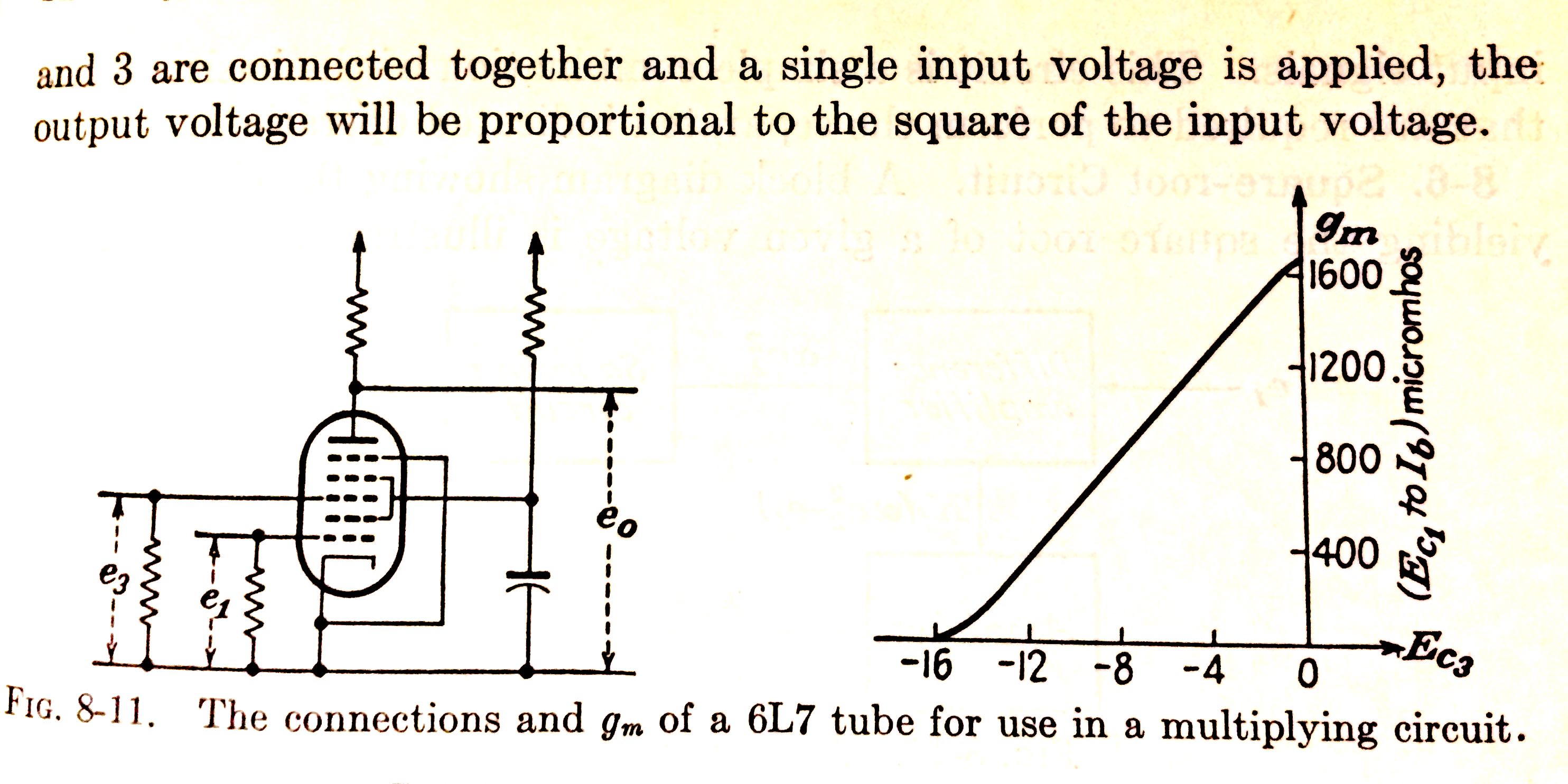

Yes 6L7 typo, here is a paragraph from Seely. G3 is under control for 360 degrees. There is no knee on the 6AL5 like semi's, the diodes are biased on, so no hard clip point. G3 control is quite linear as seen in pic.
No time constant = real-time which is interesting vs integrator

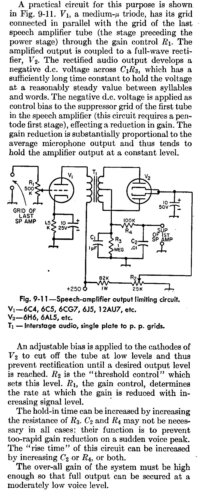

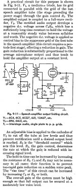

Here is the 1961 ARRL side-chain rectifier and connection points, its worth a try. It has an integrator but was for an issue on transmitters. The diagram here does not show external tube with suppressor etc. Also I'm modifying it quite a bit and may test on the Birkemier ef86 compressor. Keeping phase correct will be important now. I do not think it will thump, but if it does there is a solution.
T1 is one of the missing components in Martin patent. I have some EDCORs to use. Also ordered a few 6BA6 , probably use 6SN7 for input follower and output buffer.
