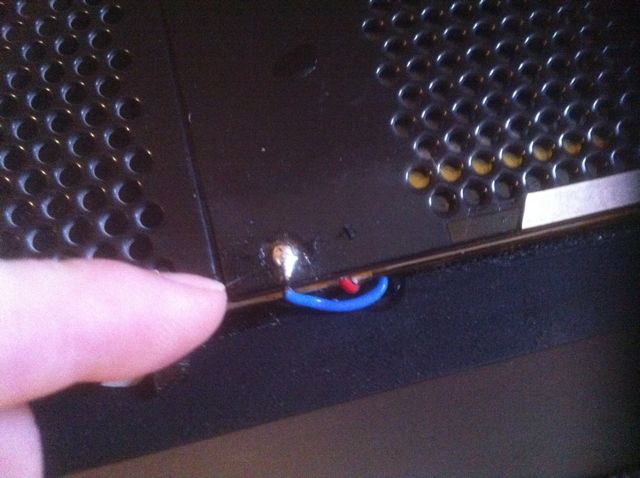

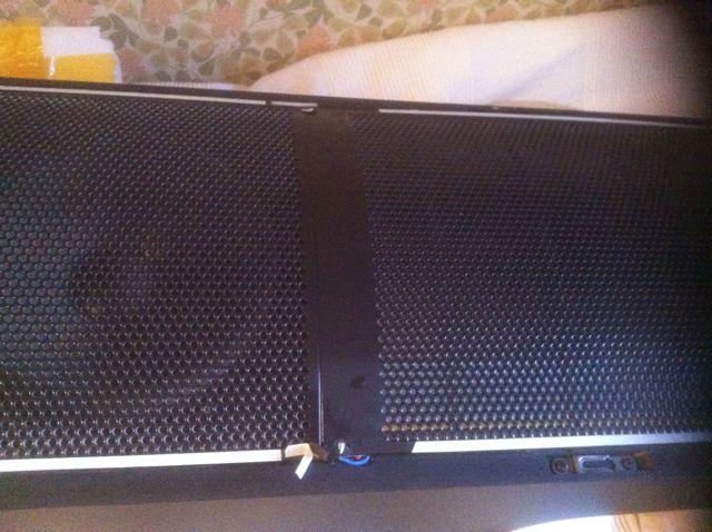

Yes, you should. Perhaps add some thin weather stripping to the original weather stripping behind the panel to increase the clamping pressure.
And with these old ML's you should thoroghly inspect every single screw hole in the MDF cabinet for stipped out holes and repair as needed. Like the ones holding the PCB and the ones holding the panel clamping hardware.
Here's an unexpected find. In it's more expensive speakers Martin Logan uses film capacitors in it's HV voltage doubler bias supply circuits. In it's cheaper speakers ML uses HV ceramic capacitors in the HV voltage doubler circuits. All of the other electrostatics I've owned Dayton Wright, Acoustat, and Quad all used ceramic caps in their HV doubler bias supply circuits. It takes more voltage steps using more caps and diodes to use the lower voltage film caps and costs more. Given the cheaper grade parts like Jamicon's 85 C electrolytics that ML use in the internal electronics why do they go to the expense of a greater number of HV steps with film caps instead of few steps using higher voltage ceramic caps like everyone else, even ML themselves in their cheaper range? Is this one of the ways ML achieve better sound in their more expensive range besides using larger, better step up audio transformers and higher quality crossover caps (although even better caps help)?
So I replaced the unidentified 1000pf and 3300 PF 2 KV white film caps (metalized Mylar?) in the CLX bias supply with Wima 2 kv MKP film and foil polypropylene - when I first turned them on they were coarse and grainy for the first 15 to 30 minutes and now after 4 or 5 listening sessions with a variety of low and hi definition source material I find them to be even more resolving, detailed, and smoother sounding - just the same effect as upgrading coupling or crossover caps, but this time it's the HV caps. It's not expensive to use the Wimas and I look forward to see if anyone else tries this on CLS, Requests, or any of the other ML speakers using film or ceramic HV bias supply step up caps and reports on their results or questions my hearing or sanity .
